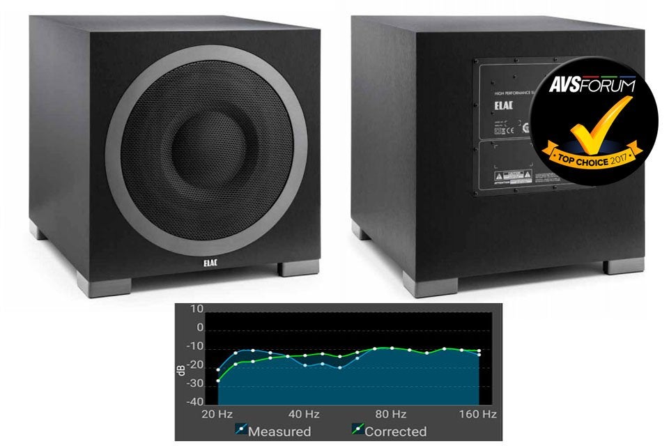

I couldn't immediately find any reviews with measurements on the Elac Sub3030, but Elac is the only other one I know of that has an app. They are 12" with a passive radiator. Two would be about $1300 shipped from Amazon right now. They are not very popular on this site, and I as I said I haven't seen measurements, so they might be a risk.
@XEagleDriver ,
Here is a review of the previous model by Mark Henninger. They seem fundamentally the same - 12" driver with 12" down-firing PR and AutoEQ system. I am by no means up to speed on these, but one thing I do know is that the 3030 AutoEQ app has been revised to better integrate dual subs, whereas before, you had to treat them as separate installs on the app. I don't know if this impacts SQ or simply makes it easier for the user with dual subs.
If you are not aware, I thought I'd point out that Marantz/Denon now have an app out for Audyssey XT32 which allows you to select the frequencies you want to EQ and afterwards you can tweak the response to get your house curve. Many people don't necessarily like what Audyssey does, but it seems most are very satisfied with how it handles the low bass and room modes.
I mention this because this (along with the AVR remote) may give you the features you are looking for from a phone app and open up your sub options. Of course unless you already have a recent model D&M AVR, it would require replacing that.
Using KEW provided review of previous, but similar model, a concern was peeked by this quote:
"However, in terms of raw output and low-frequency extension, it does not dig as deep as three similarly priced subs I have reviewed: The SVS PB-2000, SVS PC-2000 . . ."
Design appears to be a hybrid between sealed and ported, not a bad thing, but if above still applies to 3030 it may not dig deep enough.
Sent from my SM-G975U using Tapatalk
KEW
KEW
I think that is fair and I would suspect that the 3030 is similar on that count!
Just to share everything I know of, that may be useful, below is a link to spreadsheet of CEA2010 measurements (at 1 m, so subtract, I think, 9 dB to get 2m result if comparing) by Brent Butterworth of the 3010 (10" version of 3030), but no, if you are looking for the lowest useful output the Elac is not going to get the job done!
Do the SVS models have an autoEQ system, or will you do it manually? How do you address EQ on your NSD?
The Elac is, IMHO, only really competitive if you are looking distinctly for:
1) AutoEQ
2) Compact size for output (advantage of PR over port, but my understanding is port ultimately gives more output)
Otherwise, it looks like SVS is the only option that will fit your objectives!

The SVS does not have an Auto system, but has 3 bands of parametric eq I believe.
Another knock on the elac, is that it’s only controllable via app. I’d be concerned about long term support. At least the SVS has a control panel.
