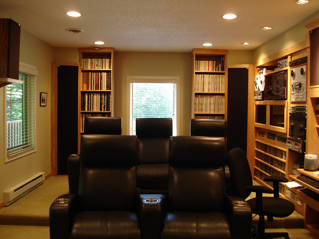

So the front stage now looks like this.
These are the surrounds and rears.
These are the speakers now used as surrounds, and are the only speakers not TLs. They are sealed.
These are the rears with the two TL lines biamped with x-over at 180 Hz.
Bob Carver heard those when he was in town helping a colleague with this Carver ribbon speakers. I was in Grand Forks ND then. Bob stayed all afternoon. Those speakers started in 1979 were very difficult to get right. There was extensive revision in 1984 and over 10 years as modelling improved. I started with floppy discs on and Apple IIe! I had a lot of generous help from the good folks at Dynaudio also for which I am very grateful.
With transfer from Grand Forks to Benedict the bass line was rebuilt to take advantage of George Auspurger's work.
Many musicians and composers heard their works in editing on those speakers over the years.
I think it is a valid system for evaluating multi channel reproduction. The whole system is driven by seven dual channel Quad 909 amplifiers.
