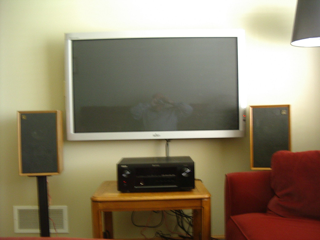

The 3.1 system at our Twin Cities town home.
2.0 system at that residence.
Just one 4" driver in those speakers. The depth of the bass is astonishing in that space.
