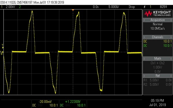

A UPS without pure sine wave isn't taking you off-grid and it can be worse than being on the grid. UPS are made to allow proper shutdown of computers and devices that need to be shut down in a specific way, rather than just killing the power or for devices used for security when cutting the power leaves someone or something vulnerable by ending the operation of the device(s). A battery bank with an inverter allows continuous operation without connection to the grid- they're used in boats to operate anything that operates on DC when the engine(s), shore power, solar power or generator aren't providing energy. Big difference in reserve time and purity of signal when the good ones are used- nav equipment is sensitive to bad power, too.
What do you mean by the bold part of your post? What frequency changes- the AC power? Not gonna happen because of a power cord. Think about this- you have miles of wire between your system and the power source and many feet between the outlet and the breaker panel, where the outlets and anything connected to them make their actual connection to the grid. How will a power cord make a big difference, unless the first one is defective or inferior in the sense that it can't support the current needed?
Both are pure sine wave
