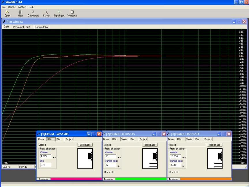

Buckeyefan 1 said:
Can you post a better (larger) copy of that graph? Looks a little "too" flat. ;)

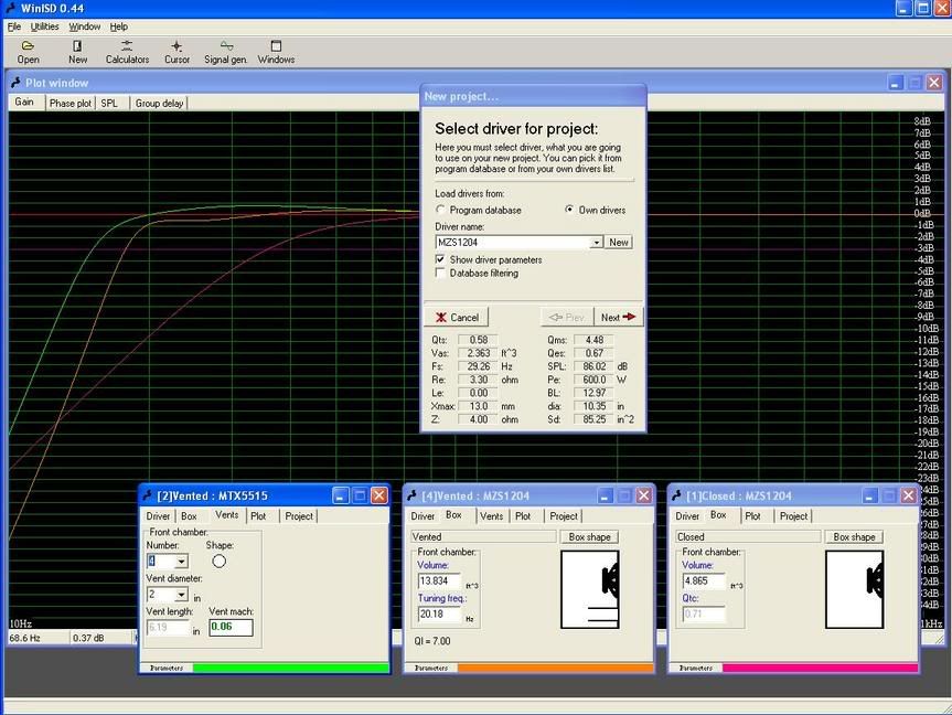

I would really recomend not using a car subwoofer on a home audio system. Car subs are generally designed for smaller enclosures so in a home they are tuned differently and sound boomy. If your using it primarly for music then it might be alright however if your wanting a good sub for movies a car sub would not be the answer. Home audio subs are also designed to have more extension then car subs, for instance when my friends equitment was over here we tested my sub going down to 19hz flat, where as those mxt subs are only rated at 29hz. Heres a good thread discussion on this issue. http://www.avsforum.com/avs-vb/showthread.php?t=613768&highlight=car+sub
Im also curious on how a sub that is rated at 29hz goes down to 16hz in a larger space then it was designed for. I think you did it wrong because I used two 12" Kappa Perfects in my winISD and they only go down to 24hz at -3db, and the Kappa Perfects are better then those mxt drivers
Can you please define extention? Are you speaking of the FS, xmax or driver performance on the whole? Car audio drivers sound boomy? It would seem to me that you haven't built many loudspeakers, and you are making statements from bad literature, not from experience.
marrypoppins
Audioholic Intern
Loudspeakers, no your right I havent built many loudspeakers, however since were talking about subwoofers then the answer is yes I have built several. One of them using using a Infinity Kappa perfect and I speak from experience in that it is much more difficult to make it reach the low hz and hit as clean as subs intended for home audio. Now, I was simply trying to point out that your probobly entered your information in wrong on winISD since your two MXTsubs that are rated at 29hz are going down to 16hz. Instead of getting offended next time why don't you take a breath and think before you say something else that makes me and my freinds make fun of you for taking home audio WAY WAY too seriously.
jaxvon
jaxvon
I think a big part of the lack of extension in car audio drivers is the severe limit on enclosure volume. You can do a lot with a driver's extension by increasing the size of the enclosure.
That is absolutely correct Jax.
So, I entered the data wrong in win ISD, then I built the cabinet wrong in my shop, then I must have measured it wrong, and finally I must be deaf? Ok. I would be happy to e-mail you the WinISD file if you wish.
You obviously don't know much physics. I do take audio pretty seriously, when you have spent as much time and money as I have, it tends to get a little serious. So go ahead and make fun of me, you’re the one with such a manly screen name.
