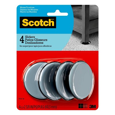

If moving your sub around is difficult (especially if on carpet), these are handy and make it easy to slide:
