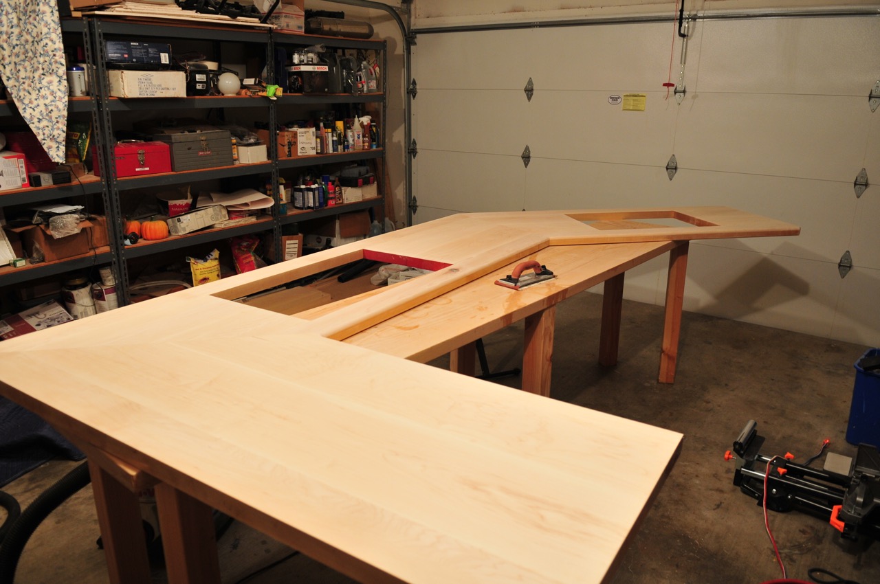

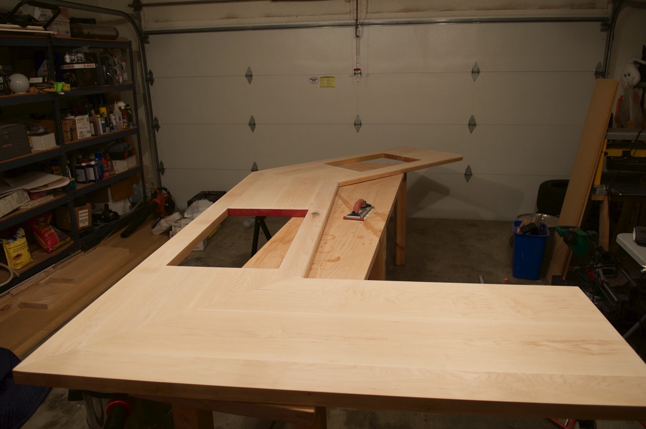

I got that EZ. Just finished building and installing this thing:
I started with rough-sawn (Not surfaced!) hard maple. I'm not worried about cabinet construction at all. Just amp/speaker selection.
The workbench it's sitting on I also made and is American Beech. If hardness/density is desired, I could make the whole thing out of Oak I guess.

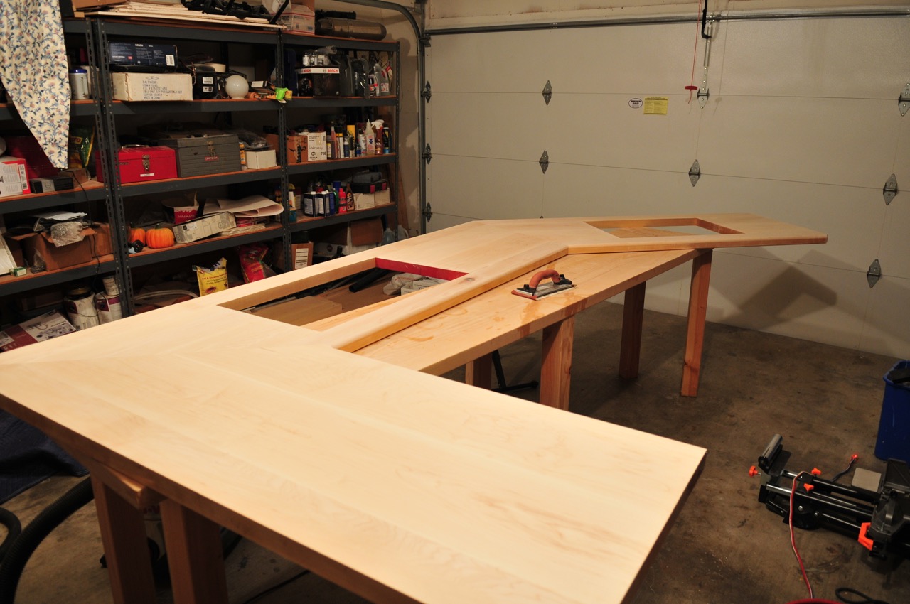

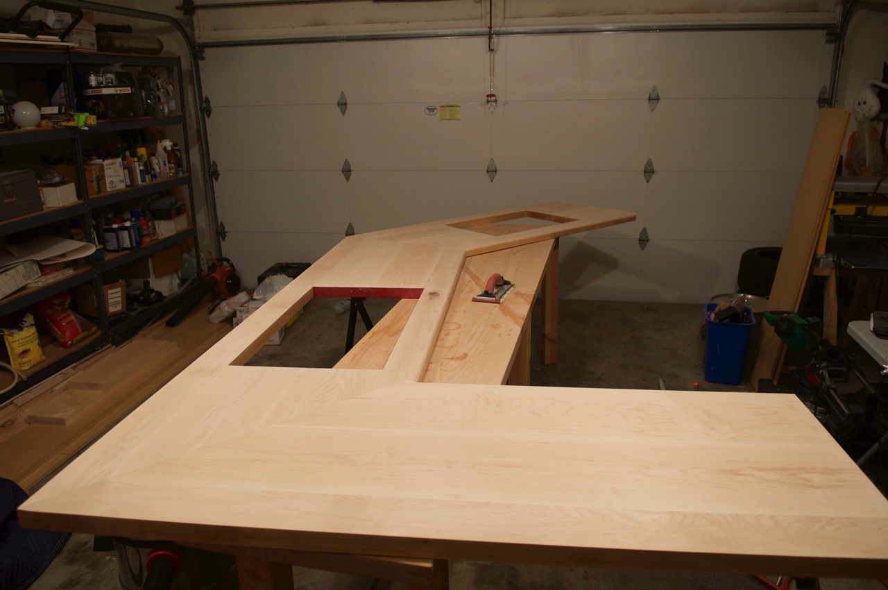

Again... Not questioning your skill, rather raising awareness of the rigors of building a functioning Speaker.
It's not about hardness per se.
The natural damping ability of Maple could be a good thing.
However, the cabinet MUST be tight. It cannot have an air leak, anywhere, for it to behave properly.
Since wood naturally expands and contracts with weather (temp and humidity), you have to find a way to allow for that while maintaining an integral "airtight" structure. ;)
