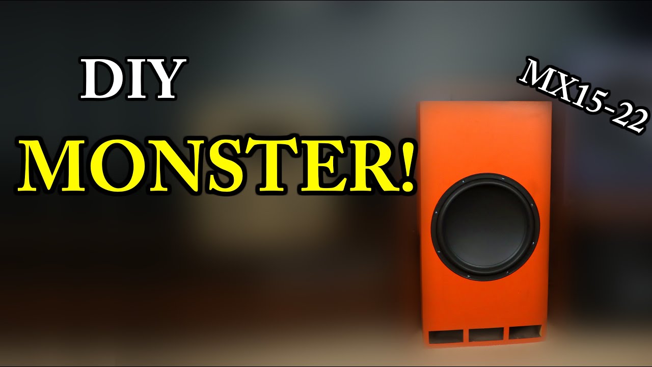

I'm quite partial to this design, the looks, not the entire build, (seen in the thumbnail/preview), with the ports on the bottom.

The DIY Marty builds can be very fulfilling, too. There is a very long thread over on AVS dedicated to the Marty Sub Concept. Your video is making me think of the Marty Subs.
Again, this all comes down to your values and what you want to achieve. Along with that... How much you are willing to spend to achieve it.
MDF out here on the West Coast is over $50 a sheet for 3/4" stock.
Sonotubes become an alluring option because of the cost and weight.
Big speakers of the past were made from common plywood. It can be used now, but I would ONLY go to a good lumber yard or a place that sells to the cabinetmaking industry because the stuff from big box stores is absolute crap. I tried to use some and it never went well- I cut the parts for a small cabinet for storing screws, sanding discs/paper & other things- I cut them on one day and when I went out to assemble it, I had a pile of potato chips because it had warped. I have other (good) plywood that has been in the same garage, under the same conditions, for ten years and it's totally flat.
The cost does make Sonotubes an attractive option, though.
