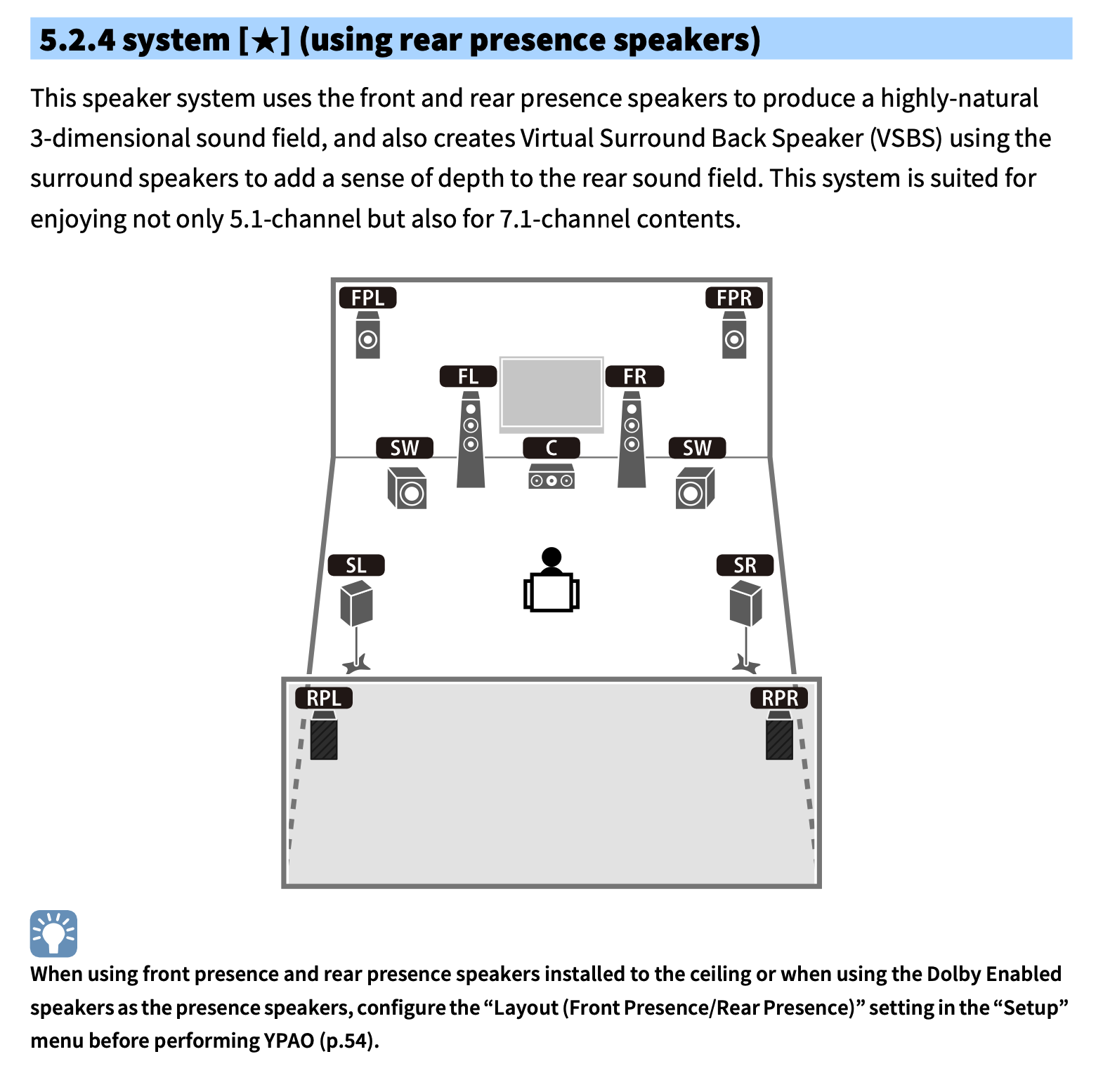

Streaming services do use DD+ but some devices, like the Apple TV 4K, will output audio after converting to LPCM. Those devices will require more bandwidth than the ARC spec provides for multichannel signals.
Anyway, if the receiver here reports an Atmos/DD+ signal from the TV's apps, then Atmos metadata is present in the ARC signal. The 2080 does not support eARC. So, eARC Support should be turned OFF in the LG C1. Digital Sound Output should be set to Passthrough. Dolby signals will have Dolby Offset present and often require a volume bump compared to PCM signals.
Straight mode should be fine but Yamaha does recommend DSur mode for Dolby Atmos tracks with that unit. I'm a bit confused about the speaker layout and connected devices. While 5.4.4 was mentioned, I don't see any Presence Speakers or how they are configured in settings. Are they set as Height, Overhead or Dolby Enabled SP? Surround Speakers should be shown as SL and SR, not RL and RR when using five speakers at ear level instead of seven. I'd be interested in just how everything is connected and configured here.
I changed the settings on the TV and now things are quite different. Background music is much more present and the display on the front of the unit still says Atmos DD+ so maybe its working as best it can.
With respect to eARC... looks like I should have bought the next version of this receiver... it has eARC
With respect to speaker layout, I do actually have my "rear" speakers connected as surround speakers. You are correct, you dont get rear speakers unless you also have surrounds set up. In my room I could not position them on the sides, and so my "Surrounds" are actually in the back.

You won’t need eARC for streaming Dolby Atmos from the TV’s apps. ARC can handle the lossy Atmos/DD+ streams. But, when eARC support is ON in the TV and the receiver only supports ARC, the LG TVs will re encode the signal to fit and things can go south.
Lossy Atmos (Atmos DD+) is what's used by all streaming services, including Netflix, MAX, Disney+, Tidal, etc. So you are good to go as you are matching the source. For lossless TrueHD Atmos, you need Blu-Ray.
