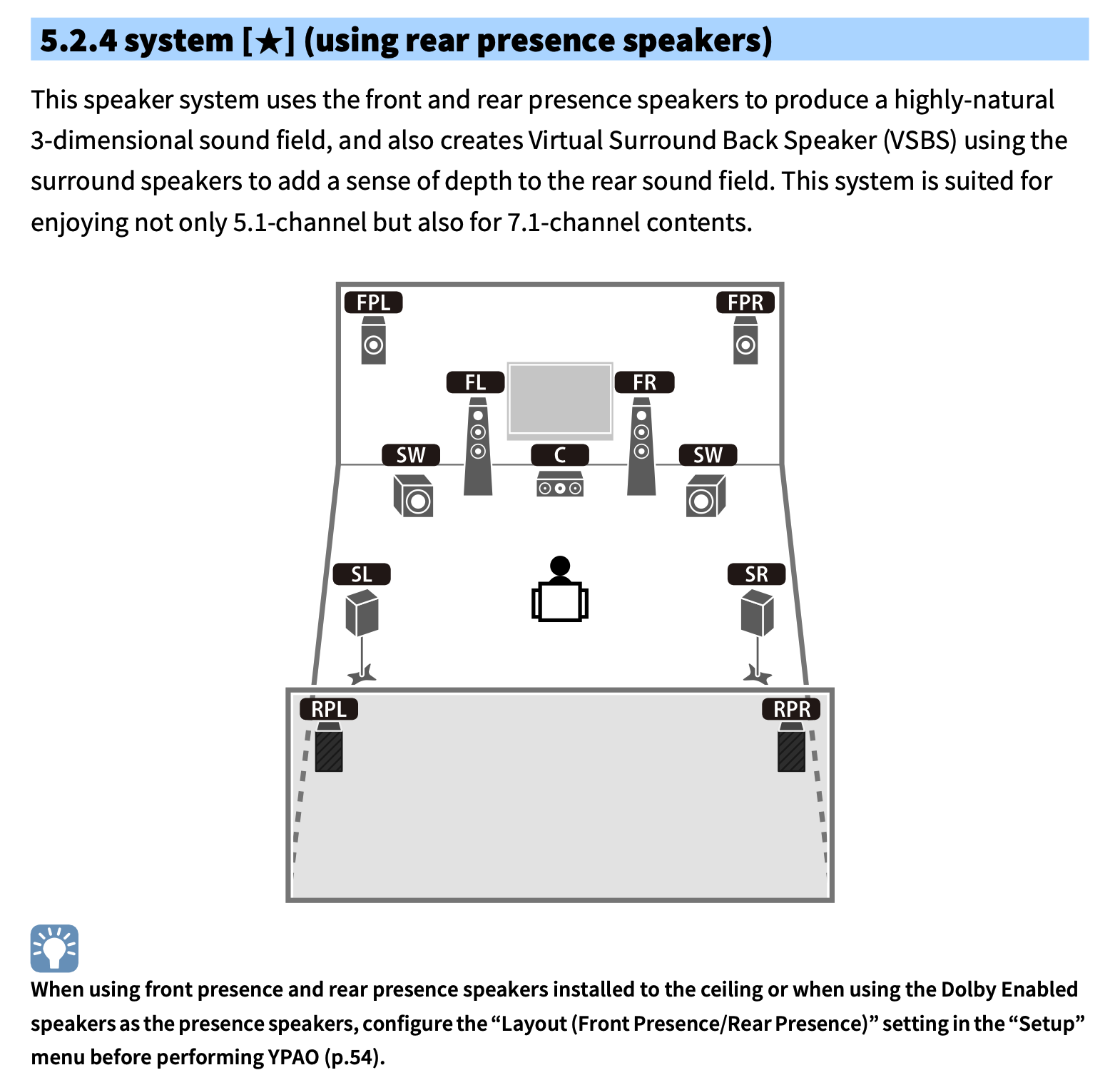

Hello, life long audio and video enthusiast here. After a long hiatus of about 15 years I finally built a new system for our living room and I have some questions. First here is the system:
Receiver: Yamaha 2080 (for home theater use)
Speakers Configuration: 5.4.4
FL, FR, RL, RR: Warfedale Diamond 9.1
Center Channel Speaker: Martin Logan Slim XL
Subs (4) Home built Parts Express / Dayton Audio 10" subs powered by two Dayton Audio stereo Amps
Streaming Device: AudioLab 6000N For Streaming Amazon HD Music and Spotify
TV: LG 77 C1 PUB connected to the Receiver via an HDMI
For Music
Integrated Amp: Yamaha A/S 2200, connected to the 2080 by a HT bypass input
Speakers: Modified Polk Monitor 5 Junior + backed up by the 4 subwoofers mentioned above
First an observation. The sound quality of streaming Amazon HD music is incredible in comparison to Spotify. I wish Spotify would provide HiFi sound quality, because when comparing Amazon HD to Spotify the difference is like night and day.
But this isn't about music, its about Atmos when watching movies.
So I built this incredible system in our new living room, upgraded to Netflicks 4K and then as soon as we started watching movies I was completely underwhelmed. Probably the biggest issue is that when watching a movie, the musical score is almost not audible because its so low. Atmos seems to be nonexistent as there is nothing even remotely reminiscent of a "soundfield" in our living room when watching a movie.
I've seen posts where people have said that these streaming services dont stream in HD, however when you look at a movie titles in AppleTV+ or Netflicks some will say "ATMOS". What does that mean and how do I get Atmos to my receiver? The best I've been able to do is to use the "Straight" function on the Receiver and if I do that I can get the front panel of the Receiver to say "Atmos DD+"
Is this a problem with the TV? I've also read that it might be possible to get the ATMOS stream to the Receiver if you use an Nvidia Shield PRO device.
The goal is to be able to get ATMOS with out having to buy a disk player and start using HD BluRays.
If your Yamaha front LCD says "Dolby ATMOS", then you are getting ATMOS.
Yes, you can also bitstream Dolby ATMOS using Nvidia Shields Pro.
Who streams Atmos content without Dolby DD+ as codec? Only way to avoid that afaik is buying the bluray. Atmos is just the metadata, and it can be transmitted with Dolby DD+.....but no one as far as I know streams a lossless version (takes too much bandwidth).

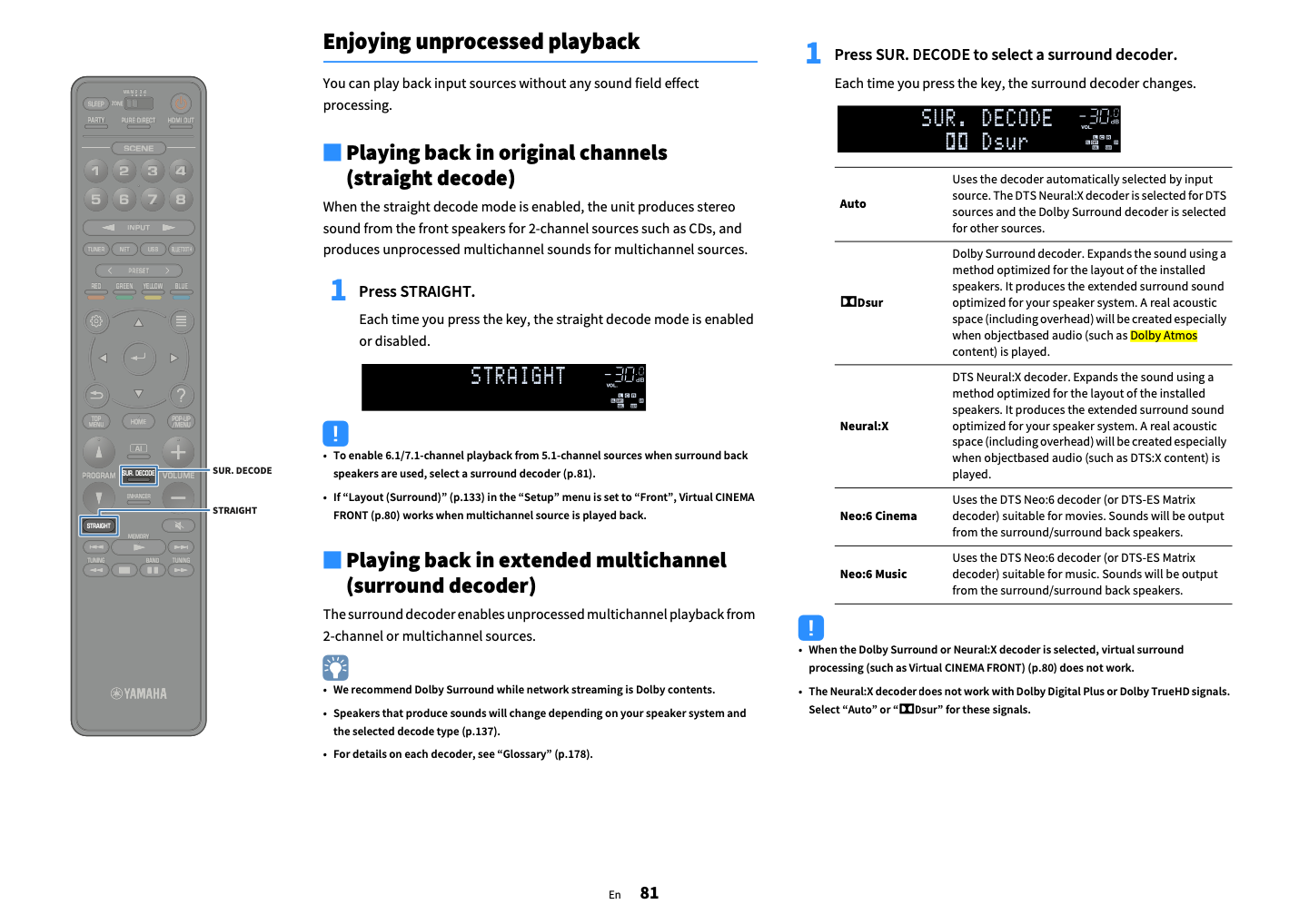

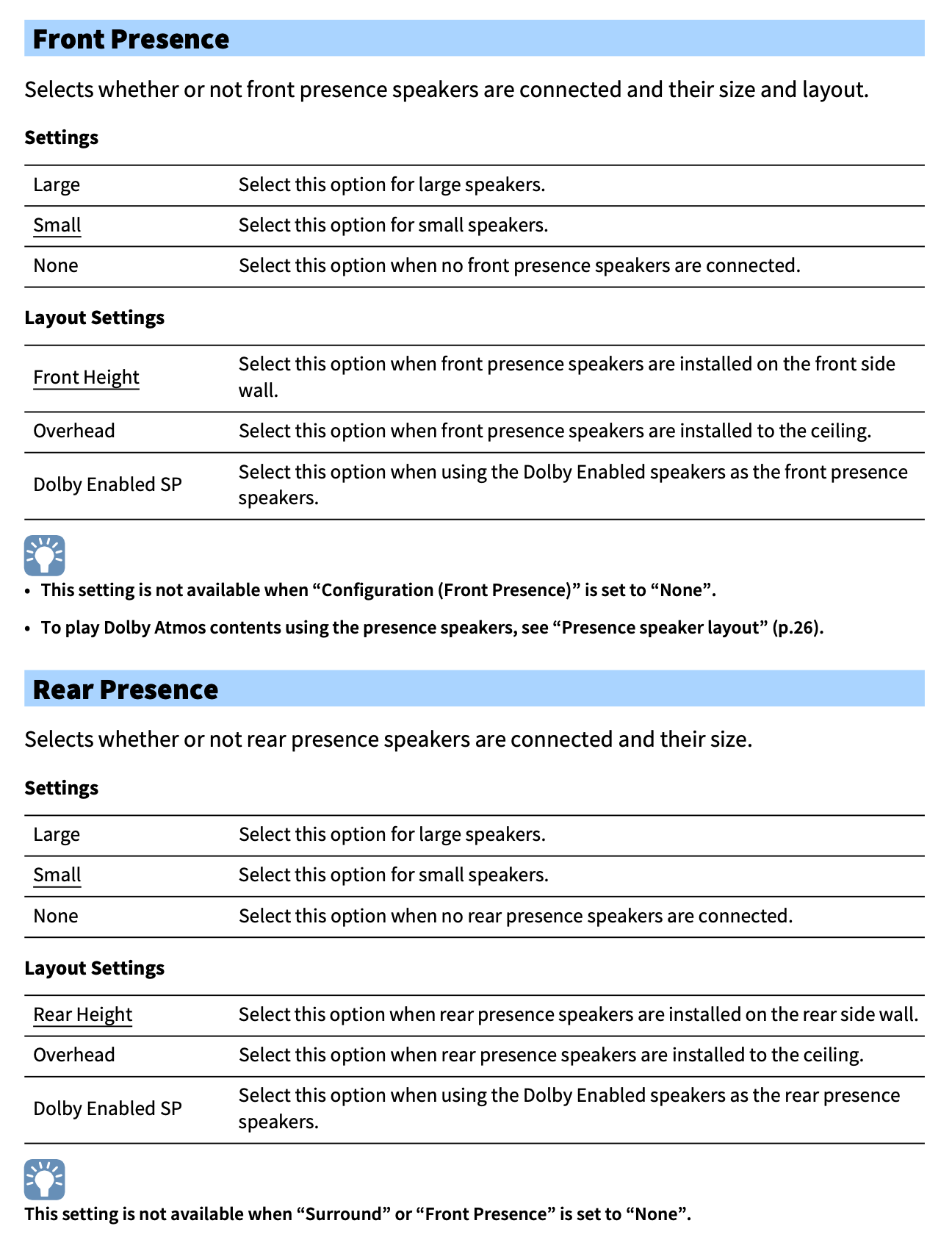

Streaming services do use DD+ but some devices, like the Apple TV 4K, will output audio after converting to LPCM. Those devices will require more bandwidth than the ARC spec provides for multichannel signals.
Anyway, if the receiver here reports an Atmos/DD+ signal from the TV's apps, then Atmos metadata is present in the ARC signal. The 2080 does not support eARC. So, eARC Support should be turned OFF in the LG C1. Digital Sound Output should be set to Passthrough. Dolby signals will have Dolby Offset present and often require a volume bump compared to PCM signals.
Straight mode should be fine but Yamaha does recommend DSur mode for Dolby Atmos tracks with that unit. I'm a bit confused about the speaker layout and connected devices. While 5.4.4 was mentioned, I don't see any Presence Speakers or how they are configured in settings. Are they set as Height, Overhead or Dolby Enabled SP? Surround Speakers should be shown as SL and SR, not RL and RR when using five speakers at ear level instead of seven. I'd be interested in just how everything is connected and configured here.
