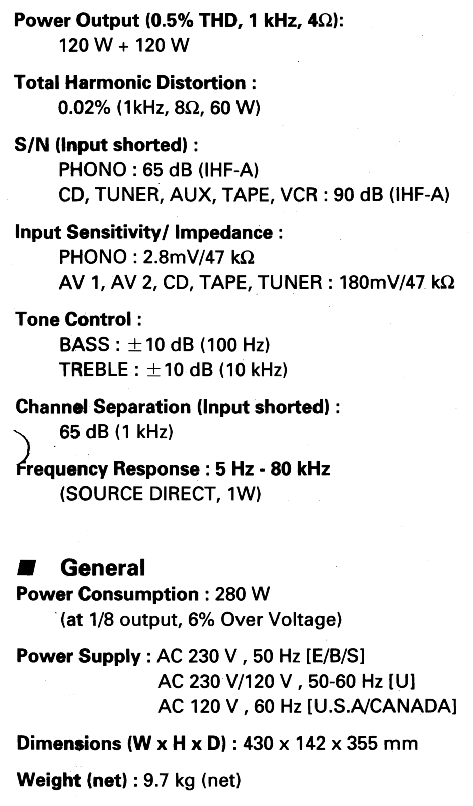

Good day,
I have TEAC AR600 amplifier connected with YAMAHA NS515F speakers (to A) and DLS IC623 (to B). All working well, except DLS IC623 connected to B, they sound like MONO, like speakers with out tweeter. Can you help me please, can it be just wrong speakers to amplifier or better to search damage in speakers or amplifier?
Thank you.
Amplifier:
Yamaha speakers:

I believe it's 120 wpc into 4 ohms for 2 channels. Running both A &B would split that between the zones if I understand correctly. This is what I got from the owner's manual for that Teac,
Check the impedance of your speakers. Connect speaker
with an impedance of 4 to 16 ohms when using only one
pair of speakers (SPEAKERS A or SPEAKERS B). When using
two pairs of speakers simultaneously, the impedance should
be 8 to 16 ohms.
With the speakers you have connected it's recommended to only run one zone at a time. All 4 of those speakers need to be 8 ohm or greater for that amp to run stable with both zones selected.
