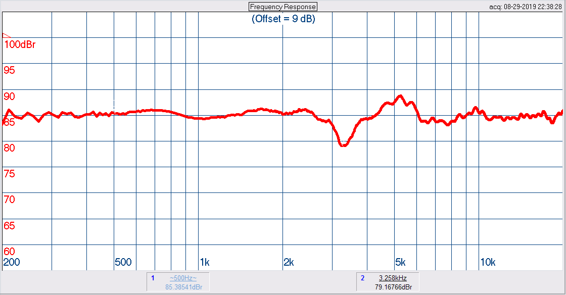

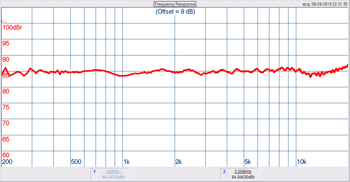

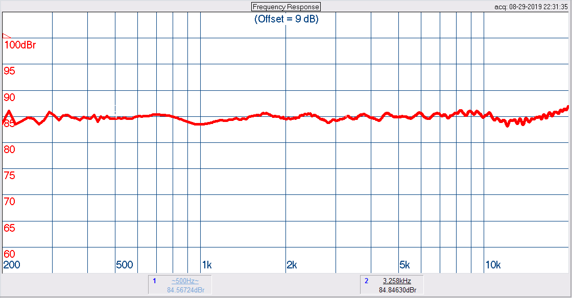

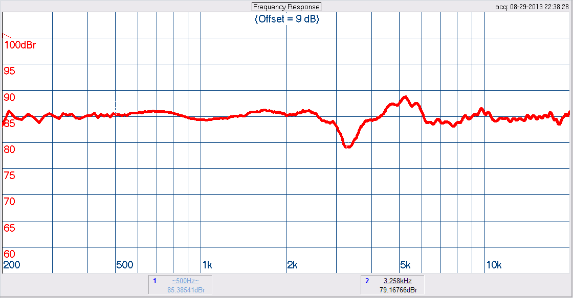

All of this is certainly interesting, and I hadn't thought thought of it before. To test the theory out (albeit not rigorously),I played some white noise from my FM tuner through the exact same BMR speaker that Shady used for his Audioholics review and as an illustration of grill effects earlier in his posted article. I've attached my with-and-without-grill measurements to save you the trouble of pulling up the article again. My measurements track Shady's very closely except for small differences in our mic calibrations in the highs. I think we can all agree that if the severe dip and peak in the with-grill measurement also showed up with the grill off, you could probably hear the irregularity and Shady wouldn't have awarded 5 stars to the BMR.
In any event, I enlisted a friend to remove and replace the BMR grill while I listened to white noise about 9 feet from the speaker. ( I kept my eyes closed, but I could hear when the grill was removed and replaced). To my ears, the sound was identical either way. My friend and I switched places, and he couldn't hear any difference either. Then we repeated the experiment listening very close to the speaker, about 8 inches away. The only difference I could hear was when the solid frame of the grill passed in front of the speaker. I'm sure you can fault the design of the experiment, but it was pretty convincing to me, and you can easily replicate the test on your own speakers. I have to conclude that the relative inaudibility of diffraction effects remains something of a mystery.

This is a terrific contribution, Dennis! Thank you very much!
