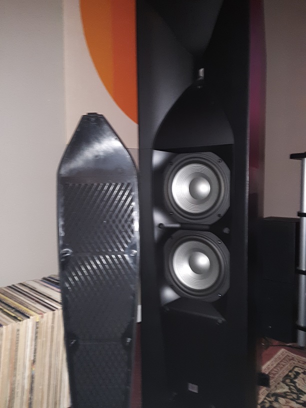

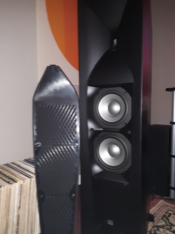

Don't really find drivers all that attractive generally, even put grills on my diy subs. I hve wondered how much difference a really thick frame might have, or ones that are more than just a frame around the edges (like the ones that more appear as cutouts in a baffle for the drivers).
Then there are the grills/cabinets like my S590s, wonder what the measurement differences would be on vs off? They're engineered to be on to an extent....but I still really don't want to look at them particularly....might have to play around with the measurement mic next time around....
The grilles won't affect much from the woofers, but they could possibly be affecting output from the tweeter, since it does slightly change the geometry of the horn. In measurements, I would expect to see an slight increase in horn diffraction. I think that it would probably be very difficult to actually hear.
Actually there's a separate piece to add back to the horn should you want to use them without the grills, didn't put that in the pic.
In that case, it looks like the grille piece adds an intended piece of the horn geometry, in which case those speakers should measure the same with or without grilles.
Was wondering if any effects in the midrange as in some of your measurements, crossover is listed at 1.5khz.
Not likely, since the wavelength of 1.5 kHz is 8.6 inches, so it will be too big for the grille frames to have any effect around the woofers. One funny thing I remember about some youtube review of these speakers that I saw a couple years ago is that the reviewer talked about 590's using a waveguide around the woofers. Not likely with 8" woofers. If you wanted an effective waveguide around 8" woofers, it would have to be just huge.
