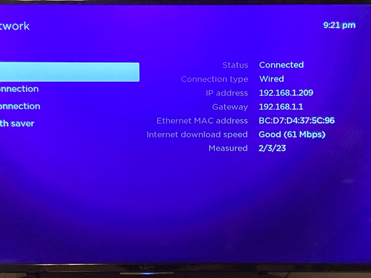

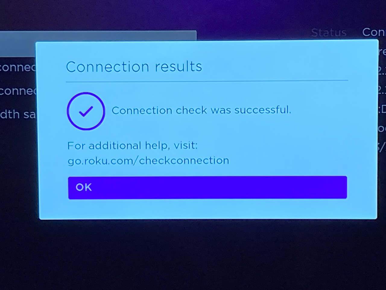

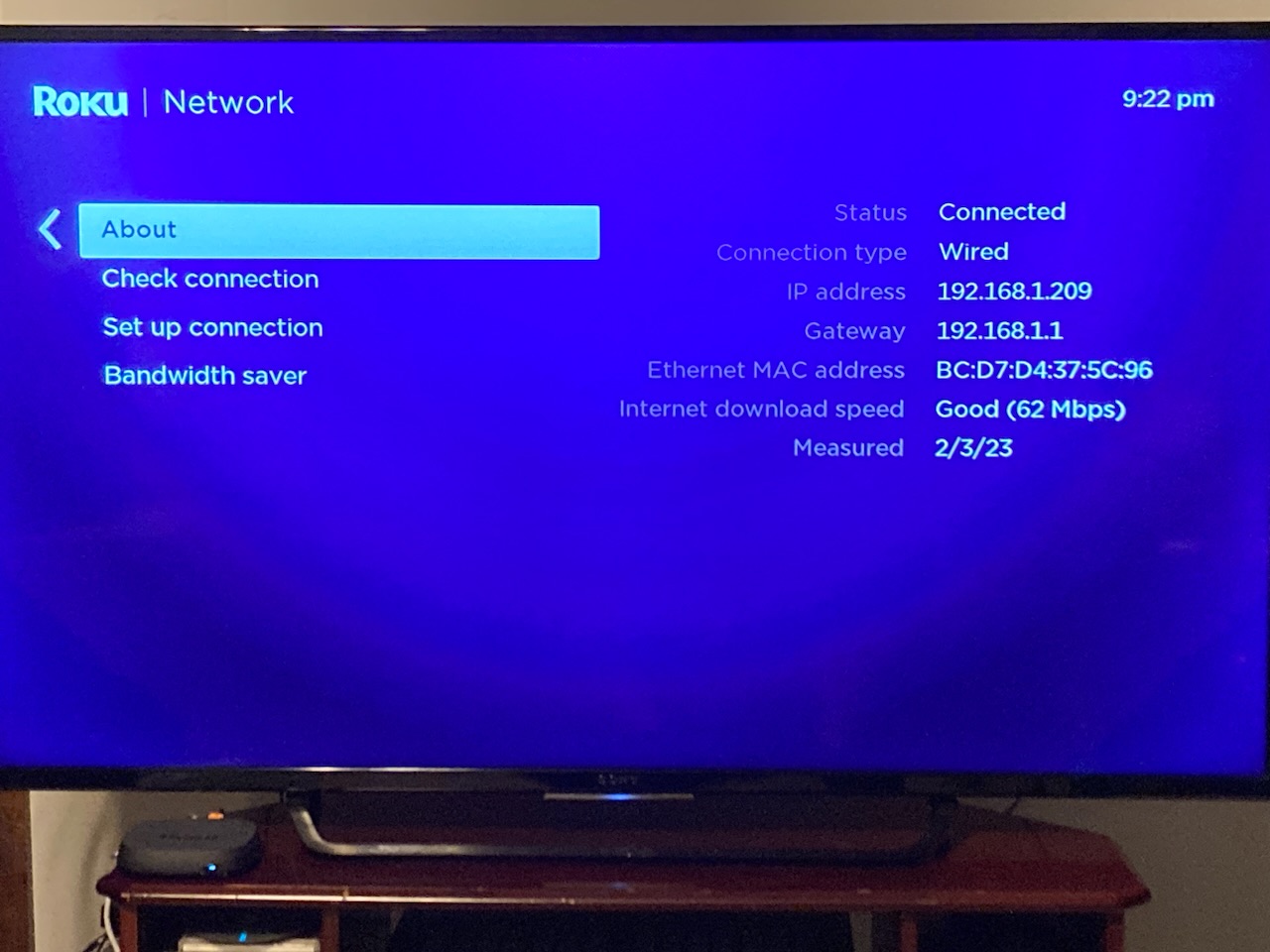

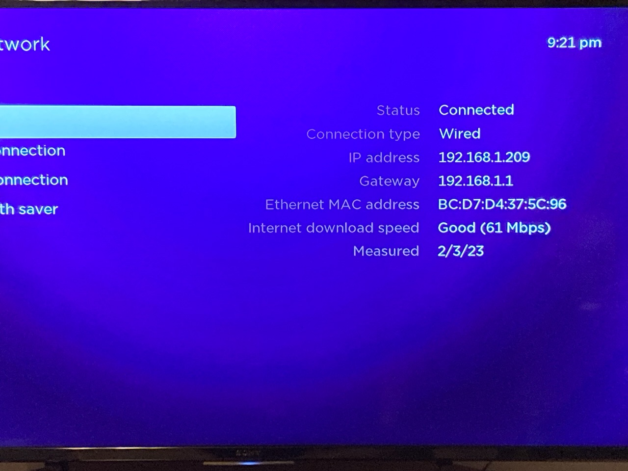

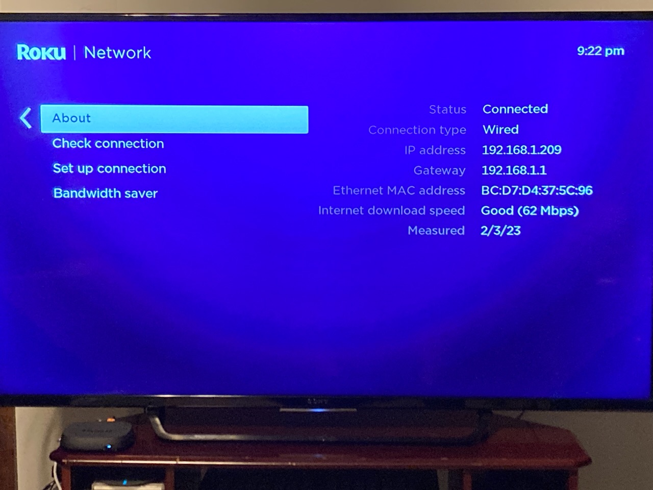

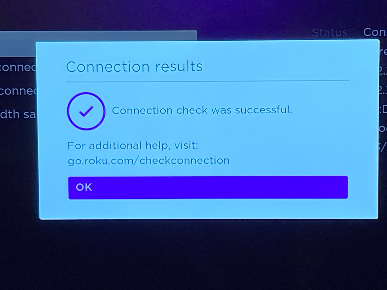

View attachment 60069View attachment 60070View attachment 60071

Don't rely on the Roku's Connection Speed description of Good at 67 Mbps to influence you. Your picture from the Spectrum App still sucks and it needs more. If you can't get this sorted, maybe call your ISP (Spectrum) and get them to work on it.
