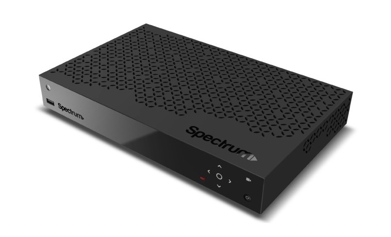

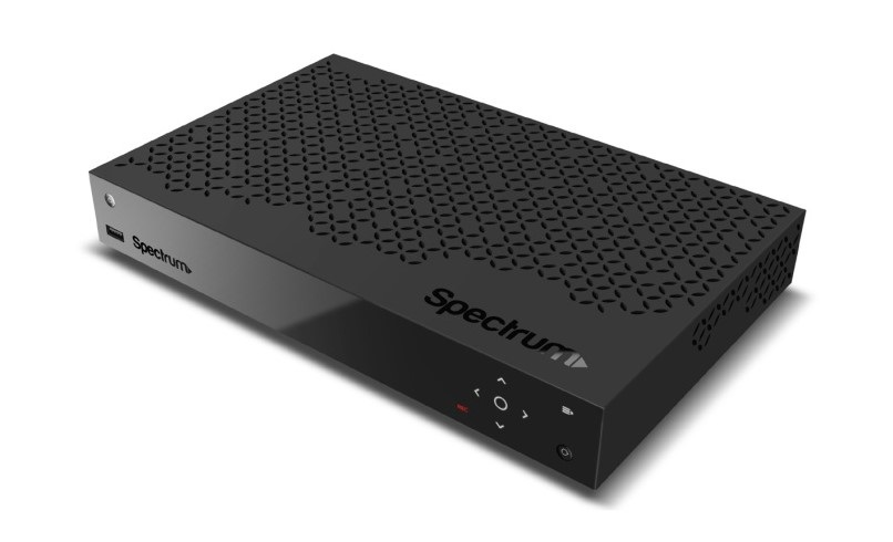

How is the TV connected to the network? I don't have time to search for this, but if it's not wired, do that. Read the tag line in my posts about wired vs wireless.
Is this your box for the other TV(s)? If it is and you use a remote, press the settings , look for the menu button and click on Settings. You should see some boxes with Audio, Remote, Cable receiver (or something similar). You can check signal strength if you look around, or you can contact Spectrum and they can tell you if it's acceptable.
Before calling Spectrum, make sure that any cables are being used, or are terminated with a shorting cap- it can make a difference because the signal can reflect on the cable and if you live in am apartment or near other homes, everybody's bad terminations will affect everyone else's video quality.
If the app looks that bad, I would suspect WiFi quality.
