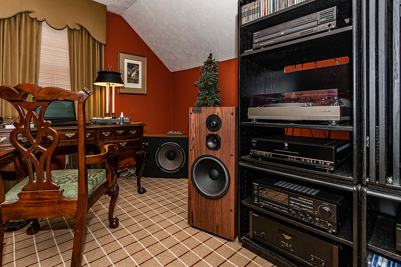

It's House music, man! I've got a ton of it and Dance music genre too, lot's of low bass. It's my JBL B380's diet these days.View attachment 34339
oh dam, went over my head lol, I’m digging the plant on your speaker. Those are JBL? and what’s the unit at the bottom of your audio rack? Back when I owned a home in 96 I had a pair of Cerwin Vega speakers
18” driver with two 7” drivers for mid range, plus the horn
them speakers had the richest bass and mid bass i’ve ever heard.
sterling shoote

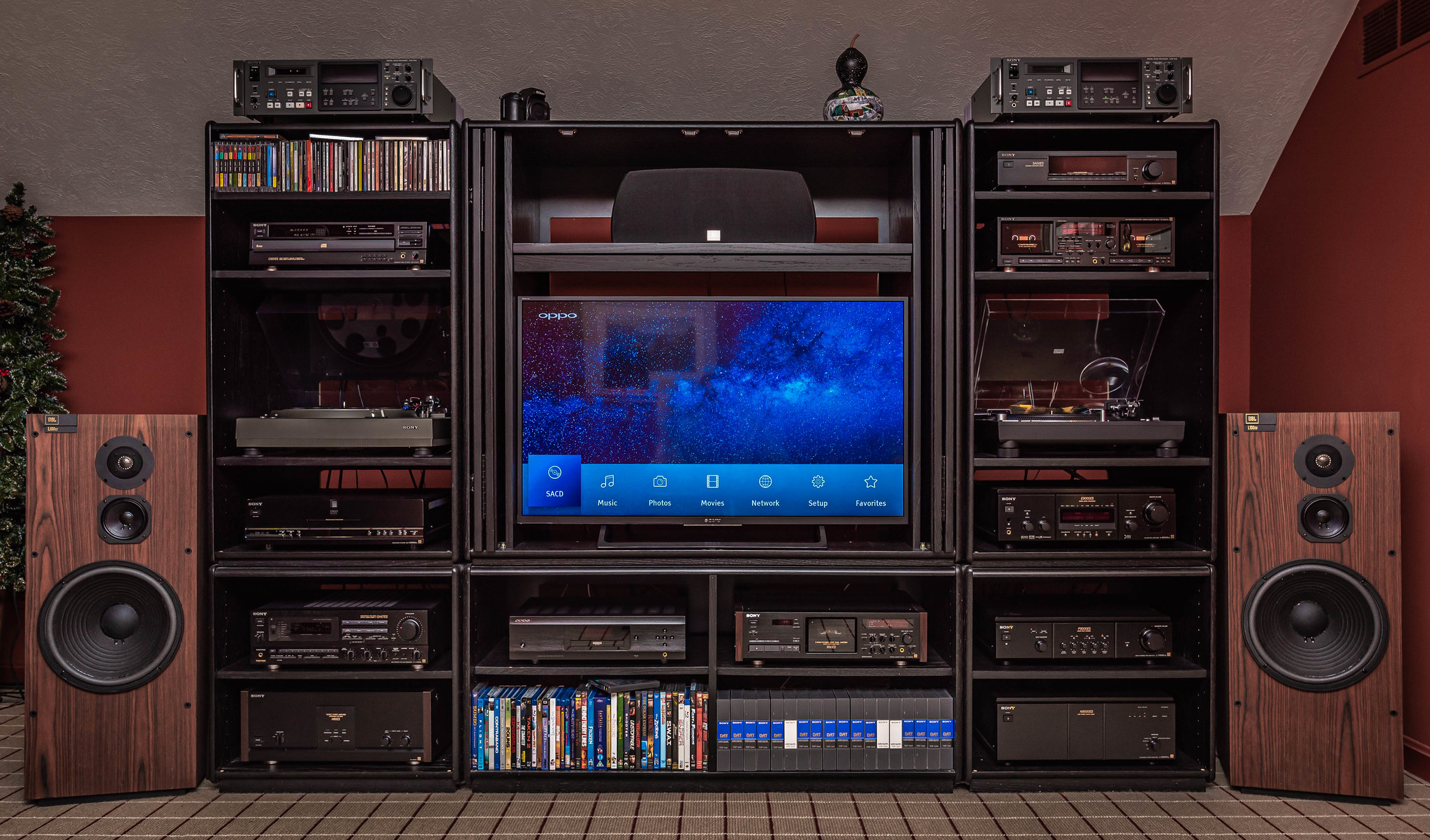

It's a small Christmas Tree behind a JBL L100t3. The bottom component is a Sony TA-N80ES Power Amp bridged to mono for 560 watts to power the JBL B380. The JBL B380 just has a 15" driver but it gets down to about 23Hz or thereabouts at -6db. I began putting th system together back in 1975 ago when I was gainfully employed. Now, I don't have enough money to afford much more than my Apple Music subscription. I like most genres of music except country and the sub makes it all better. Here's the whole rack, the DAT Recorders don't work so good anymore and too expensive to repair. At any rate, I listen to stereo from the Sony TA-E9000ES bought 20 years ago via Airport Express; and, I listen to 5.1 from a Sony TA-P9000ES bought about 19 years ago. It was in storage most of that time until I bought a BD Player that had multi-channel analog output which could be connected to the Sony. I still have no HDMI amplification.

It's a small Christmas Tree behind a JBL L100t3. The bottom component is a Sony TA-N80ES Power Amp bridged to mono for 560 watts to power the JBL B380. The JBL B380 just has a 15" driver but it gets down to about 23Hz or thereabouts at -6db. I began putting th system together back in 1975 ago when I was gainfully employed. Now, I don't have enough money to afford much more than my Apple Music subscription. I like most genres of music except country and the sub makes it all better. Here's the whole rack, the DAT Recorders don't work so good anymore and too expensive to repair. At any rate, I listen to stereo from the Sony TA-E9000ES bought 20 years ago via Airport Express; and, I listen to 5.1 from a Sony TA-P9000ES bought about 19 years ago. It was in storage most of that time until I bought a BD Player that had multi-channel analog output which could be connected to the Sony. I still have no HDMI amplification. View attachment 34343
Here’s a man that got his Moneys worth, love all the village gear! very nice bro!
