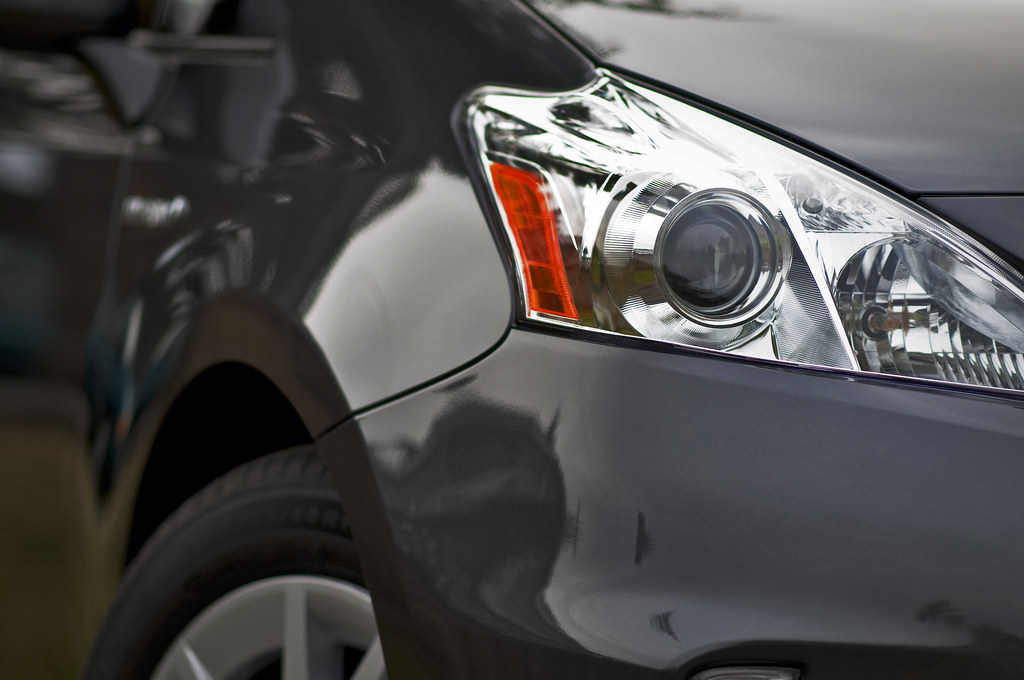

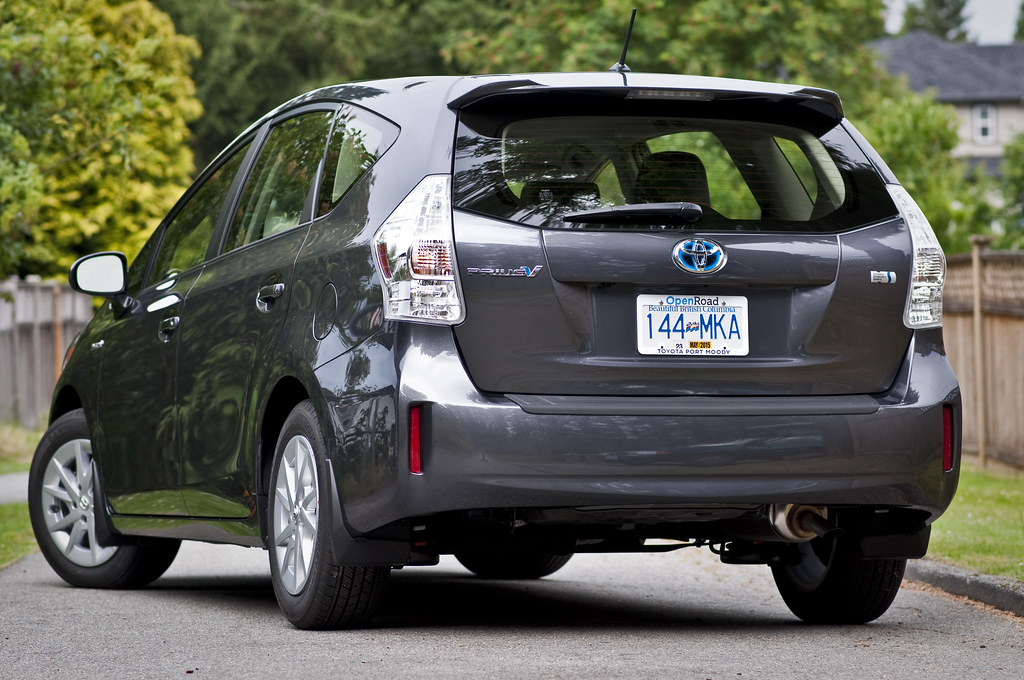

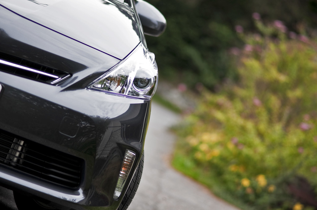

Lets get started, first with just some finished shots of my Parents new Car, 2014 Prius V.
DSC_6249 by brianjosephson1, on Flickr
DSC_6341 by brianjosephson1, on Flickr
DSC_6348 by brianjosephson1, on Flickr
DSC_6359 by brianjosephson1, on Flickr
DSC_6384 by brianjosephson1, on Flickr
Being a new car, it's not exactly hard to make it sparkle, but still it was not cleaned or detailed properly at the dealership.

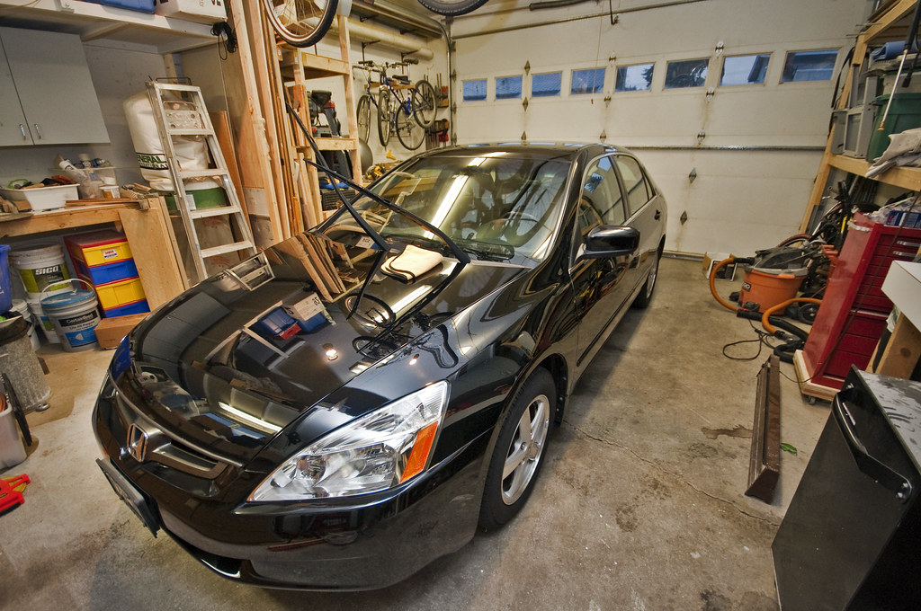

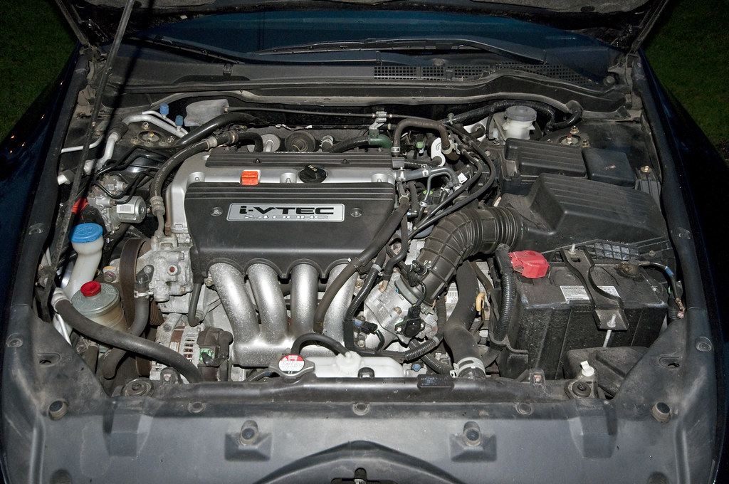

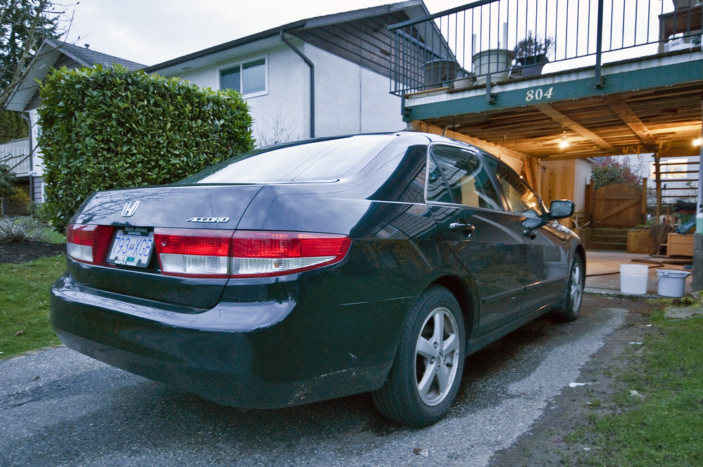

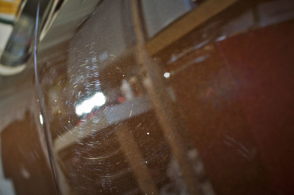

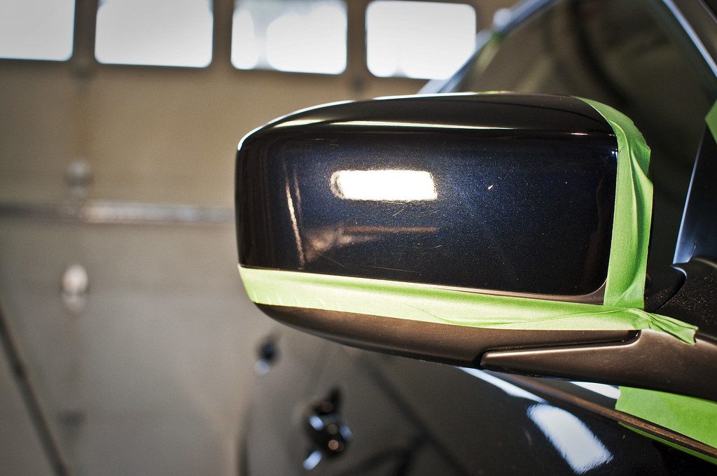

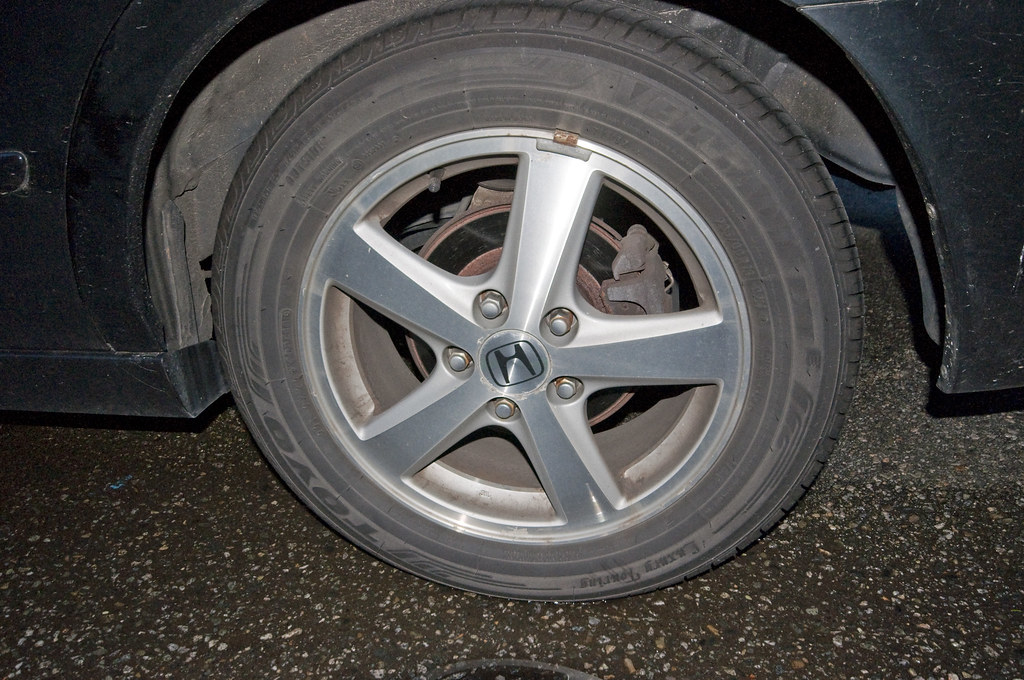

Moving on, this is a buddies Honda Accord. Well taken care of, low mileage, but hasn't seen a proper clean in a few years.
DSC_5060 by brianjosephson1, on Flickr
DSC_5074 by brianjosephson1, on Flickr
DSC_5080 by brianjosephson1, on Flickr

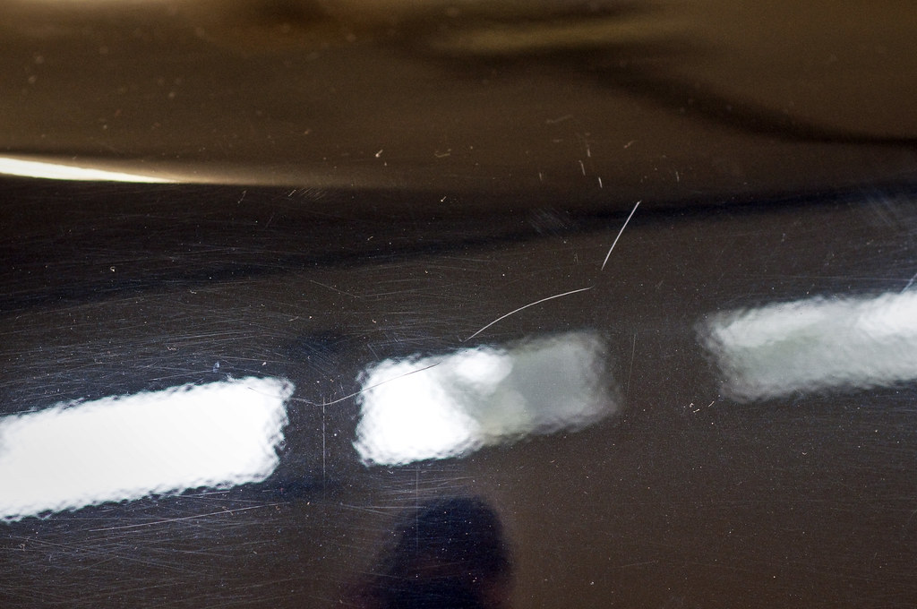

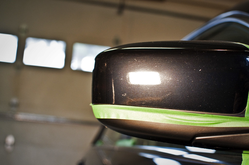

Some deep scratched which were rounded and reduced as much as safely possible.
DSC_5083 by brianjosephson1, on Flickr
DSC_5108 by brianjosephson1, on Flickr
And after! Note that removing all defects was not in the cards, just a general improvement.
DSC_5110 by brianjosephson1, on Flickr
Ready for sealant!

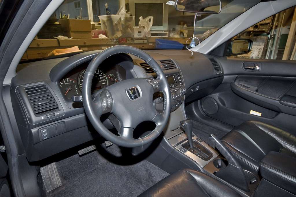

Interior cleaned and dressed.
DSC_5155 by brianjosephson1, on Flickr

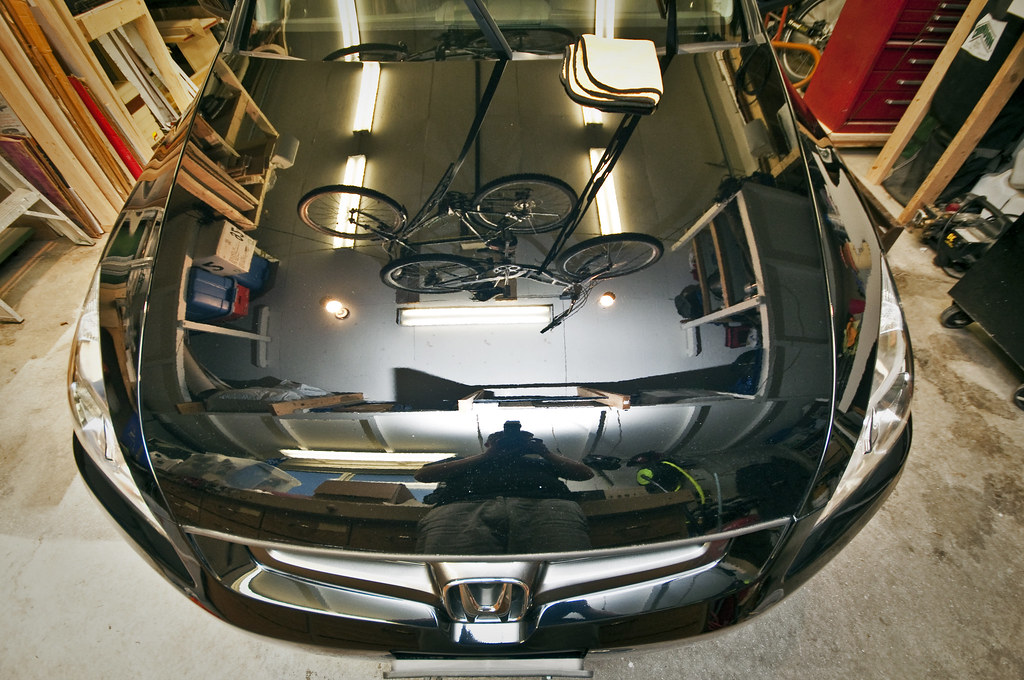

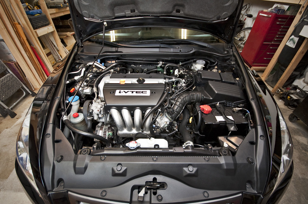

As well as the vroom vroom.
DSC_5159 by brianjosephson1, on Flickr

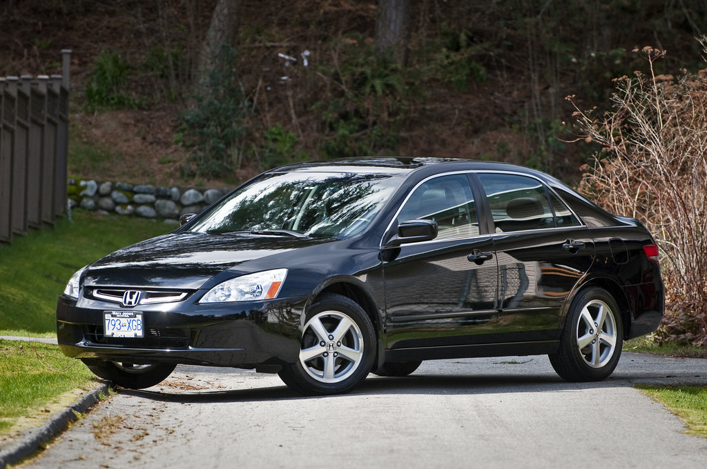

Leaving us with this!
DSC_5199 by brianjosephson1, on Flickr

Engine gets foamand APC with brush agitiation.

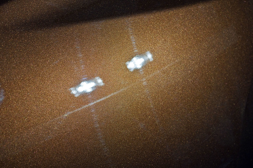

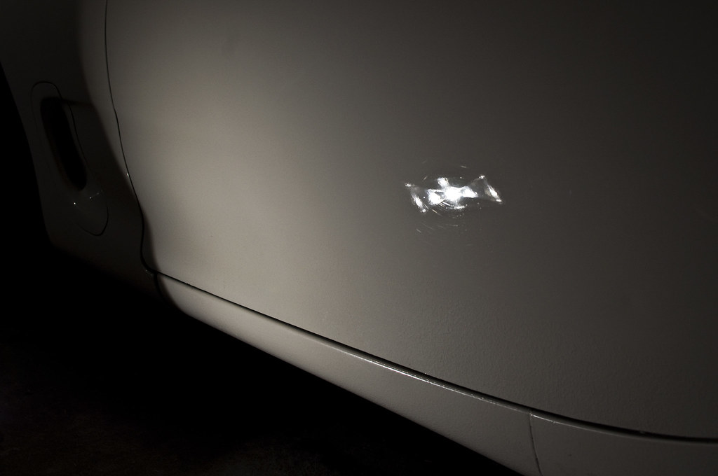

Once in the garage I inspect the paint with various lights to see how bad the paint is and choose my polish and pad combinations. Some times people don't care about chasing all the marks and scratches so a light machining with just 1 polish step is usually what I find I'm doing. Below you'll see the hazy overspray below the mirror.
DSC_3406 by brianjosephson1, on Flickr
This is the paint on the rear bumper, which is brand new. I need the rest of the car to not look out of place to this.
DSC_3412 by brianjosephson1, on Flickr
Small swirl from a brush being used to remove sap.
DSC_3422 by brianjosephson1, on Flickr
50/50 on the overspray after getting hit with a heavy cut polish on a Micro Fiber pad.

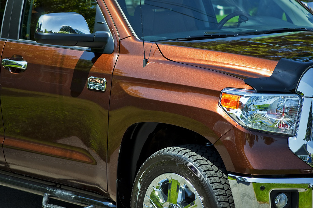

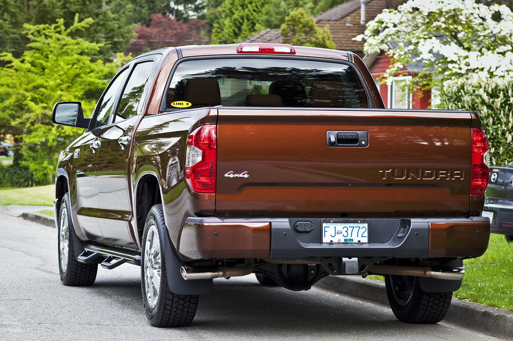

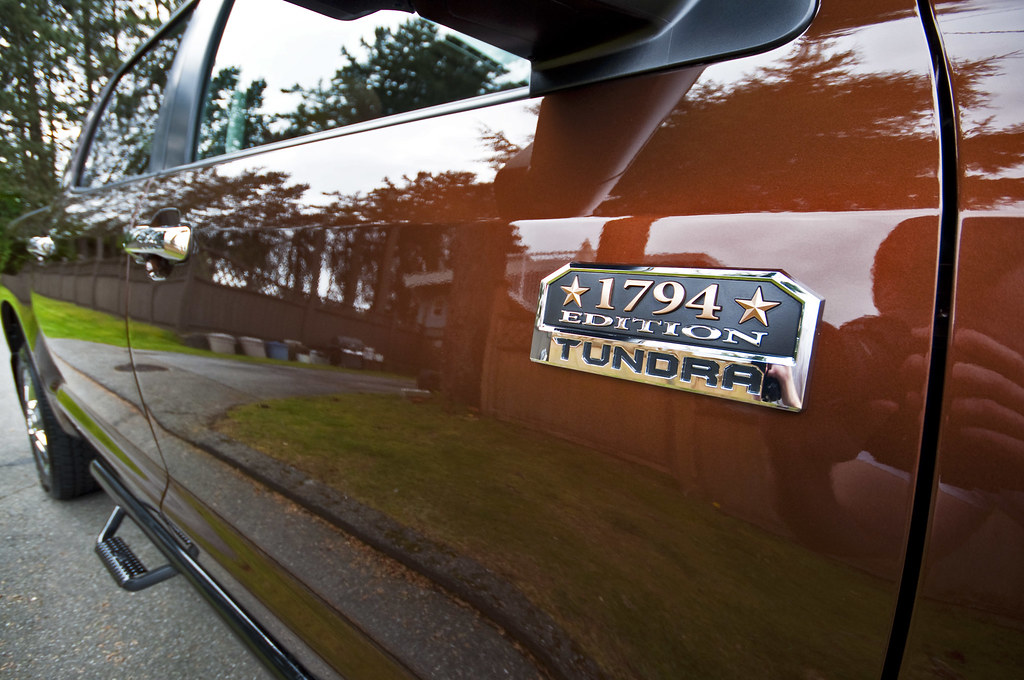

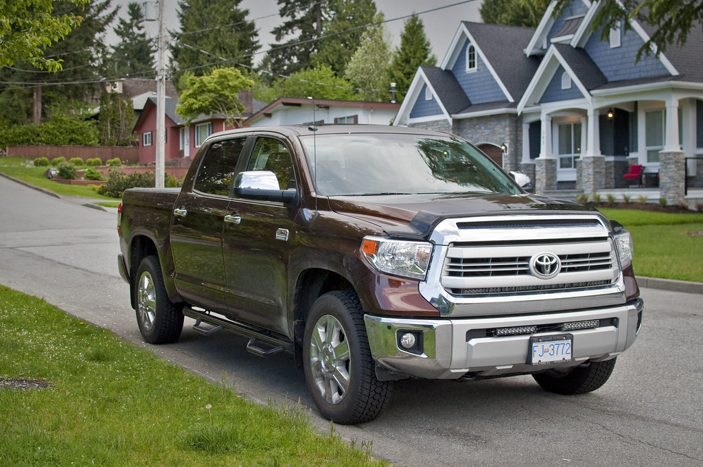

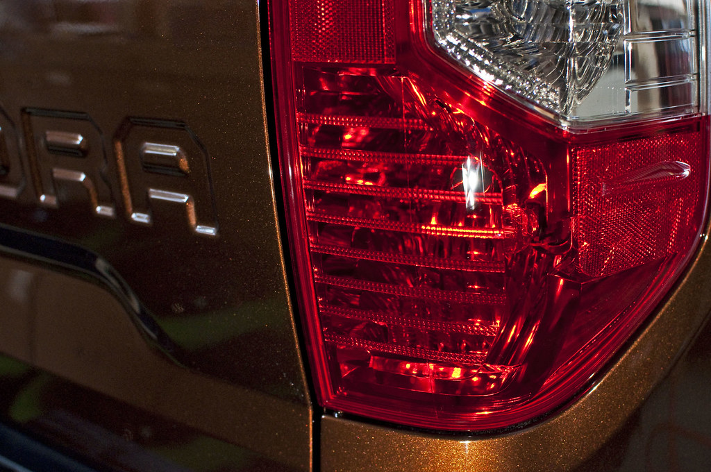

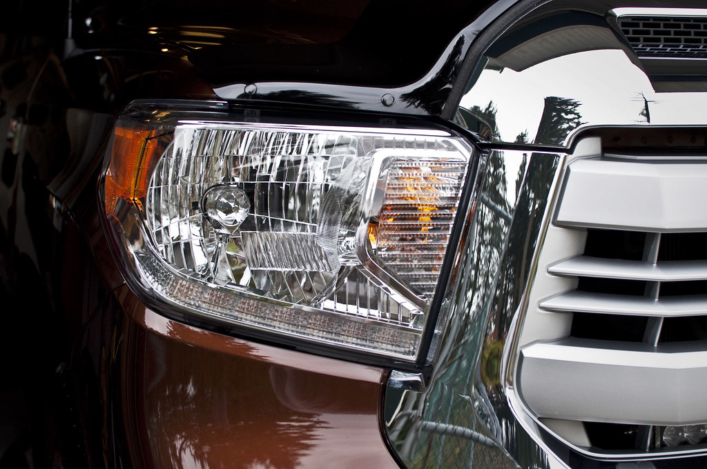

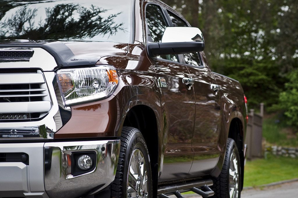

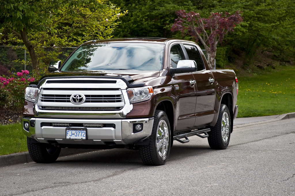

Last one for now, this is my friends 2014 Toyota Tundra 1794 Edition.
DSC_5646 by brianjosephson1, on Flickr

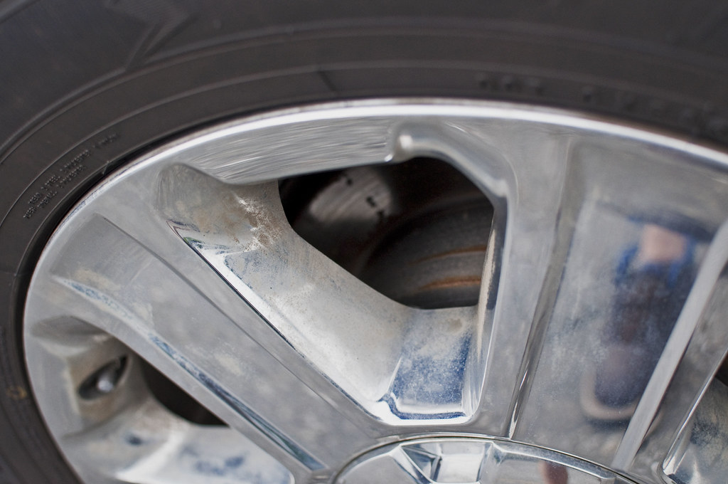

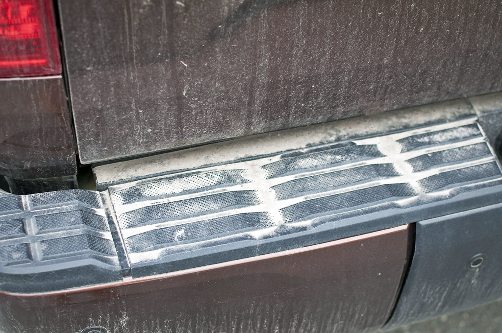

He lives up north (near alaska) and it definitely needs regular cleaning. I usually clean the truck and he gives me a nice bottle of scotch.
DSC_5655 by brianjosephson1, on Flickr
DSC_5660 by brianjosephson1, on Flickr
DSC_5661 by brianjosephson1, on Flickr
DSC_5664 by brianjosephson1, on Flickr
DSC_5669 by brianjosephson1, on Flickr

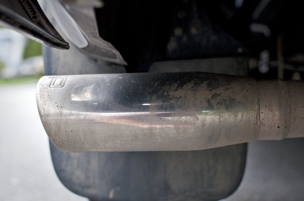

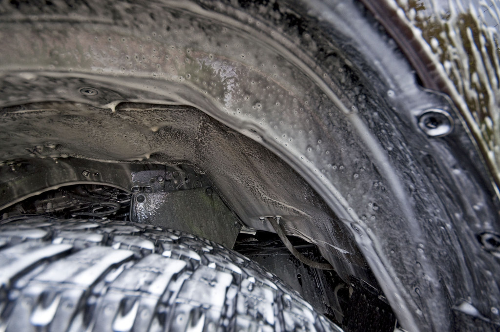

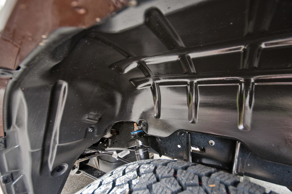

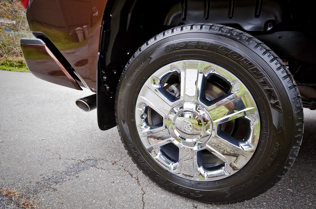

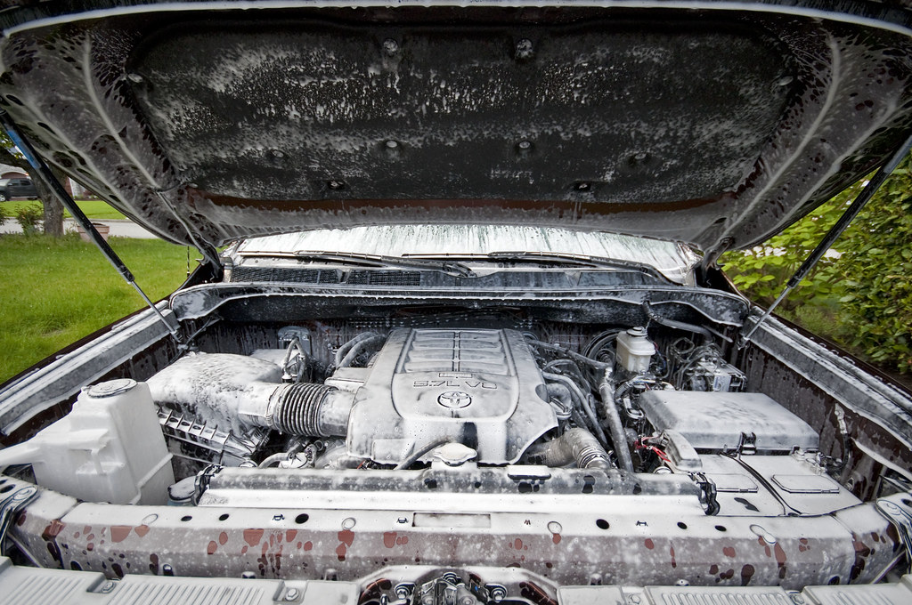

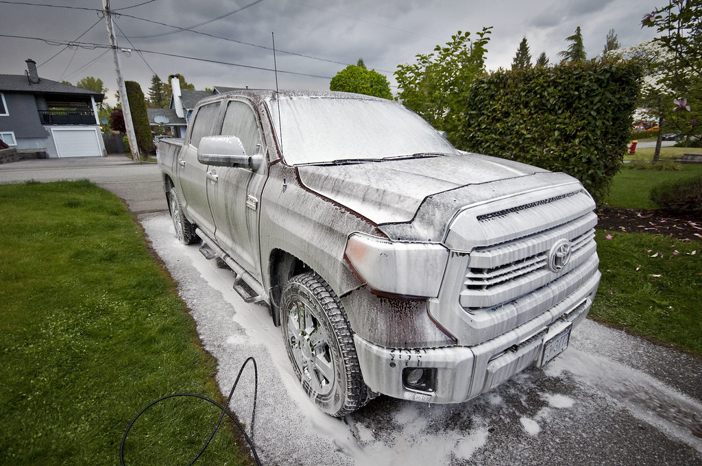

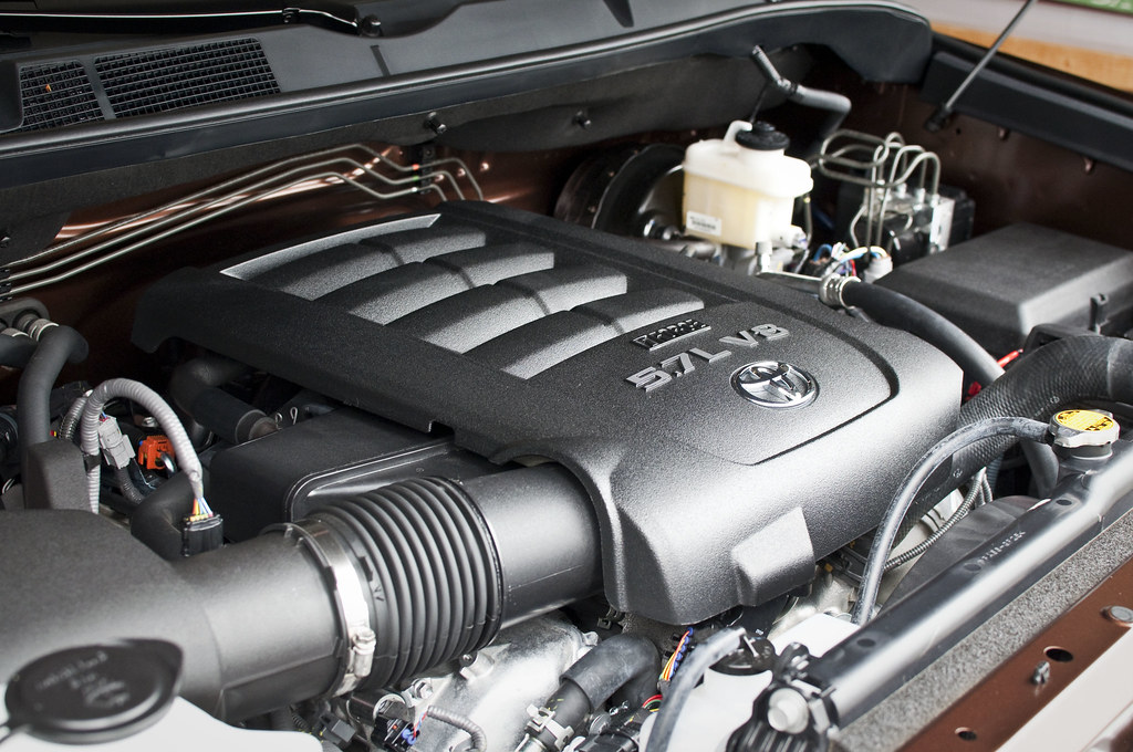

Lets clean! Engine, under carriage, and body all hit with APC and then snow foam to pull as much dirt as possible before contact.
DSC_5686 by brianjosephson1, on Flickr
DSC_5687 by brianjosephson1, on Flickr
DSC_5690 by brianjosephson1, on Flickr
After the wash the clay comes out to smooth out what was left behind.
DSC_5695 by brianjosephson1, on Flickr
Paint is okay for the situation. No cut polish was used as he doesn't want to start removing clear coat until there is more scratches.
DSC_5699 by brianjosephson1, on Flickr
DSC_5703 by brianjosephson1, on Flickr

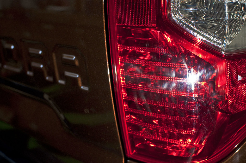

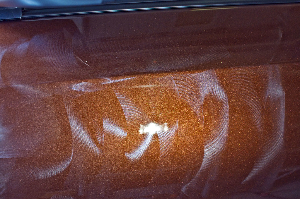

I used a couple different cleaner polishes to remove light marks and fill in the rest. These are super mild and you could polish for days without removing more then a micron of paint. Worked well on the tail lights though!
DSC_5713 by brianjosephson1, on Flickr
DSC_5723 by brianjosephson1, on Flickr
Polish being worked into the door panel. A lot of people are unclear how polishes really work, but it's actually quite simple. I'll explain it later in another post.
DSC_5737 by brianjosephson1, on Flickr

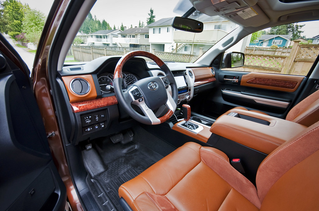

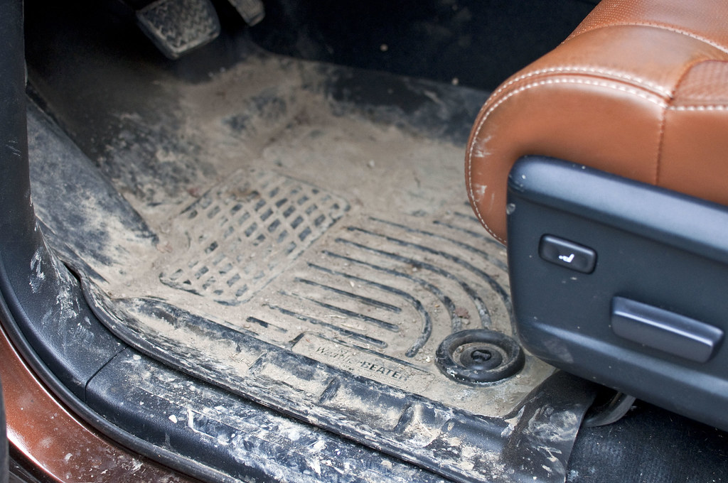

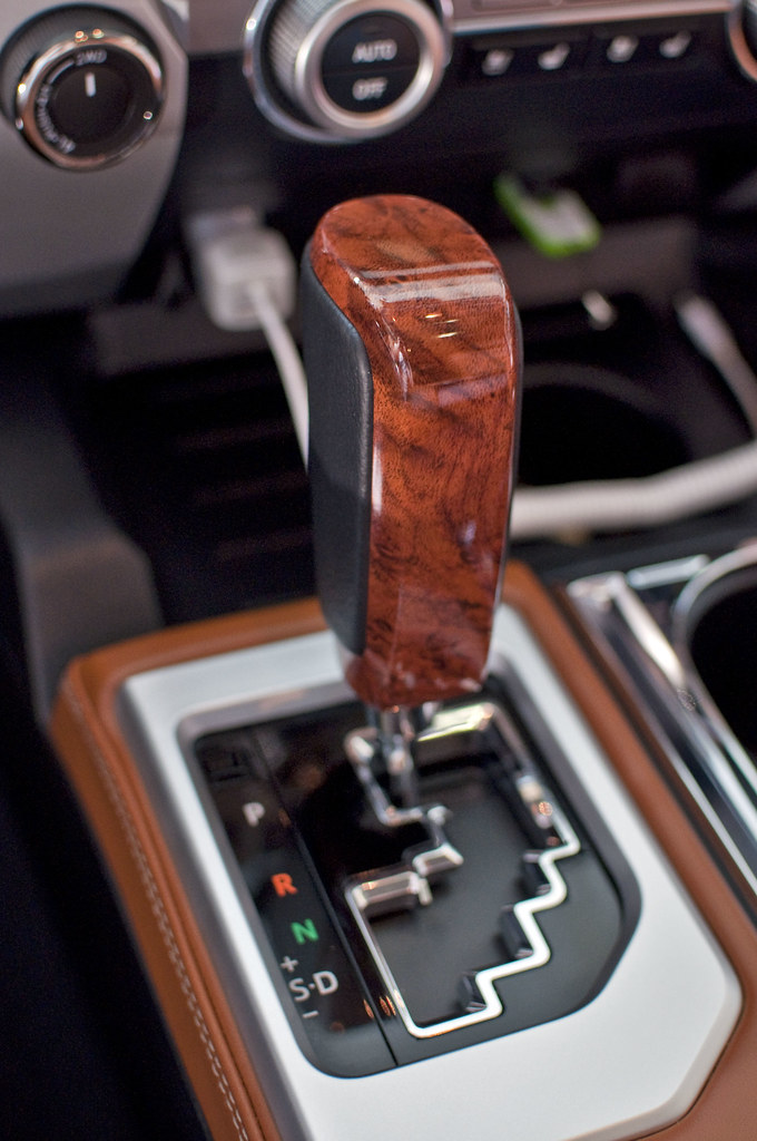

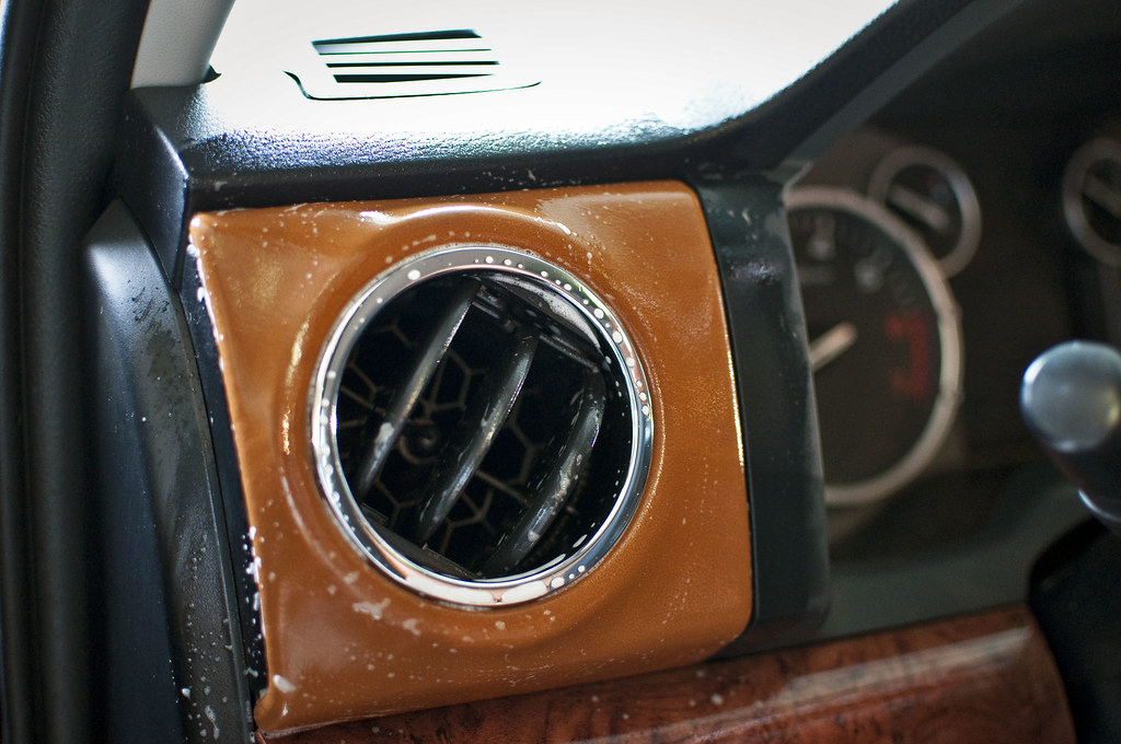

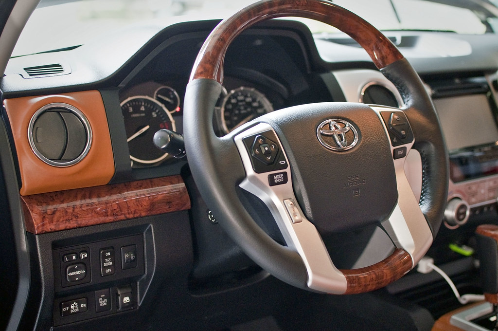

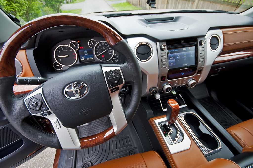

Entire interior APC'd and cleaned. The floor liners protected the carpet so only a light vacuum was required.
DSC_5739 by brianjosephson1, on Flickr
And the finished product.
DSC_5742 by brianjosephson1, on Flickr
DSC_5744 by brianjosephson1, on Flickr
DSC_5755 by brianjosephson1, on Flickr
DSC_5780 by brianjosephson1, on Flickr
DSC_5782 by brianjosephson1, on Flickr
DSC_5786 by brianjosephson1, on Flickr
DSC_5792 by brianjosephson1, on Flickr
DSC_5793 by brianjosephson1, on Flickr
DSC_5794 by brianjosephson1, on Flickr
DSC_5816 by brianjosephson1, on Flickr
DSC_5818 by brianjosephson1, on Flickr
DSC_5822 by brianjosephson1, on Flickr
DSC_5839 by brianjosephson1, on Flickr

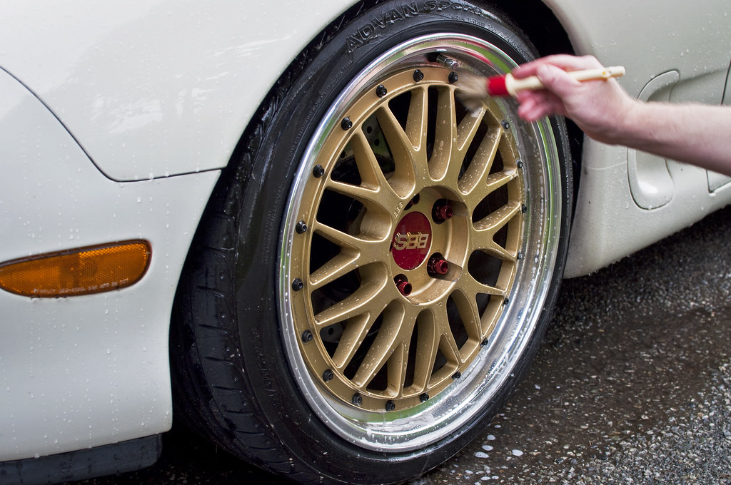

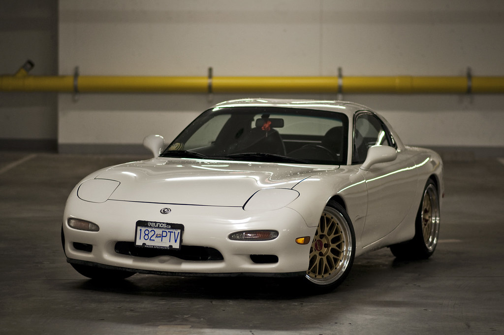

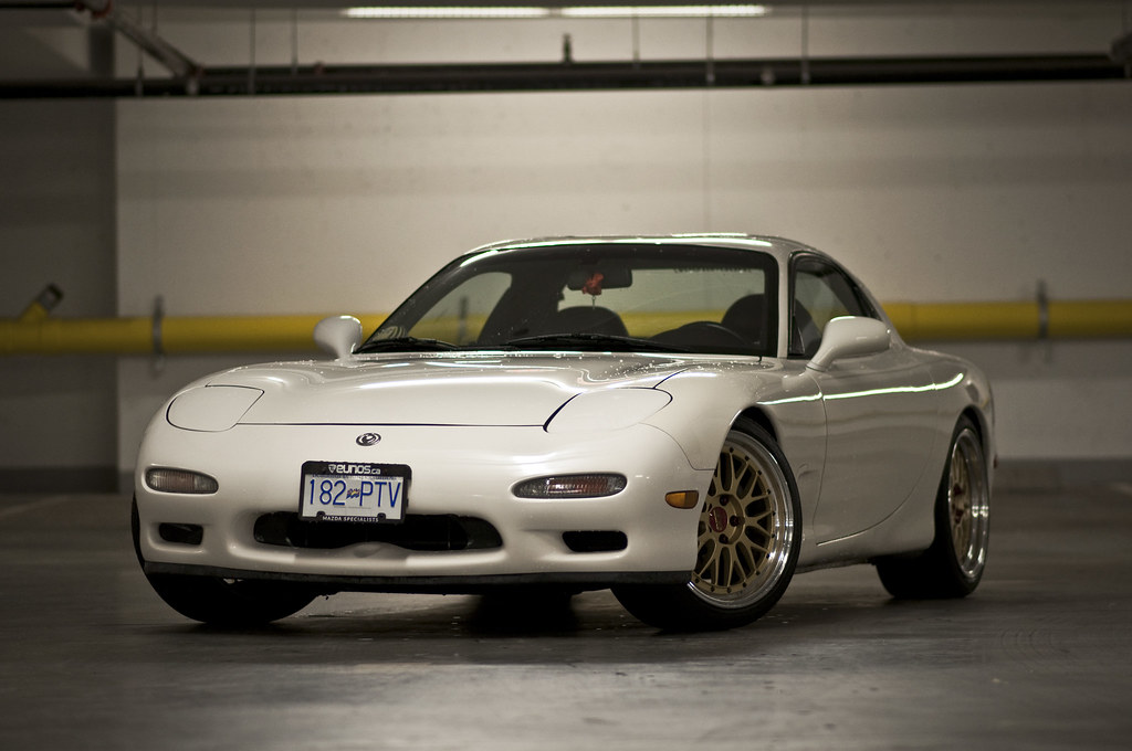

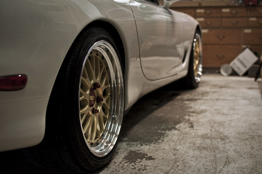

This next car is a co-workers. 1993 Mazda RX-7 FD3S. Insanely fun car and well loved and used, but the paint was in need of a spruce up. The detailer at my dealership gave it a shot but he uses very poor techniques and products and the end results was horrible. My deal with coworkers is $100 dollars and I will clean, polish, and wax/seal the paint (assuming the car isn't gigantic).

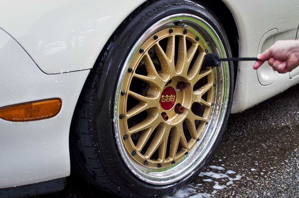

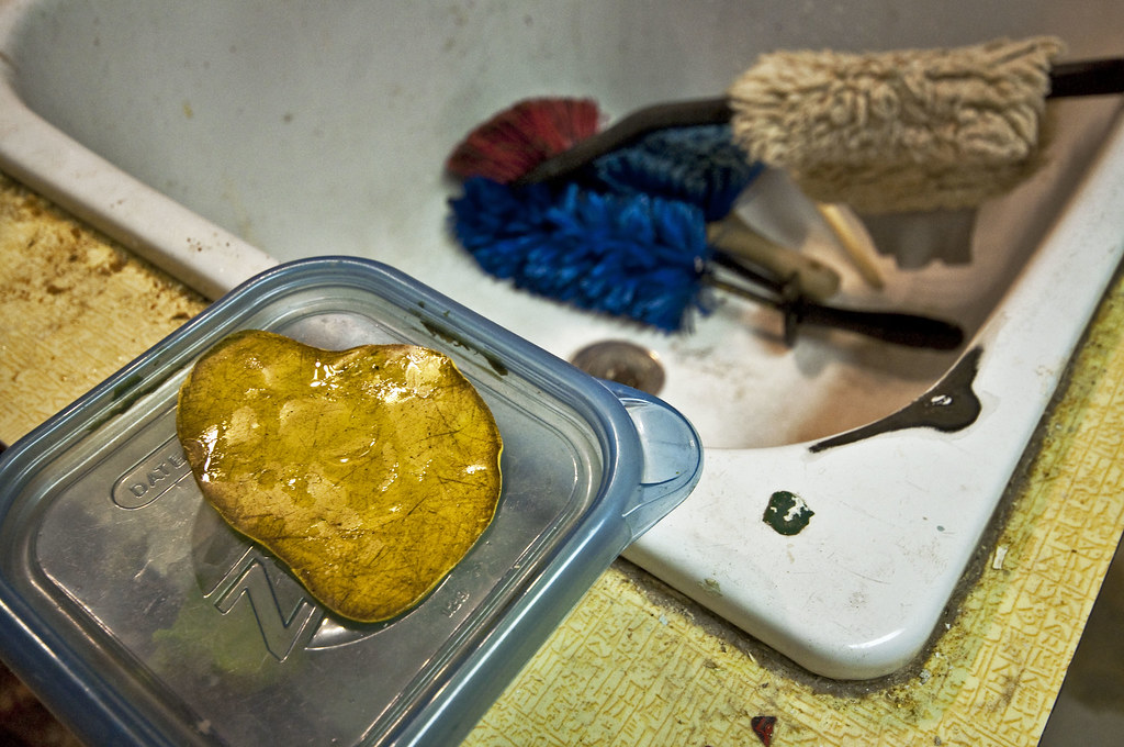

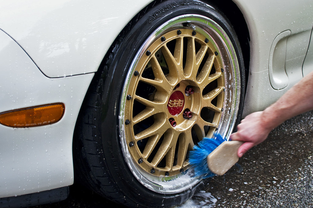

I started with cleaning the wheels. This is some of the brushes I used for wheel cleaning, all with their own purpose.
Small brush to get into the lug holes and around the small cracks on the face of the wheel.
DSC_5997
The large brush is to get the face of the wheels and the tire, as well as the inner sides of the spokes (or as much as posible depending on the rim design).
DSC_5998
The Wheel Woolie (microfiber wad on a stick) is for the inner sides of the face and the barrel of the rim. It is gentle, but the hard pole makes for good scrubbing power. I also have a bristle style brush like this but it's for larger spoke spacing.
DSC_5999

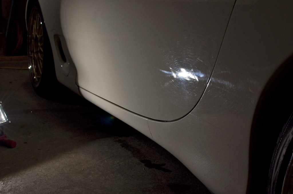

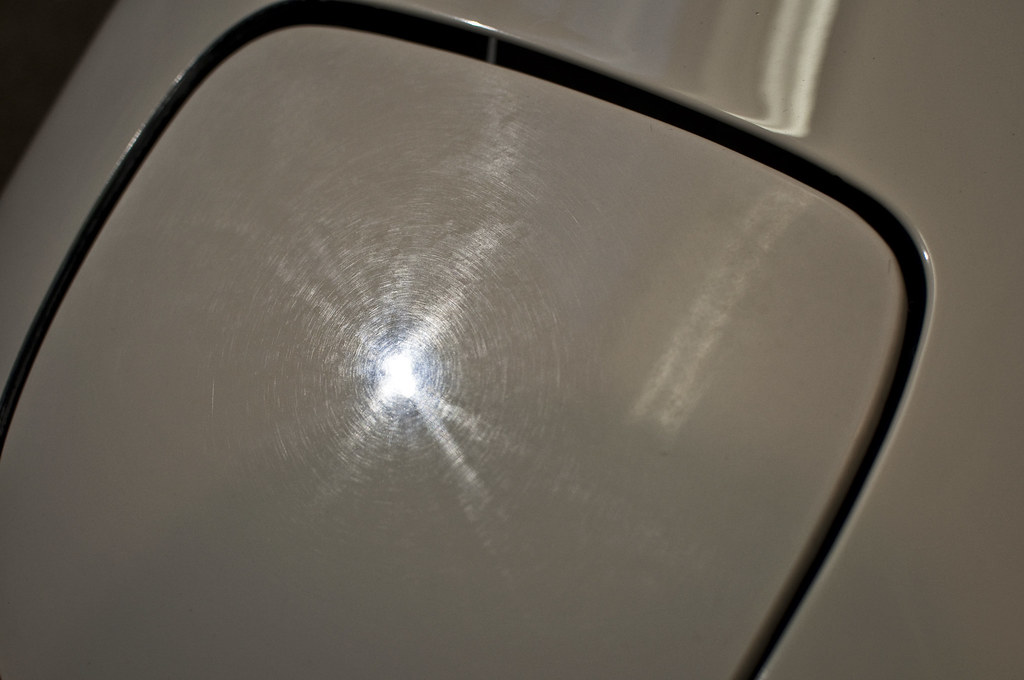

Now, if you consider this car was "polished" less then a year before I polished it, you'd think the paint was nice. It's not.
DSC_6013
But it's not ruined yet. It's single stage paint, and you have to be careful with how aggressive you get, but these are small scratches and not too bad on soft Japanese paint.
DSC_6015
The body was in better shape in most spots, mainly just polishing haze and light swirls from the improper use of a rotary polisher and wool pad.
DSC_6025
But it came up pretty nice.

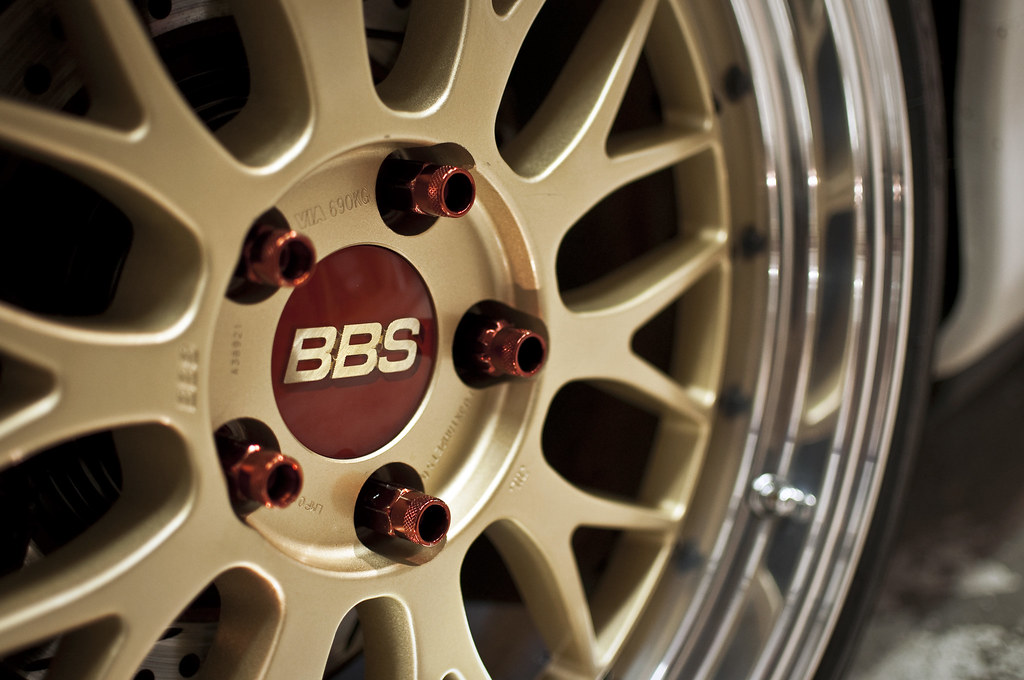

Wheels were also sealed with a special high heat resistant sealant.
DSC_6041
DSC_6042

2. Boil water.
3. Spray APC/Stain remover on to troublesome spots. Use carpet, and preferably Automotive specific products.
4. Apply regular carpet/mat cleaning solution using the Manuf. application procedure (just don't remove anything yet).
5. Add boiling water to mat, distribute thoroughly making sure to get the troublesome spots.
6. Agitate. If you have a brush, go for something slightly firm. Soft brushes will turn to mush in the hot water. I use my polisher with a brush as it saves me the most time.
7. Once agitiation is complete rinse the mat, preferably with hot water. I have a large laundry sink that I use for the cleaning steps (spraying detergent, boiling water application, brushing, and rinse).
8. Once rinsing is complete extract the water out of the mat and check your work. Repeat cleaning steps if it's not clean enough. If you don't have an extractor either a. get one, or b. wring out the mat as best as possible (but get one, they are not expensive and make short work of most carpet stains).
That should help, if not take some pictures and show me what it's like.

What foam gun are you using?
Preferred product line?
I've been getting more involved in detailing my own vehicles (subscribed to Ammo NYC detailing on Youtube) but still learning the basics. My wife, with good intentions, got me that big 10" craftsman polisher for Christmas when I told her I was looking at them (specifically Porter Cable 7424xp).
My truck is similar in size to the Tundra plus in has a canopy on the bed so I know how long it takes to do a vehicle that big.
