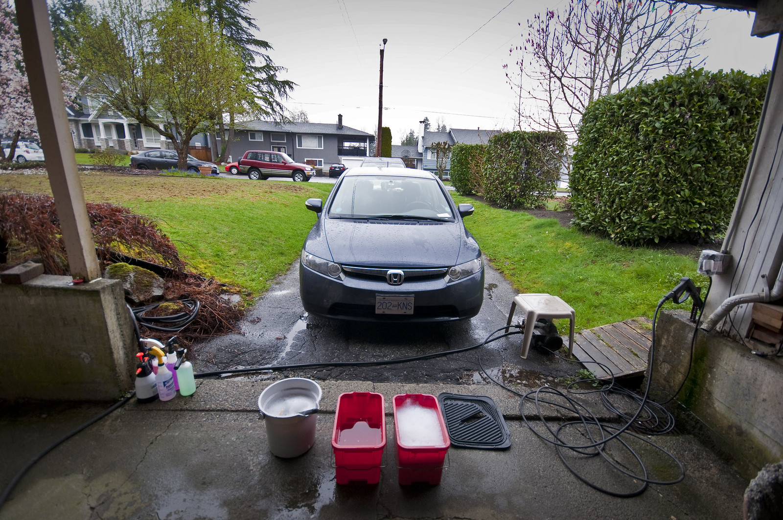

Firstly, the brand isn't more important then the technique. If you use the right brand wrong, it'll be worse then the wrong brand right, if that makes sense. They way I detail is far more in-depth then normal people need to do, below is the steps I would use to do a basic wash with minimal tools and products.
1.) Rinse vehicle down. If you have a pressure washer use it (electric only, and make sure it's not super strong). Pay attention to panel intersections, grills, badges, anywhere 2 pieces meet. Wheel wells and wheels should be rinsed as best as possible before using soap as well, to save the soap for the harder to remove debris.
2.) Pre-wash the car with an APC (All Purpose Cleaner). This should be a car specific cleaner as they are designed not to harm finishes. Follow the dilution instructions to the letter, they know how to use their own product. Apply this product to the lower half of the vehicle, wheels, anywhere with heavy dirt and stains. Front bumpers and wheel wells will need this after road trips for bug removal.
3.) Once the pre wash is applied, go around with a small round brush like a paint brush (again, detailing/car specific, they are a safe bet not to mar the finish) and clean any nooks and crannies a wash mitt won't clean. PAY ATTENTION TO THE PRE-WASH! If it is drying re hydrate it and stay on top of that, some pre-washes will stain if they dry.
4.) Once you've gone around the whole car, rinse with pressure and remove all the pre-wash and debris that comes with it. Pay attention to the soap residue. Do not leave any pre-wash on the car.
5.) Clean wheels. Using a wheel cleaner and appropriate brushes, clean the wheels and tires. Again, follow the instructions on usage and use the right tools. Brushes and Mitts used on wheels should no be used on paintwork, as brake dust has metallic particles and even the best rinsing job will not get it all out.
6.) Wash the car with hte 2 bucket method. This is a simple trick to help keep the soap clean and stop you from rubbing dirt back into the paint. Fill 2 equal buckets with water and only apply the car soap (car specific) to one. This this best for cleaning the paint, and then rinse the mitt in the other. Ring out he mitt before putting it in the clean bucket for the next panel. WATCH THE PANELS! Make sure the soap isn't drying, if so rinse it off and work in small sections.

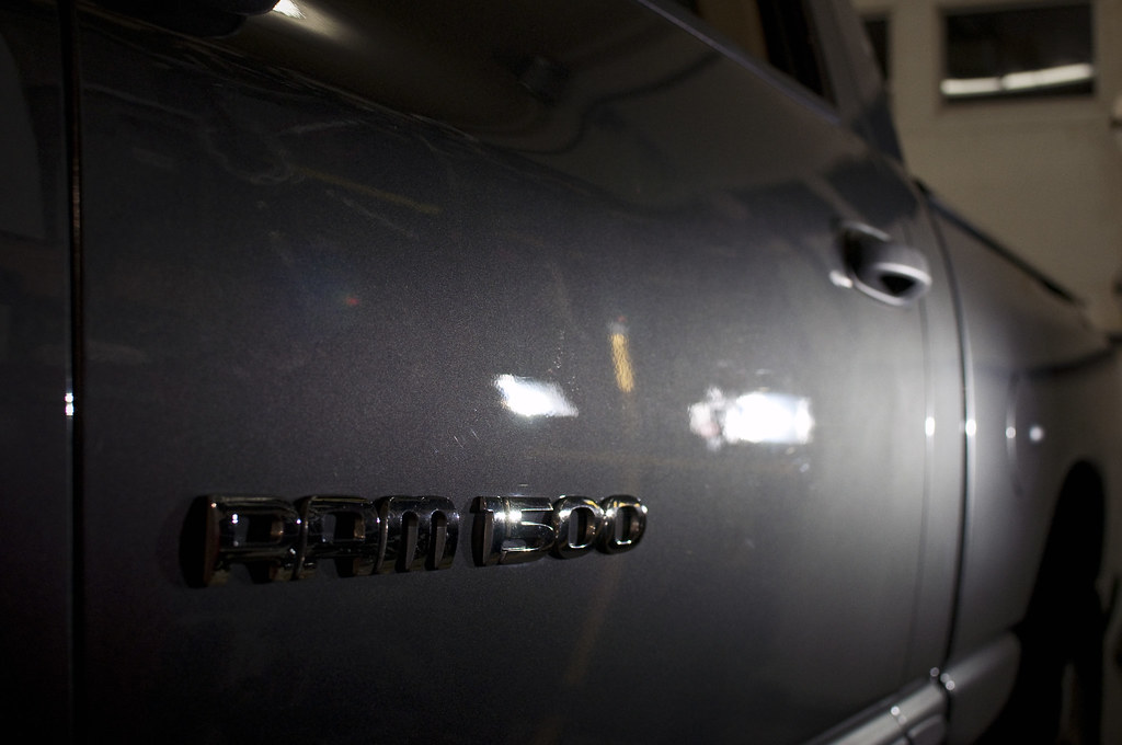

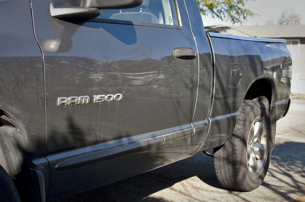

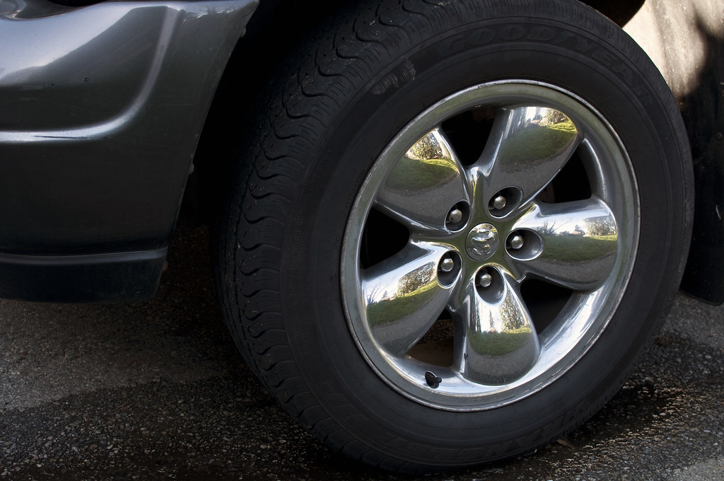

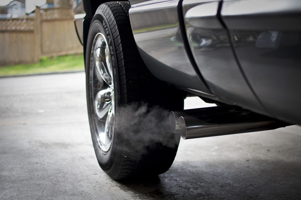

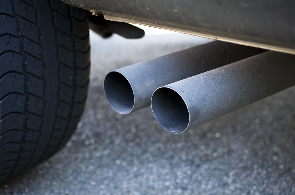

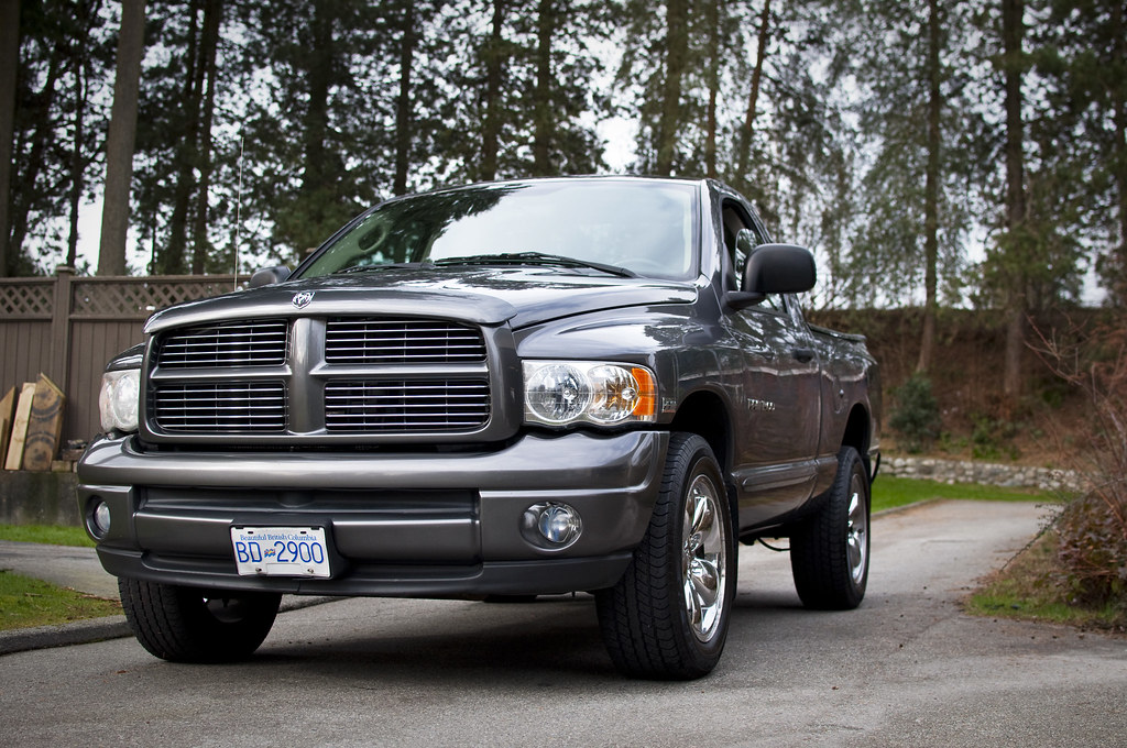

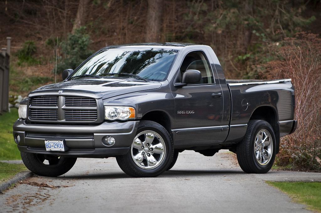

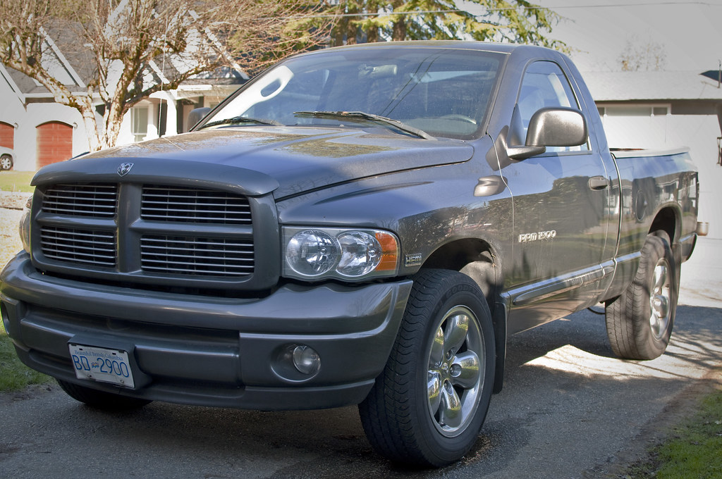

As for the Ram...
DSC_7812 by brianjosephson1, on Flickr
DSC_7813 by brianjosephson1, on Flickr
DSC_7815 by brianjosephson1, on Flickr
DSC_7817 by brianjosephson1, on Flickr
DSC_7821 by brianjosephson1, on Flickr
DSC_7829 by brianjosephson1, on Flickr
DSC_7840 by brianjosephson1, on Flickr
DSC_7851 by brianjosephson1, on Flickr
DSC_7865 by brianjosephson1, on Flickr

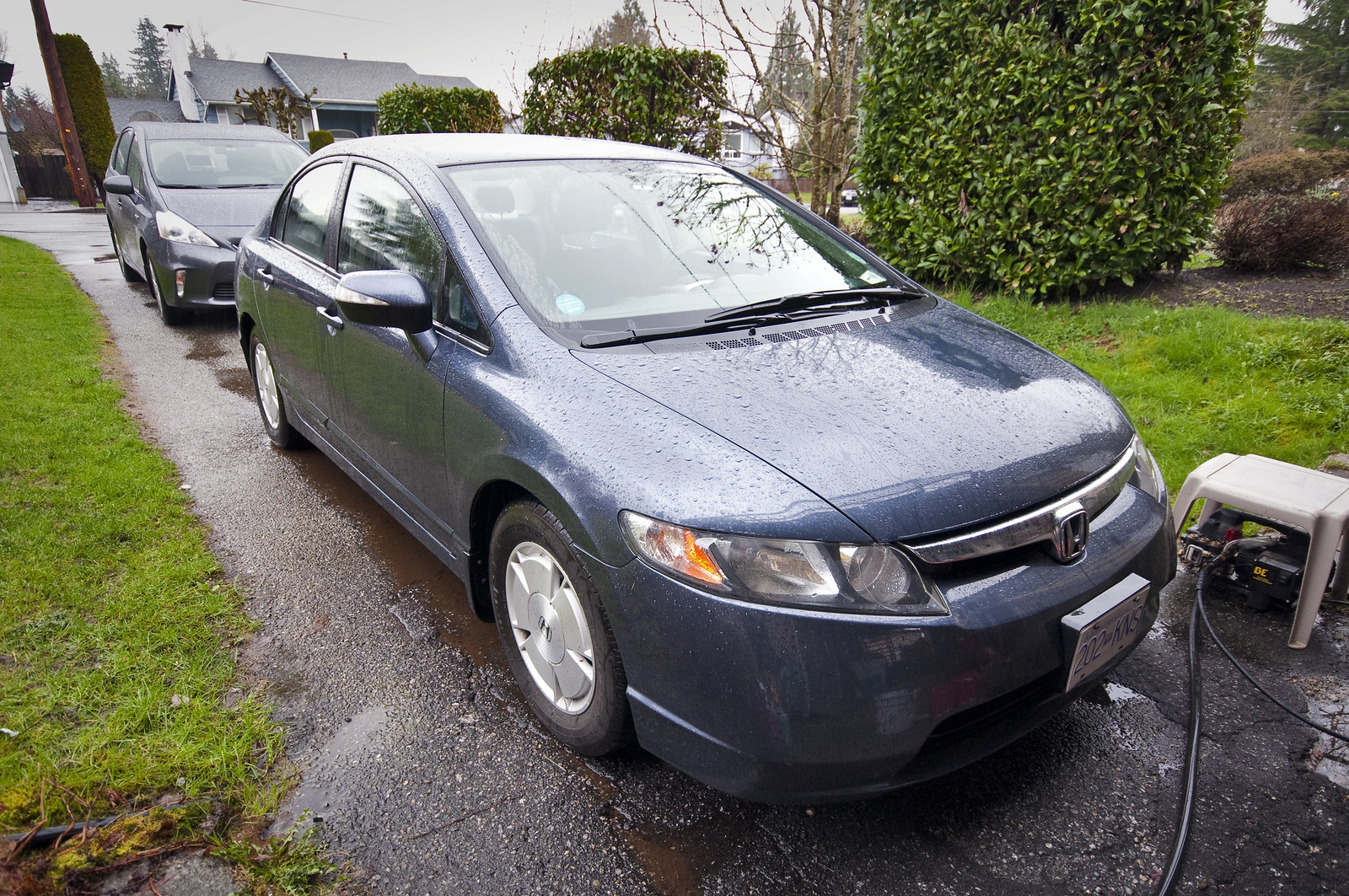

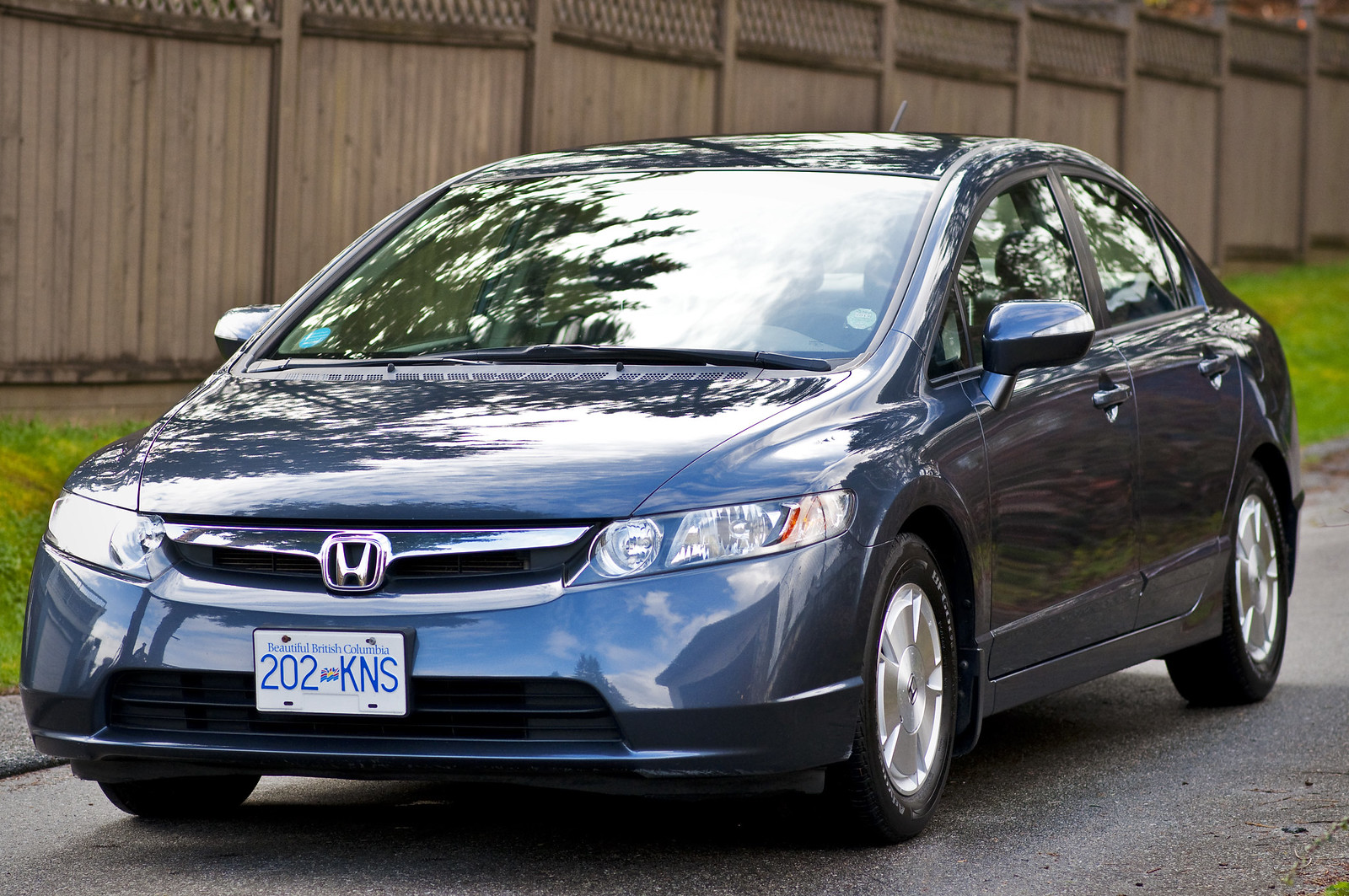

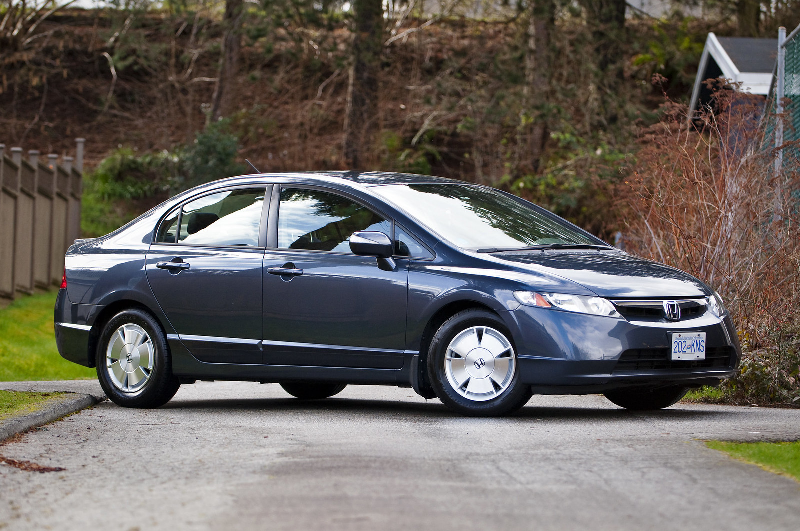

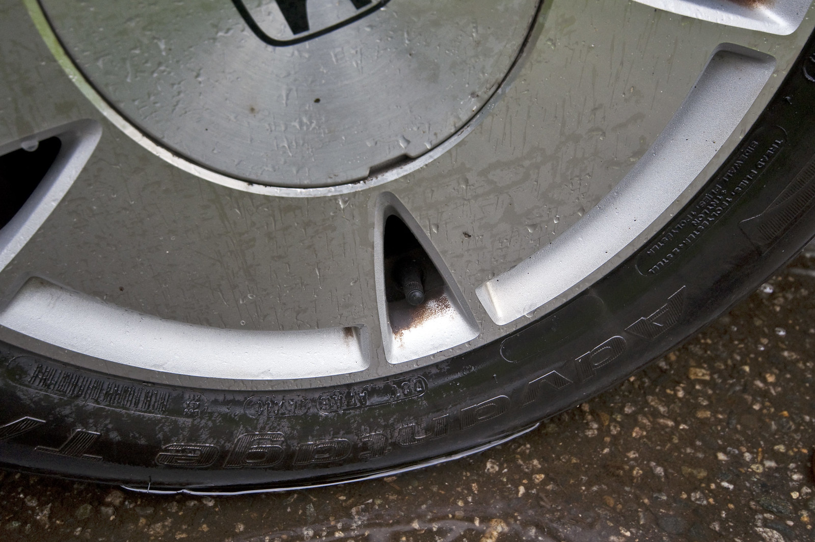

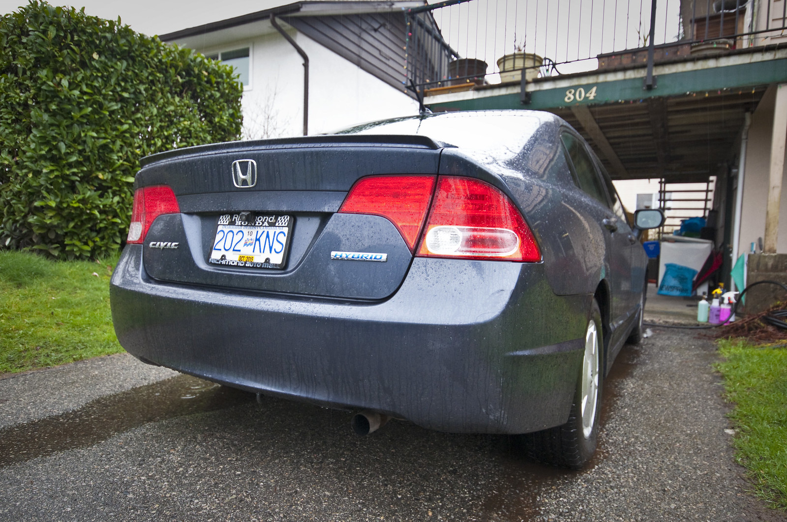

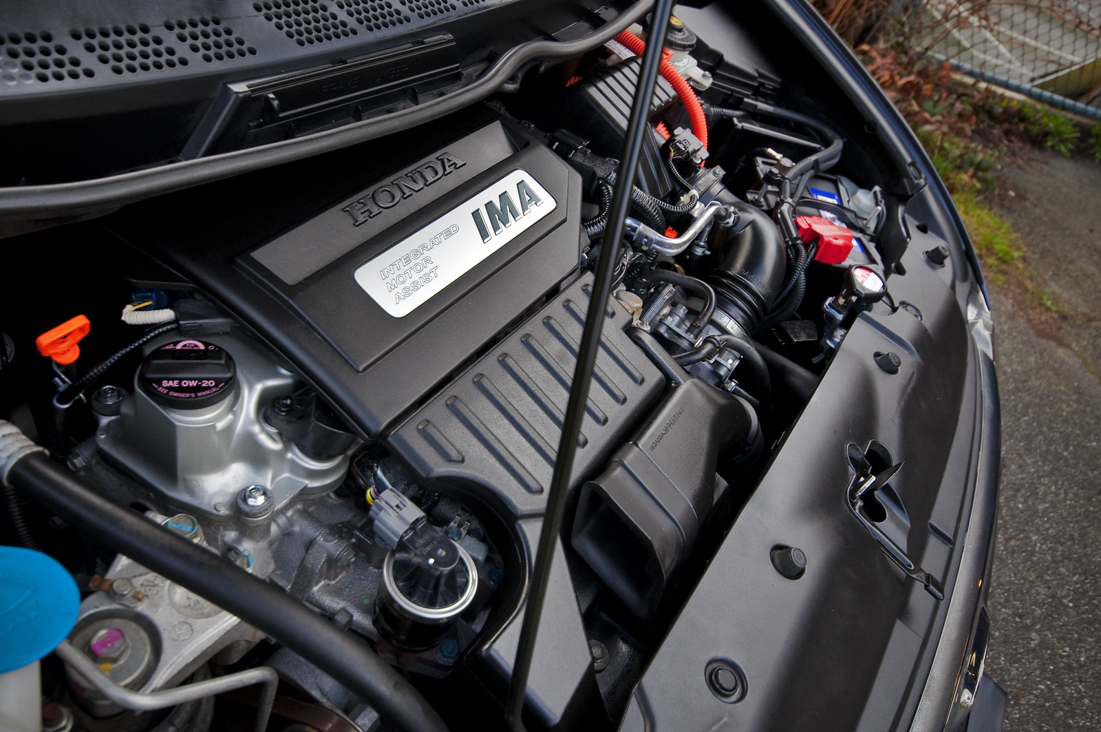

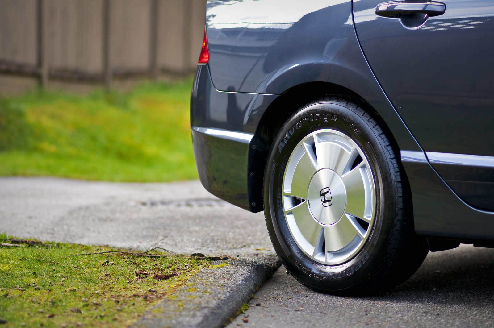

I have one more in the cards, this time we have a Honda Civic Hybrid. I tried to take during photos but the rains started up and I was strapped for time. I will get a thorough how to detail documented soon, but I have a few details coming up where time is a factor.
Enjoy!
DSC_7895 by brianjosephson1, on Flickr
DSC_7896 by brianjosephson1, on Flickr
DSC_7897 by brianjosephson1, on Flickr
DSC_7898 by brianjosephson1, on Flickr
Finished shots.
DSC_7920 by brianjosephson1, on Flickr
DSC_7926 by brianjosephson1, on Flickr
DSC_7950 by brianjosephson1, on Flickr
DSC_7968 by brianjosephson1, on Flickr
