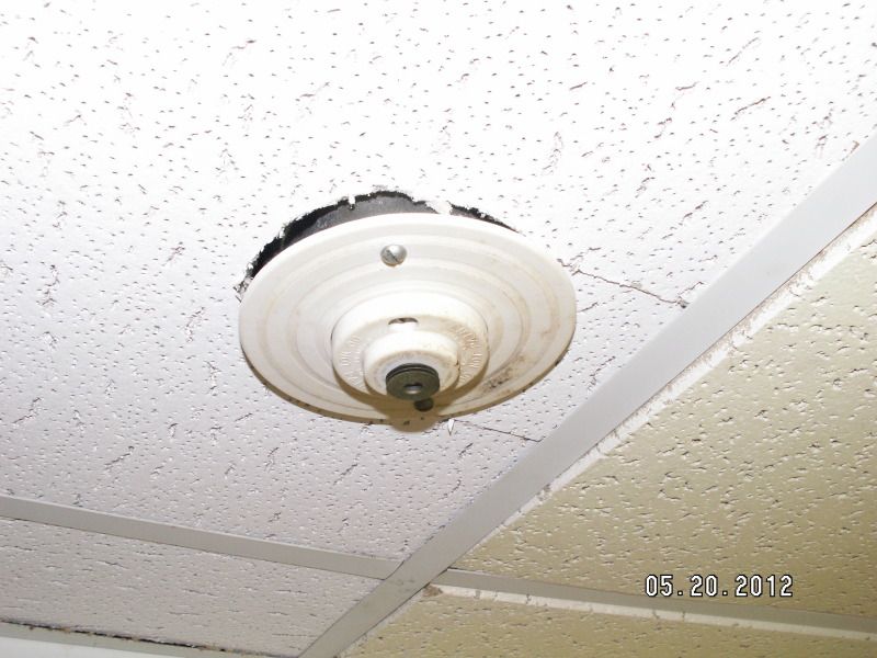

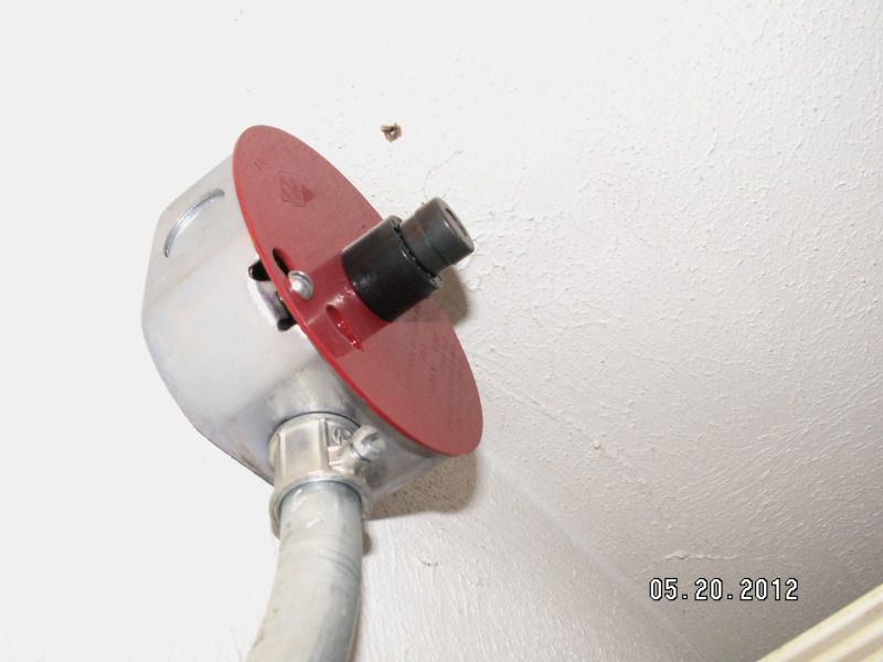

Vacuum the detectors? Okay. I've got three of those detectors somehow. One's for carbon monoxide. I imagine one is tied to the building's fire alarm and I think I need to know how that works for disconnecting/replacing. Like if I disconnect the wires will the building's alarm go off?
I was messing with some sensor downstairs in our laundry room while replacing acoustic ceiling tiles and really wanted to disconnect the wires but instead settled for cutting the tile like an amateur. The J-box isn't on a bracket but has conduit keeping it at that elevation. The old tile dropped below the ceiling by an 1/8" which the replacement does not. At this point I'm just curious if disconnecting the wires would trip the alarm. The more I look at that the more I think that shorting the wires out would trip it.
This one goes to the furnace-A/C disconnect in my utility closet and there's a switch attached to it to power down the fan. I don't like how it's plumbed and I don't like where the switch is so knowing how that works is on my radar as well.
Is there an electrician in the house? :)

Is the building has a monitoring fire alarm panel? If they do, it will only send a trouble alarm to the panel when you disconnect the wires on smoke detectors. I think, if Im not mistaken that your (smoke detector)system is an alarm to the individual room only - not centralize. The pull station is the one that send an alarm throughout the building for evacuation.

The commercial head units you have are different and better than what's used in a home, and have a longer life....you won't find them at the depot.
It gets tricky giving advice, when it comes to a multi-unit dwelling (liability, for all involved)
You've got a heat detector and a smoke. Heat heads in the laundry and furnace. They go back to an annunciator panel and you'd really have to know what you're doing in regards to shunting your zone while working on it.
Different brands switch them as 'normally open' or normally closed' ...so you'd really need to know how that brand handles it.
I'd try to find out the last time the Fire Dept tested them. You could ask them or the building Mgr. I'll bet the FD will come out and test them for free.

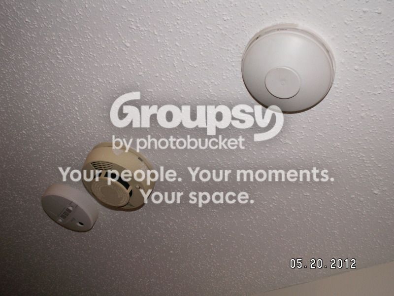

Well, alright! Now I need to figure out if one is enough. Our furnace and water heater are centrally located and the old alarm was on the ceiling in the hallway outside that utility closet. Does the kitchen need one? We don't have a gas stove. I'll probably go with the stand alone unit and mount it in the same place ... unless further reading calls for a change in location.

I don't know what the correct answer is but I have one in the basement with the heater and one in each bedroom so we can hear it. (two of them started chirping recently and I need to get out and get them...thanks for the reminder!)

I found that I'm fine with one. I think I recall Rick saying they were important but that didn't really light a fire under my *** to get the replacement here, but Cheryl saw something on TV this morning and suddenly I'm an expert on on Carbon Monoxide Sensors and their installation. This was a multi national exchange of ideas. It's sad that I'm so subservient. It's been like this since the boys went in that little jar she carries in her purse.

I like to see a co/smoke/combustible gas 3 in 1 detector inside the boiler room towards the door {in homes with gas} USI sells one for $40 or so, a separate co in the bedroom and on each floor, then smokes where ever you can get them... Going a step further a BRK 5120 wired into the fireomatic switch {thats the red cover in your above picture with the small lead melt/break module} with a brk rm4 so when it detects co it breaks L1 going to your burner feed. CO poisoning is a terrible way to go, I have seen it first hand and there is no such thing as being too safe...

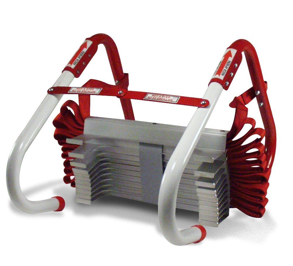

But anyway, even a cheaper system, fire extinguisher on each floor and in kitchen, ladder in each upstairs room, smoke/co's in every staircase and hallway you can spend under $200 and be much safer... Also the even the best system in the world can be worthless with out a plan, I go over it with my kids a couple times a year, let them use their bedroom ladders, check everything out, change batteries, ect... If the alarm goes off, they know, check their bedroom door, check for smoke, look into the hallway {the emergency lights will be on if the alarms are sounding at night}, if there is smoke they go out the window, if they can get to one bedroom I prefer they both go out one so they can help each other, then after outside they know our meeting spot, and they are to wait never go back in... I have fire drilled them and they seem to be prepared, they can get out of the house and down the ladder in under 120 seconds, now in an emergency where they see smoke and don't see me, I don't know but at least they will know what to do... I have my own plan too for me and my wife, my bedroom is at the end of the hall, so in case of a fire I am going to my sons room which is at the end of the hall on the other side of the house making sure my other son and wife are with me and we all go down his ladder...
Hopefully we never need this stuff, but the house I grew up in burnt to the ground when I was 14, we lost our dog, cat, and house... My parents rebuilt on the same foundation but we had a fire plan and drills after that....

I would keep it in the old location just outside the utility room is best. I don't like putting them in the same room as the furnace. The reason, in some instances a negative pressure could develop.
It's caused by kitchen and bath exhaust fans, clothes dryers running simultaneously with the furnace and gas hot water.
That, combined with a windy day; it's a false alarm waiting to happen.
If you have an empty outlet in the bedroom, that's a good place for a second plug-in type.
