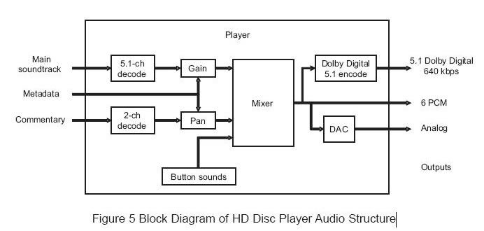

Here is how audio is used in HD players
So in this situation the best quality signal is the 6 channel PCM(so your receiver can apply bass management and room correction etc.) or analogue
