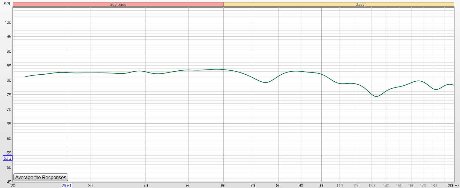

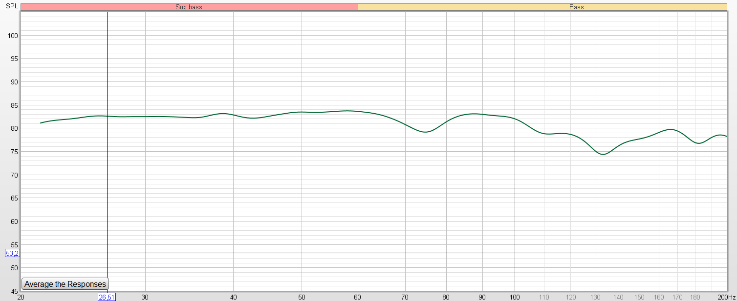

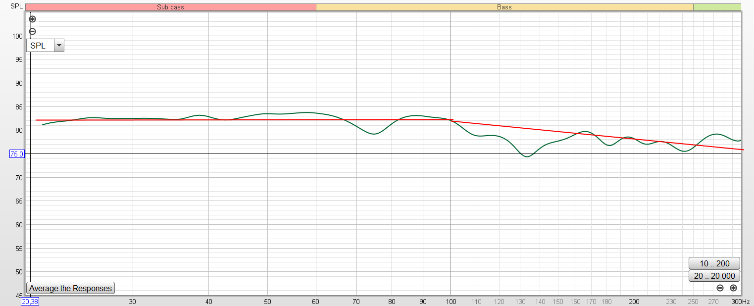

I can't argue with what you say, but the wall behind the speaker is obviously part of the room. However if you are going to design a speaker to be used near a boundary, then it requires adjustments in design to minimize it. (..)
One of the huge advantages of DIY, is to be able to customize designs to the architectural considerations.
So yes, I believe it is a room effect, but still one that needs correction if the intent is to have an against wall design.
As you point out above (my bold / emphasis), you can't expect a commercial speaker to perfectly mitigate any room problems in any room. Not trying to be defensive here, it's just simply not possible. That's also not what we claim to do. We claim this design will reduce SBIR effects compared to a traditional speaker, which it will. Look at any "share your frequency response" thread on this forum or elsewhere, and as I'm sure you know you will see the 100-300hz range typically look wildly uneven and with both more and wider dips than this response.
How this looks in any given room is not only dependent on the speaker and the distance between speaker and wall, but also where the listener is situated.
Here is the same speaker in a different room (still no smoothing). As you can see the 100-200hz range is still what I'd say is significantly better than what I typically see, but completely different than the room I posted earlier. This time with only one dip, but a wider and more shallow one.

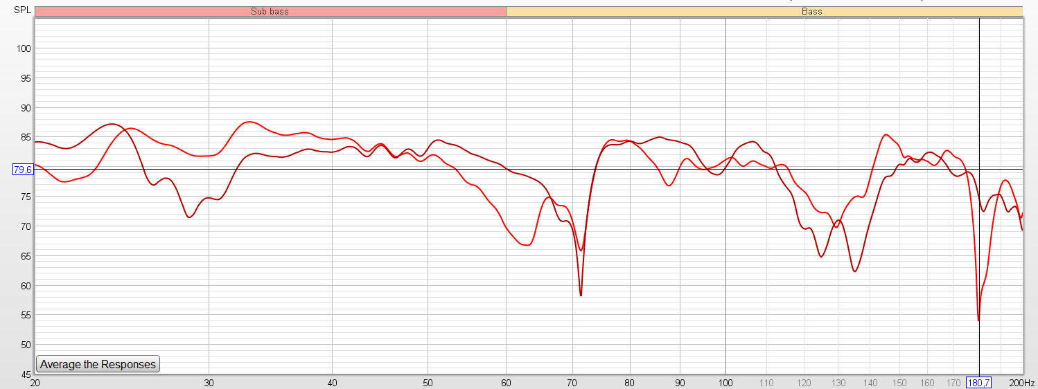

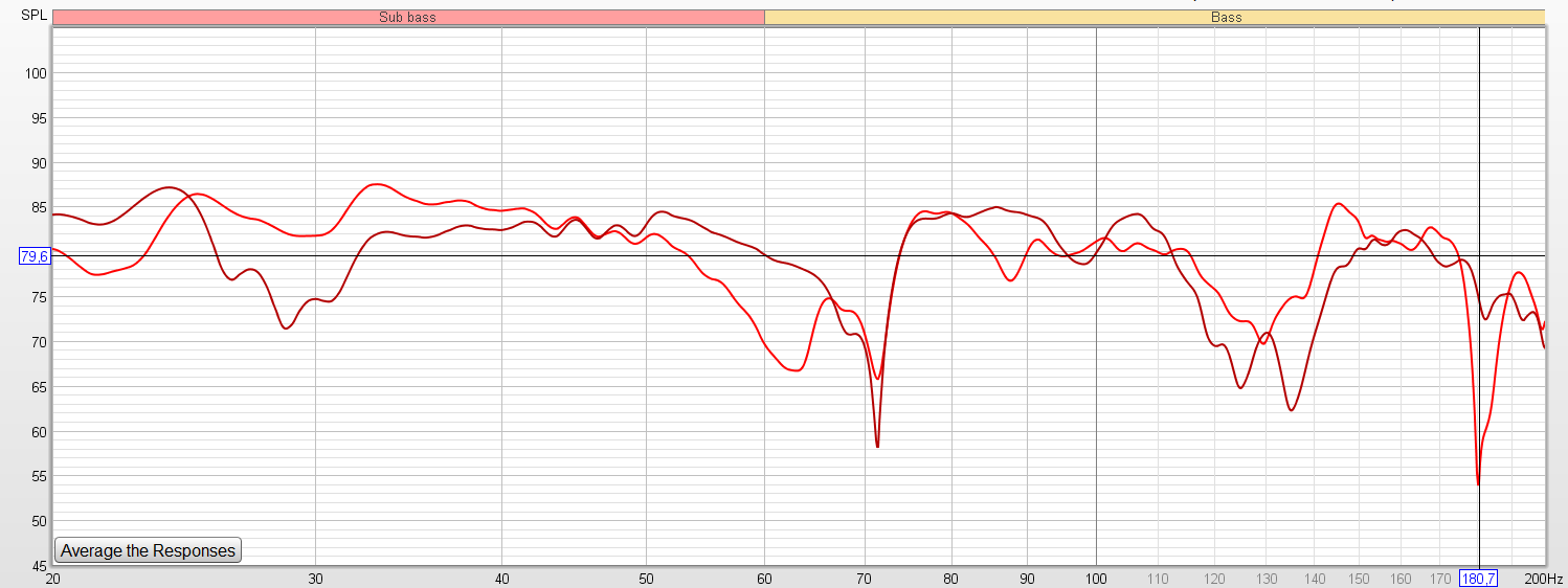

Here are two graphs from a different speaker (not the Mantas). Both graphs are of the same speakers in the same room, but taken from different listening distances. Here we see a more typical and pretty wide dip between 110-140hz. We can also see that there are similar trends in both graphs, but they're not identical. What's also interesting is that we see a dip similar to the one you mentioned at 180hz in one of the graphs, but it's completely gone in the other. The speaker is the same and the speaker distance to the wall is the same, the only thing that moved is the listener.
Just another example to show how it's not really realistic to expect perfect response out of the box from a commercial design when whoever designed it (whether it's me or someone else) has zero control over the situation where the speaker is used by the person who bought it. :)

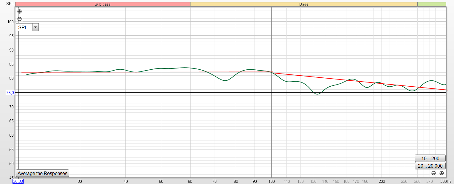

@TLS Guy We may be misunderstanding each other here. I don't challenge the suggestion that the dips are from the back wall, I challenge the idea that something can be done with it (without causing something else instead). :) As mentioned it's not just the speaker and the walls that are part of the system, also the listener. This measurement is specific to my listening room and will look different if I move the microphone closer or further away from the speakers. It wil even change if I move it closer to the floor or closer to the ceiling. And if I do nearfield measurement (0.5-1m) there will be no dips at all.
As an end user of our products you will not have individual control of the drivers, but you will have access to a 9-band EQ that includes both boost/cut and shelf filters. You have access to this for each individual speaker and for each individual subwoofer. If you are person who have access to and competence to use measurements gear, you are also free to move your speakers around (including moving them further or closer to the wall) to maximise the effect of the cardioid pattern in your specific room. Or of course do this by ear if measurements are not available. If you in addition to that have the luxury of moving your listening position around, there should be a pretty significant chance of getting excellent sound. Most do not, but they will still benefit from the cardioid system and get better and more even midbass response than with most speakers.
In summary It's unclear to me specifically what you think should be done differently, but I'd be happy for you to share that feedback. :)
Also again please note that the response shared was with zero smoothing, while you present graphs with significant smoothing.
Here's the same graph with 1/6th smoothing:

I'm not sure what should be done differently. The issue is that boundaries are a problem for speakers, especially when they are close to them, or actually in a boundary. That just presents an added problem. That is not to say that I disagree with your plans to pursue more elegant and architecturally friendly designs for audio in the home. Quite the opposite in fact, I applaud them. I think actually this is a more common problem than realized, and leads to subs being overdriven and an unnatural balance.
However, that trace with the smoothing is actually more revealing then the previous ones. This is because it gives more information about the energy liberated into the room from a crucial power band. You can see there is an 8db. drop between 90 and 135 Hz. The smoothing reveals this to be not so narrow in scope. So it reveals a drop in output between 90 and 165 Hz, which is the best part of an octave. I personally think that will be audible, and make the bass foundation of an orchestra, or even a piano or string quartet weak in its foundation.
So to answer your question more specifically, I think the first step is to repeat these measurements in more rooms, and see how peculiar the problem is to your room.
If it is not particularly specific to your room, then I think the cause needs further investigation. I understand the system has an equalizer, however correcting that anomaly will add significant power to the bass driver. I understand that there is lots of power at hand, but adding that much power to the driver is of concern. This gets into the area of use and abuse of equalization.
That is all a round about way of saying the issue is worthy of further investigation, and if possible correction.

@TLS Guy With all due respect you're getting this all wrong. The target curve here is not flat from 20-200hz. The dip between 100-160hz is mostly ~2dB below the target curve and ~5dB at most between a narrow range of 130-140hz. Yes this may be audible, but that's not the point.
We're discussing the response @ listening position in one room. This cannot be taken account when designing the speaker itself, it's cruicial to differentiate between tuning the speaker and tuning the room. I cannot account for individual room issues in one particular room when tuning the a speaker for commercial production. The point of sharing the graph was to show that the issues between 100-200hz in this particular room (and also in a different room that I shared response from) is less than what you typically see. Individual problems shown in these graphs (again taken at the listening position) cannot be used to evaluate the speaker or the commercial tuning of the speaker. I explicitly leave these types of problems be while testing and developing speakers to avoid falling into the trap of correcting for the room.
The proper way to evaluate if the cardioid effect is working properly and evenly is to measure this in an anechoic chamber, which we have done with the previous prototype and will with the new one as soon as that arrives. It has not yet been done with this prototype because we're waiting for the next, but since that has been delayed I'll consider doing that some time before Christmas.

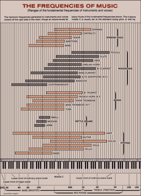

I think one of the issues a speaker designer has to really understand is where to put and distribute your power resources. I can not understand why this is not discussed more often, as it is crucial to making a robust design.
The starting point has to be the distribution of the fundamentals of musical instruments. Of course the fundamentals demand the largest portion of the power as the higher fundamentals demand progressively less of the power.
As you can see a huge number of instruments have fundamentals in that 80 to 400 Hz range.
Now this is in the area where with narrow cabinets BSC needs to be applied. So this greatly increases power demands in that, what I call, the foundational region.
