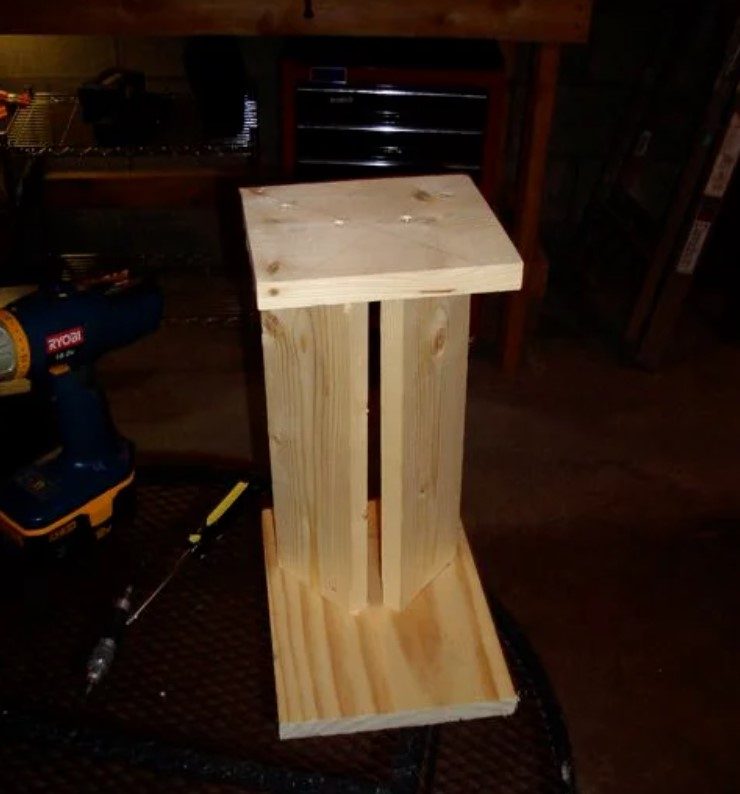

One idea for speaker stands I have always liked is inward facing planks. Here is a version:
Obviously, that could be made to look a lot nicer, but you get the idea of the basic structure. It is very simple but very solid and doesn't take a lot of material to safely hold a lot of mass. Metal or wood could be used. For looks, you could use different finishes, or vary the thickness of the columns or their angle. There are a lot of ways to adjust this design, but it will still be strong.

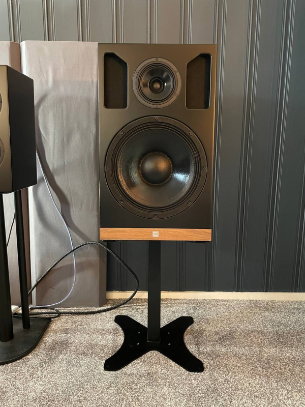

We showcased the prototype at a Norwegian hifishow this weekend, here's a few pics :)
1664197644005-png.852329
The reception was great! People really liked the design and thought it looked even more awesome in real life than they had seen in pictures. They also liked the retro loudspeaker stand, so I guess we need to go with something along those lines (we're looking into an alternative design now, but perhaps we'll just drop that). I guess the sense of space (width / depth) as well as the pinpoint imaging was what was commented on the most. Also the versatility with regards to handling different genres. Several also commented on dynamic capacity and the effortless delivery, not suprisingly.
I recall you said you wanted something more subtle under the speaker but I would counter that the frame highlights the natural wood band rather than detract from it.
That shot above gives a great view.

Yes, I was testing (3D mockups) a design where the speaker rested on a thin 5mm steel plate so that the speaker itself seemed to float in the air, with a single column going down. Now I'm thinking maybe have the same design as this existing retro stand combined with a steel plate for the speaker itself, so that you keep the floating effect but with the current retro stand below. You would no longer have the frame along the wood then, though. :oops: We'll test it in 3D mockups and see how it looks.
I also think that stand looks very good. Stands like that should not be way over the top either. I think that stand gives it a pro look. Of the people who visited, did any talk about placing hard cash for those speakers?
