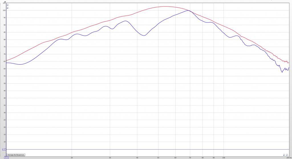

I've got my 3M Optime 105 ear muffs on while I give this thing a proper torture test. Then I'll try and grab another measurement to see if anything is different with a warmed up driver.

Have you tried the measurements in car? You will get a significant transfer function bump below 40hz which will greatly balance your response. I am not surprised by the peak in response in free air as that is a small enclosure for an 18" driver.
The measurement pretty closely matched what I had modeled. I haven't been able to do anything in the car though since the kid said he needed the sub for the guy to wire up the amplifier and I haven't heard from him since so in car measurements may or may not be possible.

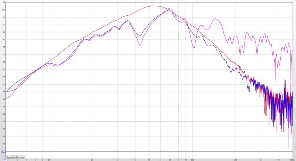

I would be interested to see what you get in the driver's seat should the opportunity present itself.
Gonna try to grab a measurement today. The only hiccup might be that the inputs for his stereo are on the rear of the unit. If I can't get to those I'm going to have to figure some other way to get a frequency sweep to play and then I'll have the issue of timing it correctly with a REW capture.

It was far from an ideal sweep, since I had to use a CD and it lasted too long and I had to mess with REW to get it to capture for the length of the sweep I downloaded. However, here it is.
