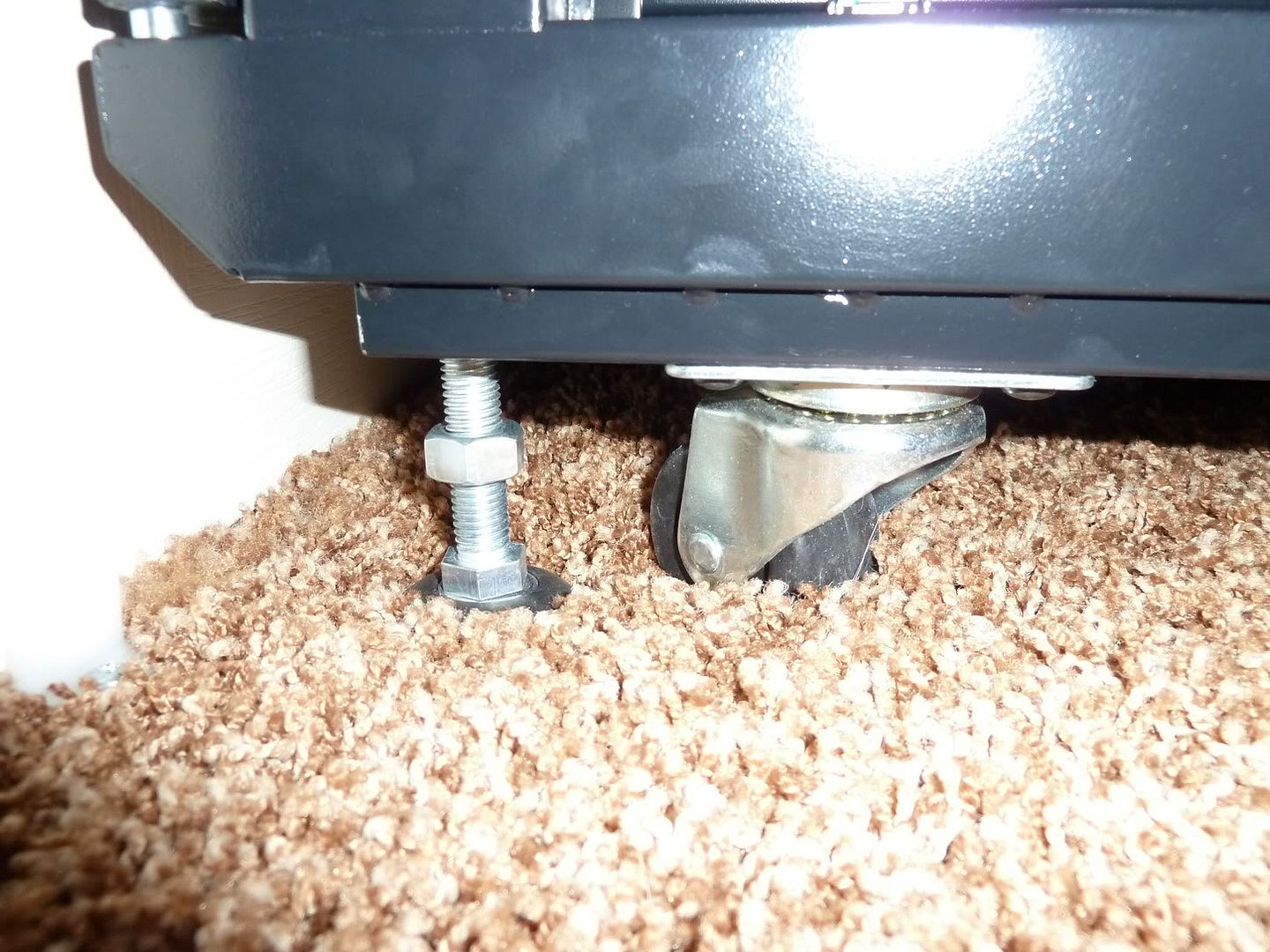

The only assembly that was actually required was to attach the heavy duty casters and leveling feet. They went on relatively easy and they are beefy enough to handle anything you can throw at it. Instructions were pretty much useless, but I had no use for them anyway, as everything is pretty straightforward with this thing. It was strongly recommended to always use the leveling feet for stability and safety once it is positioned, rather than allowing it to rest on the casters.

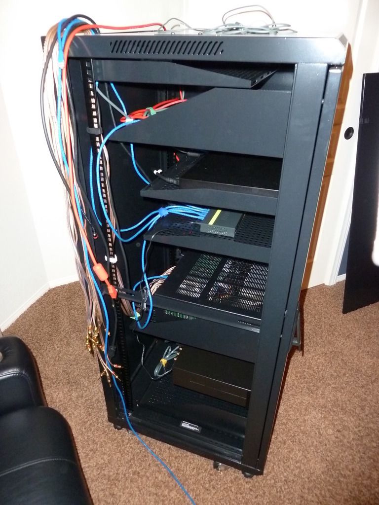

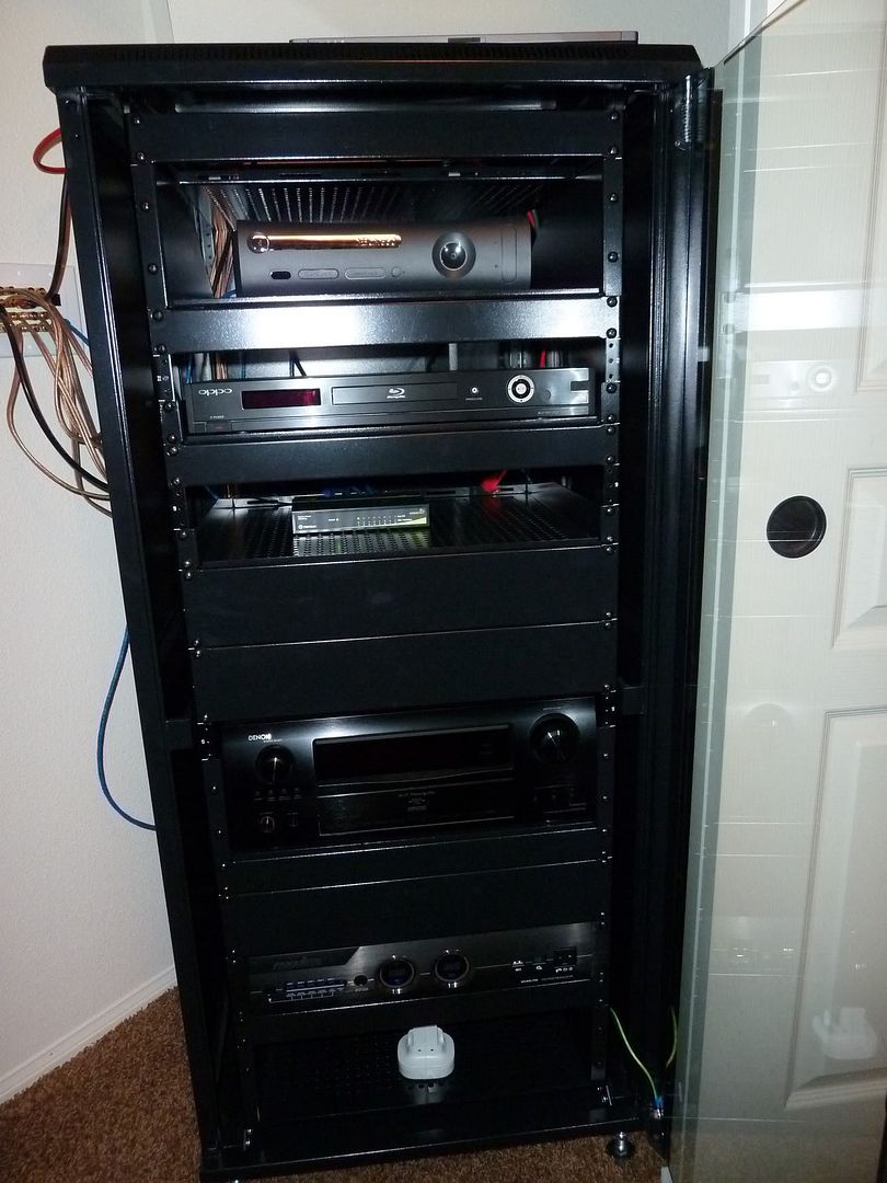

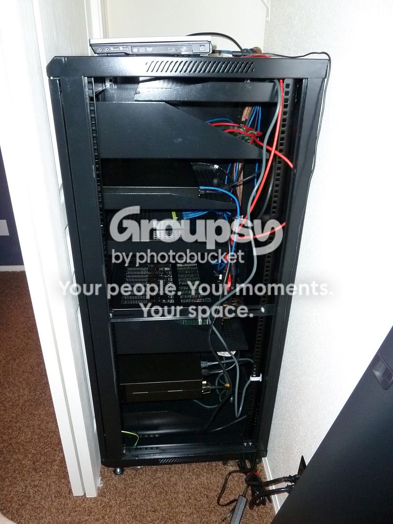

I got all of my gear installed and wired up, and the little cable management that I did was a breeze (I could have probably done a bit more, but I was ready to get things up and running). There are plenty of locations for velcro straps or zip-ties to keep things neat, as you can see.
Also, the side panels release with ease. Two spring clips release each panel. These can be removed for extra cooling, further wire management, or any other occasional adjustment that is necessary. The back panel screws on with 8 screws, so for post-setup tweaking, the side panels and the front give the quickest, most painless access. As a side note, the side panels may rattle if the system is cranked up, but if so, this will be easily remedied by some foam bumpers around the panels.

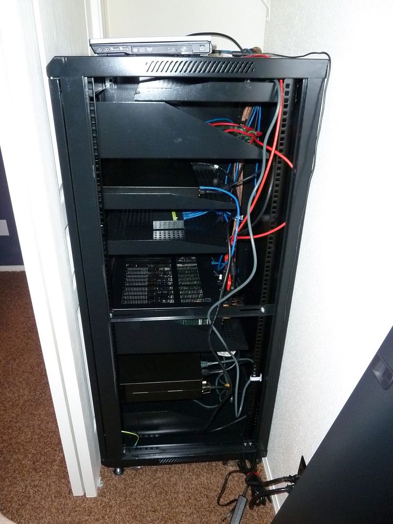

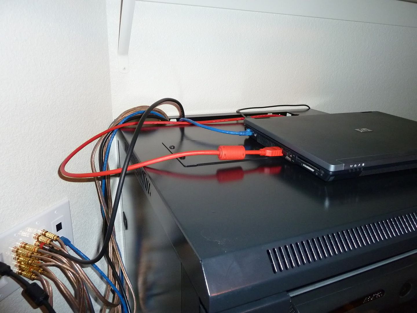

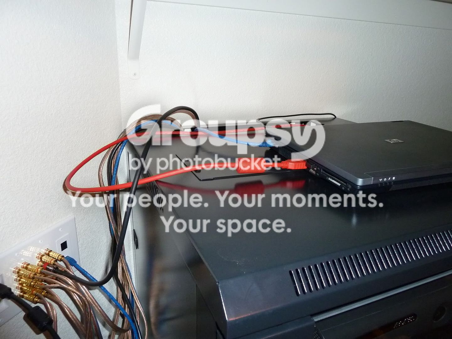

With the gear installed, it was time to put it in its final resting place. Unfortunately, I had about zero clearance the rack in the closet, and I was forced to move all the wires from exiting the small holes in the back frame to one of the removable panels on the top of the rack. These panels are also needed if you have cables that are too big to fit through the small wire holes in back (as was the case for the ferrite cores on my HDMI cables). The results are not quite as pretty with all the cables coming out of the top, but that was my only option and it works quite well. There is also an identical panel on the bottom of the rack, and also a larger panel on top that can be removed for extra cooling or wiring.

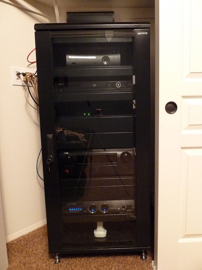

Speaking of cooling, there are vents on the face of the rack to allow natural convection to pull any heat up and out, and all the shelves are perforated to allow air flow. I will see in time how effective this is (coupled with the wire panel removed) once things get fired up in there.

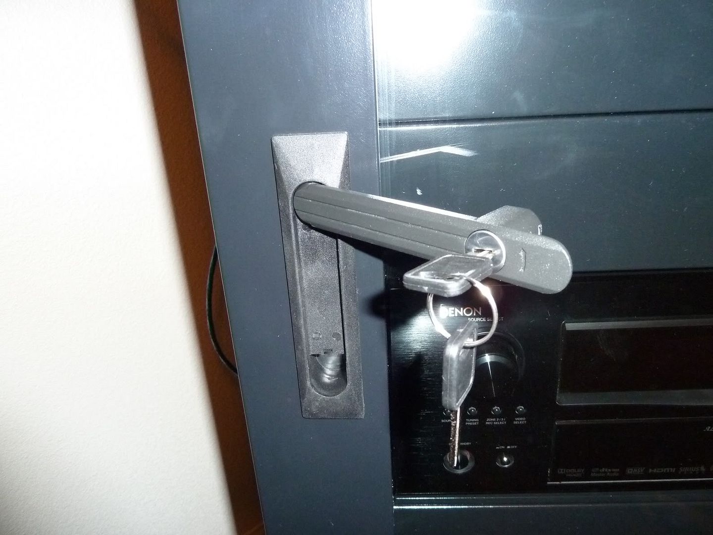

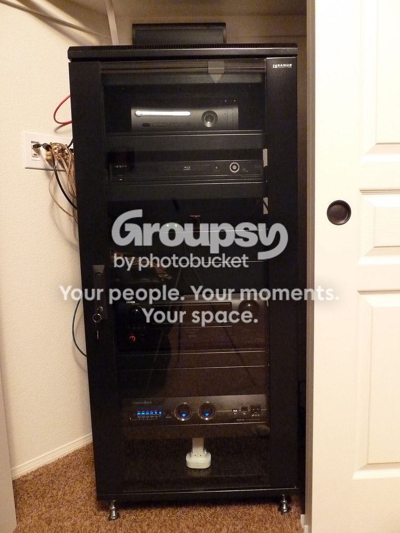

The glass door in front has a locking handle to provide a little security and safety.

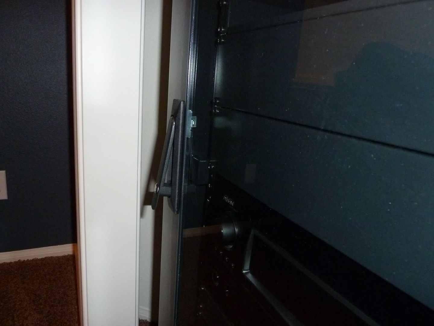

My only gripe is that I cannot leave the handle unlocked, as the key cannot be removed in the unlocked position and the handle will not set back into the door with the key removed and in the locked position.
This causes issues for me because of my absolute zero-clearance between the rack and the closet door.
Overall, I think this rack is a great value and includes everything one needs to get their system set up, and it looks great, too! Build quality is also excellent. It is far more solid than I expected, and I have very high standards (aka enginerd/quality snob). There is also plenty of room to fit almost any amount of gear one could collect, and enough removable panels to keep that gear cool. I would definitely give it my highest recommendation!

Thank you for the thorough review and positive feedback on the Sanus CFR127 AV Rack. Sanus has invested a lot of time observing and interviewing installers to design our Foundations AV Rack series. Utilizing continued feedback we will continue to refine and develop products to meet our customer’s needs.
Based on your and other feedback, we have implemented a design change to address functionality of the key lock. CFR127 racks produced going forward will have the ability to remove the keys when in the unlocked position.

I would be very interested in a new lock/latch mechanism once your design changes are implemented, so keep me posted on that. It does not appear that it is too difficult to change out.
