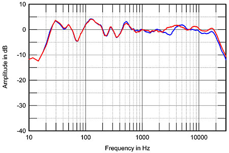

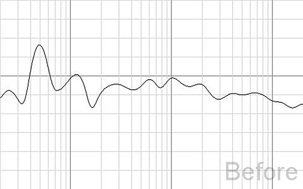

Nearfield, but not actually in room. In room, they'll all pretty much suck, as will any "full range" stereo speaker pair, though the Orions will be the least worst of them. The heavily-smoothed in-room measurements Stereophile published of flagship Revels in Dr. Fred Kaplan's room are illustrative.
See also Audyssey Pro's highly-smoothed (but at least spatially averaged) in-room measurements of KEF Q900's in one of Prof. Kal Rubinson's rooms, also from Stereophile:
By contrast, a dipole offers more pressure sources, and will be smoother. While I haven't seen measurements for an Orion, here's a representative in-room measurement (again, heavily smoothed) of dipole bass from a Jamo R-909, again in Prof. Rubinson's home and reported in Stereophile, which shows the influence of one major mode but otherwise fairly clean performance:
