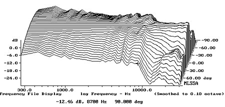

***As for the measurements, I'll ask Jim to post the off-axis stuff, just for you, even though you're "hatin'" on his stuff.
Dr. Murphy already commented on the poor directivity control at the bottom of the tweeter's passband. See below:
***I'm pretty sure they would show a slight elevation in the lower highs significantly off axis horizontally (40 degrees and more), due to the superior horizontal dispersion of the tweeter.***
We just disagree as to the relevance of that acknowledged problem. Which is fair enough. And depending on how high the mid/ribbon crossover is, it may in fact be sonically a very small problem at best. (The lower the crossover, the more deleterious a "mushroom cloud" polar pattern is.)
As an aside, I do agree completely with what Dr. Murphy wrote in the rest of that paragraph: "I'm not convinced that it's worth building in a saddle in the on-axis response in order to achieve a mathmatically perfect summation of the polar response of a speaker."
Clearly, the proper answer is not to hack up the crossover, but to physically control the directivity of the tweeter at the bottom of its passband such that it matches that of the next driver down at the top of its passband. That's what Revel does, with the EOS waveguide. That's what KEF and Tannoy do, with (respectively) the Uni-Q and Dual Concentric drive-units. That's what Danley Sound Labs does, with the Synergy Horn.
Gotcha. Although, Revel's Salon2 doesn't stay flat off axis in the same range Dennis was talking about, right? There's a rise at 3KHz. Or am I misunderstanding?
45, 60 and 75 degrees off axis:
Average of five measurements (up, down and left and right):
For comparison, here's the Philharmonic 2, which uses the RAAL ribbon tweeter:

Gotcha, though I'm not sure how it applies to an off-axis measurement. Revel's Salon2 doesn't stay flat off axis in the same range Dennis was talking about, right? Or am I misunderstanding?
No, like any good controlled-directivity speaker the big Revel progressively rolls off off axis, while keeping the same general response shape through the mids.
With the Revels, the pattern holds until about 10kHz, where things start narrowing due to the size of the tweeter's piston. From Stereophile:
In my experience, I can tell at a glance if there's a chance I'm going to like a speaker or not by looking at such a graph. If it displays a mushroom cloud midrange*, like the horrible-sounding and overpriced Magico speaker whose horizontal polars follow (again from S'phile):
then there is simply no chance I am going to like it. If the horizontal front hemisphere measures smoothly, like the Revel above, or the KEF 201/2 below (S'phile again for internal consistency):
then it's probably worth a listen.
That said, there's a good body of research that suggests off-axis holes in the response are little cause for concern. While that may be (read: probably is) true, the same is certainly not true for peaks of the type I'm discussing.
*"Mushroom cloud" is the term I use, because that's what a spectrograph of the response would look like.

… In my experience, I can tell at a glance if there's a chance I'm going to like a speaker or not by looking at such a graph. If it displays a mushroom cloud midrange*, like the horrible-sounding and overpriced Magico speaker whose horizontal polars follow (again from S'phile):
Is the "mushroom cloud midrange" that you describe, the peak centered somewhere between 3 and 4 kHz as shown for the Magico speaker?

Just a few comments. There may be advantages to wave guides and horns, but they can also introduce colorations. I'll be working with a controlled directivity design shortly, and I'll have more to say then. As for the actual mesurements, note that the Revel Salon demarcations are 10 dB, so that peak in the off-axis measurements off axis at 1500 Hz is twice as bad as it looks compared with the more revealing 5 dB demarcations. Also note that the elevated portion of the Philharmonic response curve 50 degrees off axis amounts to about 2 dB, and that the on-axis response is countured to counter this to some degree. Finally, I would be very surprised if the ear processes the late arrival reflected sound from the far-off axis energy as it does the early arrival and on-axis waves. I still regard this subject as important but far from settled.
I would love to see your take on a SEOS-12 design :D
