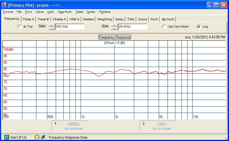

This is the FR of Salk Silks.
As you can see it is NOT hot on the top end.

Well, I don't know what you did driving them, but you likely did something stupid.

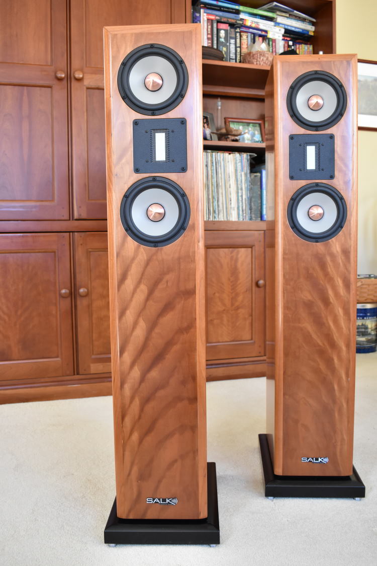

Yes, it was hard to tell from the picture. Mine are the 7" woofers. The problem is both those drivers are very hard to design for, because the cones start to break up violently just above 3K leading to an enormous peak in response. So the trick is to make the low pass crossover components do dual duty for HF roll off and notch filter. This you can do if you juggle with it.
The 10" breaks up even more violently. So for active use you still have to put a notch filter in the speaker lead. If you don't even the small amount of noise of even my Quad 909s, which have an S/N second to none, still will produce audible hiss if you don't notch out the break up mode between amp and driver.
People only tolerate this, as in the pass band of the drivers those magnesium alloy cones are absolutely rigid, and so have a wide and very flat off axis response.
But you can not let any significant audio through in those monstrous break up mode frequencies. That is the downside of really rigid cones, that they produce one hell of a peak when they do break up, and it is really violent. That is why so many just won't touch those drivers.

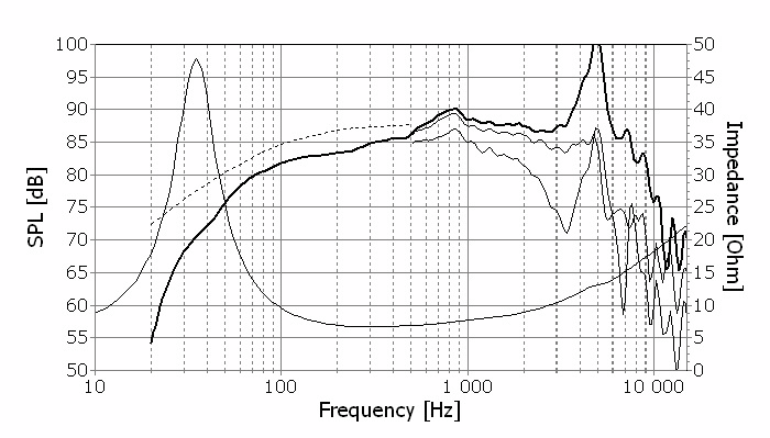

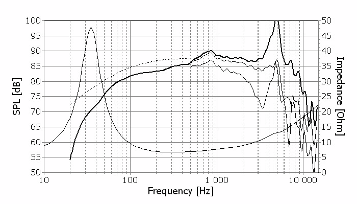

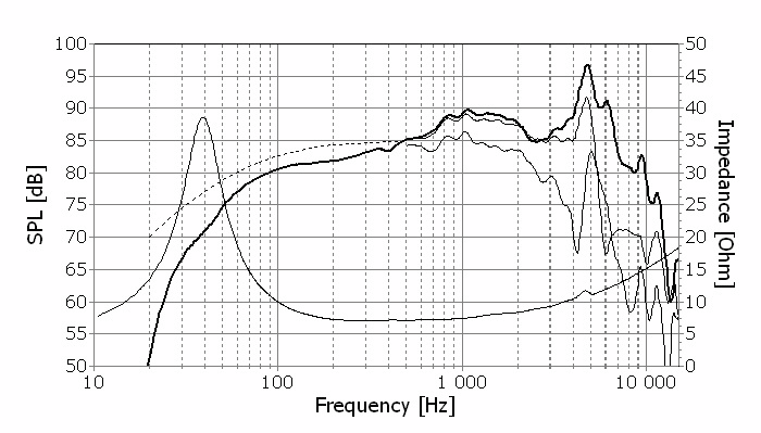

Here's Seas published frequency response curve for the W16 drivers. You can see that huge break-up starting by 3 kHz, peaking just below 5 kHz.

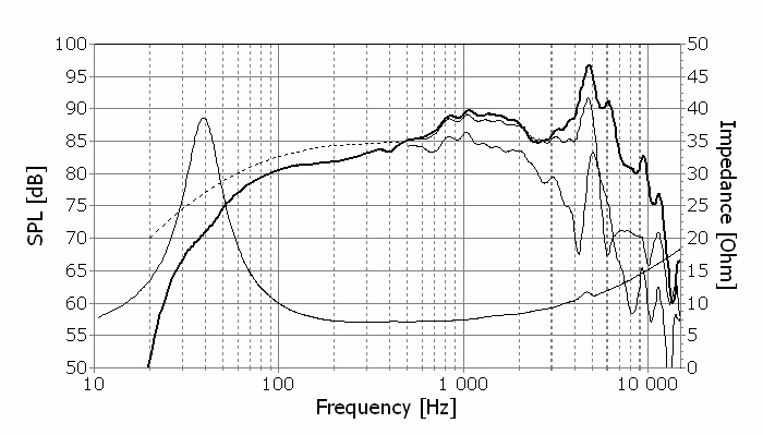

Compare that to the frequency response of the W18 driver.

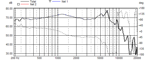

It's actually quite easy to trap out the breakup modes on the the Seas magnesium drivers. It just takes a shunt circuit consisting of a capacitor and inductor. A resistor generally isn't necessary. I've inserted below the raw response of the W16, and then the response with a series inductor and the shunt trap circuit. The breakup modes are now at least 35 dB down, which will be inaudible on music. (Note that the vertical demarcations are 10 dB rather than the customary 5 dB, so the breakup looks less severe. That's the only way I could show where the breakup ends up after being trapped.)
The main objection to these drivers is that if you cross in the 1.8 kHz - 2.0 kHz region, which is about as low as you would want to go without a tweeter waveguide, the 3rd order distortion products in the region of 1.6 kHz will be smack in the middle of the breakup, and this will increase the 3rd order distortion over what it would be without the breakup. I think it's around 1%. Purists would certainly object to that, but I don't think it's audible.
As they always say, there is more than one way of skinning the cat. I crossed at 2.5 KHz, and the tweeter crossover is basically second order but transitions to third order below I KHZ, to make sure tweeter output is well down at Fs. The wooder crossover is basically a second order filter but with an added inductor and a resistor in the circuit in parallel with the woofers, as an acceptor circuit to not excite the break up mode of the woofers. It is essentially a four element low pass crossover with a resistor added to adjust the Q of the crossover. Anyhow, it seems to work well, and helps minimize time shifts.
I have to say there are easier drivers to work with. I am happy with the result.
