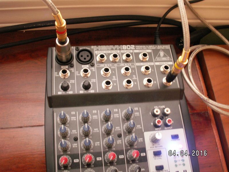

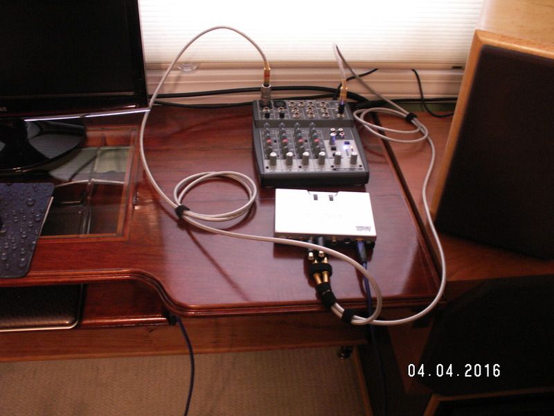

This is the loopback for sound card and mixing board calibration. I started to wonder about actually getting the 2496 in that loop but that made my head hurt.

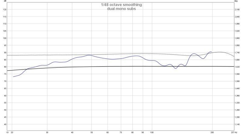

I figured out how to download the calibration files into the laptop. I ran analog audio right into the DEQ skipping the rec'r's xo. Kudos Tiger Boy. Way easier that way. It's nice seeing what the xo does but starting out with a flat-ish (no smoothing) bass response can't be bad.
Measuring L, R and both demonstrated what Wayne always says about the response in a dual sub set up being dumbed down to the response of the worse sub. A 5db raise in the sweep level showed a nice even rise in spl.
I'm into the high 20's @ 80 db +/- 3 db. That's pretty much as loud as I'm comfortable going with sweeps anyway but I think she's got more where that came from. It's roughly the same volume you hear in a room coming from YAA's headphones @ 2m.
