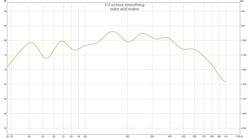

YAA, did you see the file I attached? My ECM8000 doesn't start to turn wonky until about 30 Hz. I'm not worried but as the Hz drop, the correction is -3.87 @ 16 Hz so you should worry. That file is on an odd shaped disc. There are other files on there. I tried the drag and drop thing but failed and I don't know how to calibrate the sound card so REW isn't quite the scalpel it might be ATM. At least I know the mic is linear enough through my range of interest.
So the DEQ2496 is actually a good one position solution as one poster mentioned on diy forum. It doesn't average out a curve for multiple positions but for one position I bet it allows for individual distance settings. I could use that until I figure out how to use REW to do some averaging among other things, Something else I would like to know is if the volume of the test tone can be lowered ... like maybe by turning my subs down? Or right on the DEQ? I can't do that to my neighbors yet again. I guess at this point I could still use REW enough to generate sweeps instead of using the tone (pink?) generated by the DEQ.
I didn't, I saw the measurement but not the file. Yea, My file corrects down to 5Hz I think. I also remember that when I finally figured out how to cal the sound card it started to roll off around 20Hz on the low end and like 15kHz on the top end.
