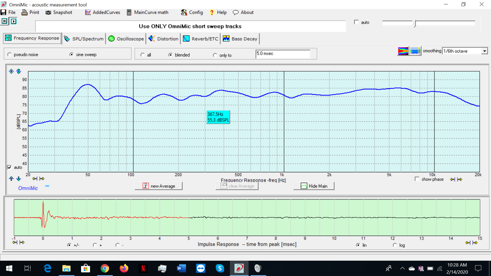

I did a system for someone using Elac towers with that same mid/HF coaxial unit.
It sounded pretty good, but not quite as good as I expected. On choral music in particular there was a slight hardness to the higher voices.
I obtained this FR from the tower speakers.
That rise from 3 to 7K I'm sure was the culprit. The 50 Hz peak was definitely audible, but these were tower speakers, and that would not apply to the speakers you are using. That rise between 3 and 7K is a bad place to have that happen, where as a dip in that region would probably not be audible or subtle.
I have heard KEF units with their coaxial drivers and liked them, but not had a chance to measure them or listen to them extensively.
You really do need to listen to speakers before purchase if you possibly can. From your preferences I would scratch the Klipsch and Dalis. You might be happy with the rest. Generally Far Eastern designed speakers are best avoided.

Thanks TLS Guy for the very informative reply!
