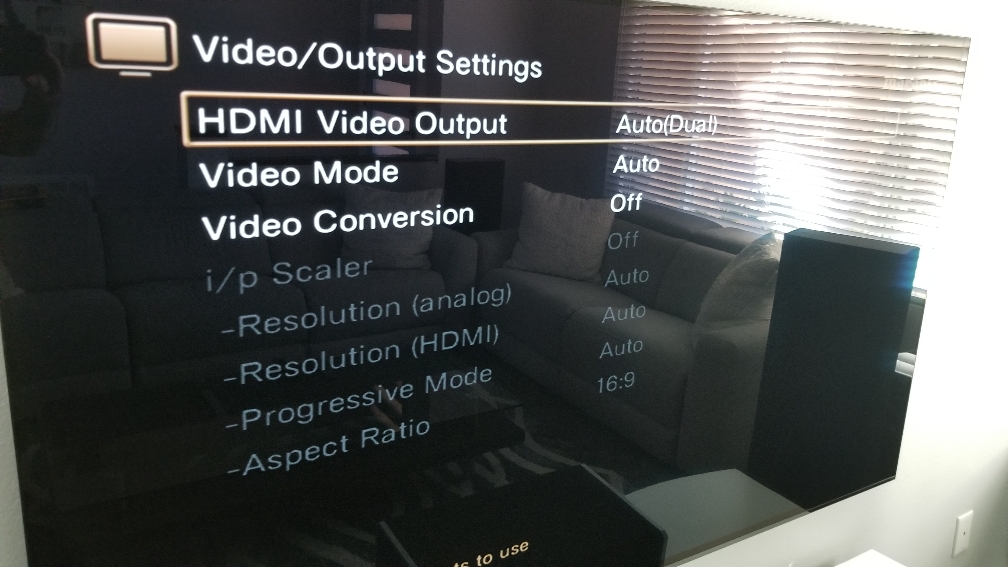

I'm having a set up issue that I believe I have isolated to my Denon AVR X3300W.
If you've read the thread you know I was trying to pass all inputs through my AVR other than the xbox. The problem I am having is that when connected through the AVR I cannot have 4k and HDR enabled (for which the Ultra HD Deep Color setting on the LG has to be set to on) without getting white snow like pixel flashing and the screen going intermittently blank for a few seconds at a time. When I toggle the Ultra HD Deep Color off and then back on the issues go away but it automatically adjusts the resolution outputting from the source (e.g. fire tv box) to 1080p. If I readjust the source back to 4k the snow and intermittent black screens come back.
Now, when I connect the sources directly to the TV HDMI inputs, bypassing the AVR, everything works fine -- 4K HDR with no snow or intermittent blackouts. So that's why I think the problem is with the AVR. The problem is that I have more sources than inputs on the TV so I'd really like to solve the issues and pass all signals (other than the xbox) through the AVR. I think I have the Video Output settings correct on the Denon:
Video Mode: Auto
Video Conversion: On
i/p Scaler: HDMI
Resolution (HDMI): 4k
Progressive Mode: Auto
Aspect Ratio 16:9
Any thoughts?
Assuming your AVR can pass 4k, and Ultra HD Deep Color, I would then as silly as it sounds, check the specs of ylour hdmi cable. And for the record, I checked out the cx line, and those are mind blowing.

The x3300w can pass 4K, HDR10, Dolby Vision, 12-bit color. I don't know what the spec of the HDMI cable from the AVR to the TV is, but it says it's high speed on the connector. I suppose I can order another couple cables.
I found two responses on an Apple TV forum to a similar problem. One said that video conversion should actually be turned off, the other said to turn it on - haha. The first one also said to use an HDMI input on the AVR that is physically located close to your monitor out on the AVR. Something about the length of the circuit and signal clocking.
Do you or anyone else have any other ideas?

High speed is not appropriate for full 4K/18Gb/s video.
You want a Premium or Ultra rated HDMI cable. Ultra should support 48Gb/s and up to 8K resolution. That's actually overkill.
Premium supports the full 18Gb/s signal which your devices support.

Thanks. That article suggest that I need an ultra high speed cable to push 4k 120fps (for the xbox) and premium for the fire tv and monitor out line to the TV. The rest of the sources are 1080p so I should have cables to to use there.
Any recommendations on actual cables to try?

I have Video Conversion to Off and no issues. Off means true passthrough and no issues with bandwidth.
I originally set it to on for scaling my non-4k sources. I'm ordering some new cables and failing that will try those settings.

BTW. I just noticed your HDMI Video Output setting says "Auto (Dual)". Is that because you are using both the monitor out and a zone 2?
Ok, I was just going to suggest you try using the TV as the upscaler (or source device), and bypass the AVR. Any reason you want to use AVR?
I'm not using zone 2, just the main monitor out. It's just the way it lists it, either off or auto. I guess if you have 2 zones, you need to keep it on auto.
Does the TV have an upscaling function? If so I will try that out.
Also, I was commenting more on the "(Dual)". Mine just says "Auto" not "Auto (Dual)".

So I'm still at a loss. I ordered some monoprice certified premium high speed cables, reconnected the fire tv through the receiver and the screen still intermittently went blank. I couldn't tell if the white snow was there because the picture wouldn't stay on long enough. I also changed the settings to turn video conversion off in the AVR. That didn't fix the issue.
So I set it all up directly through the TV again. I don't get it.
