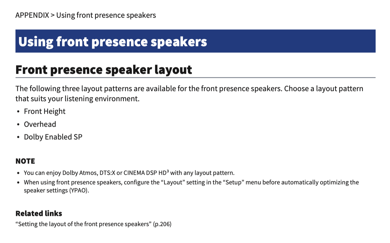

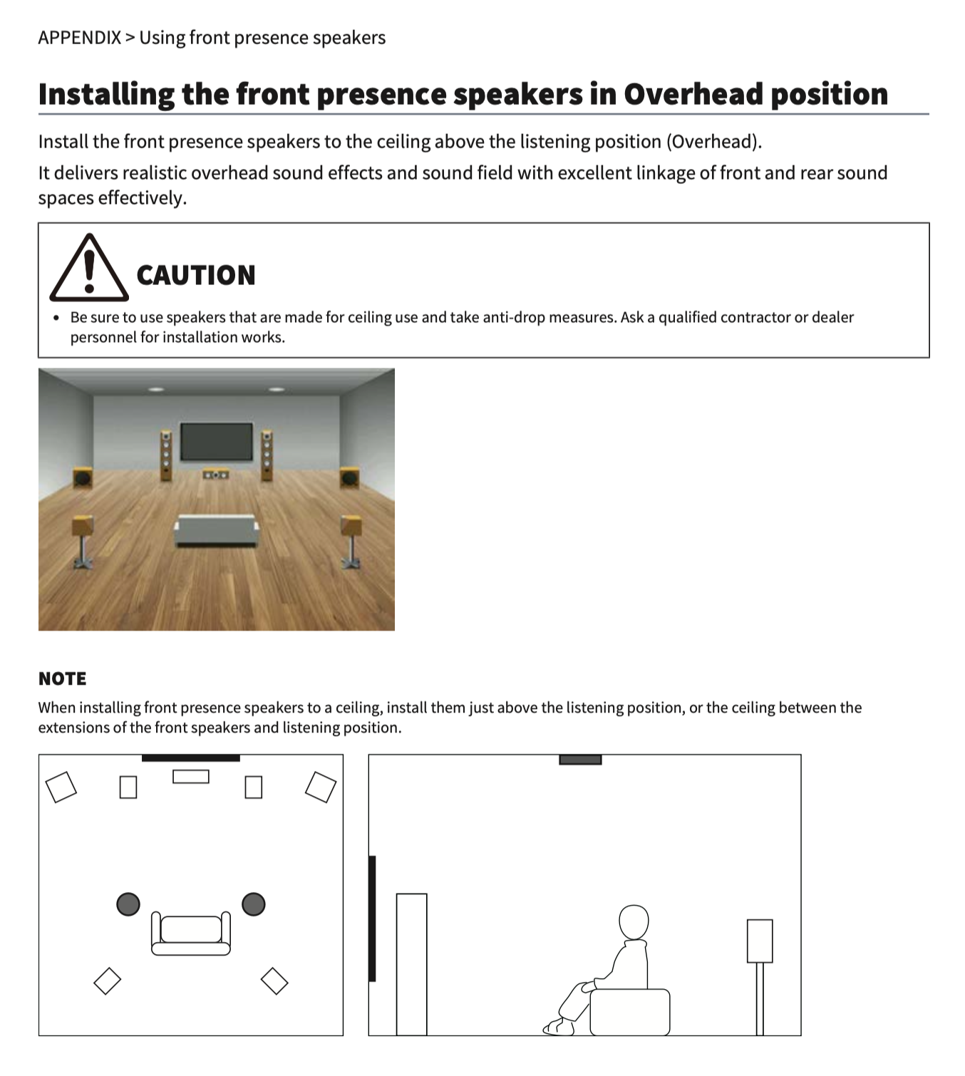

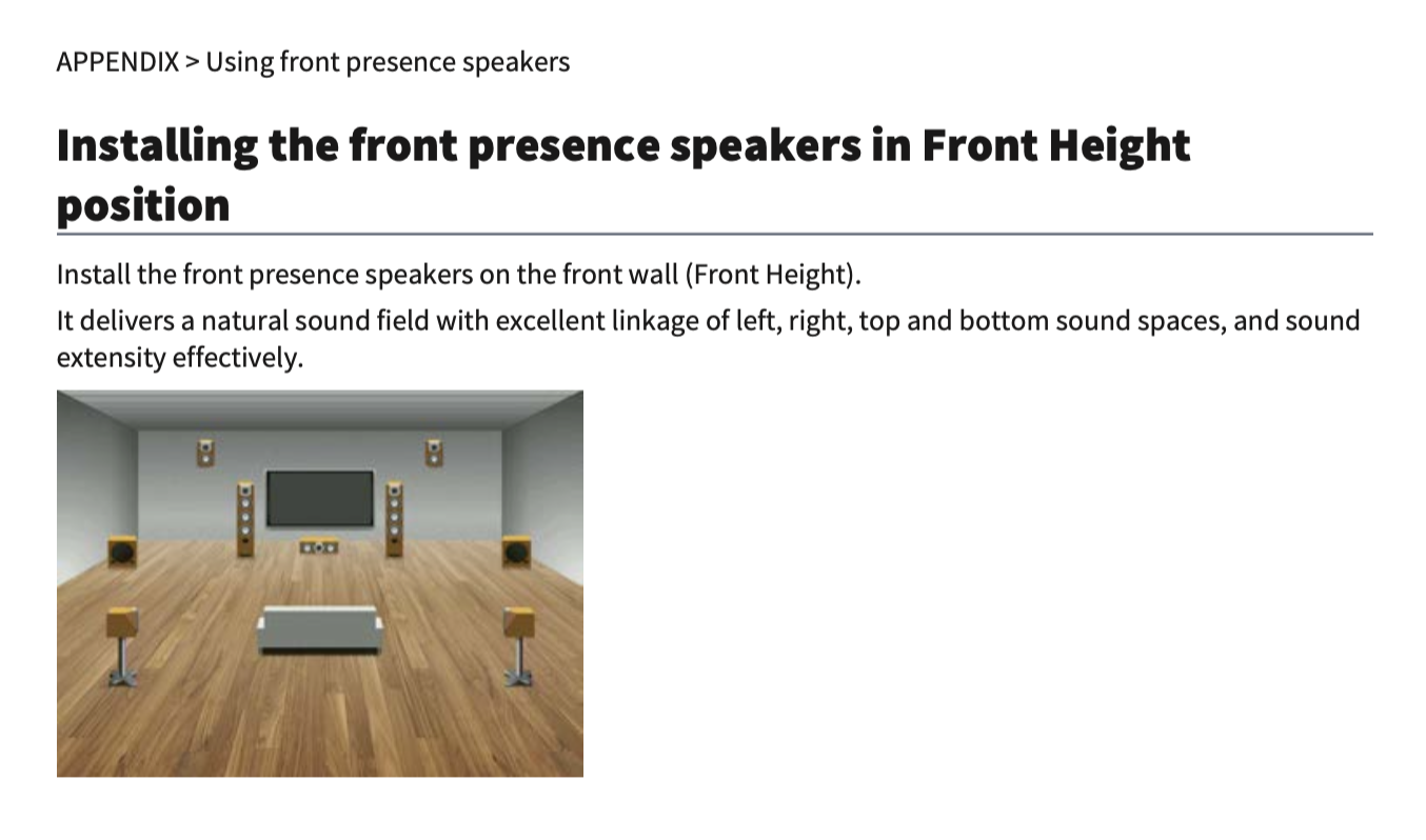

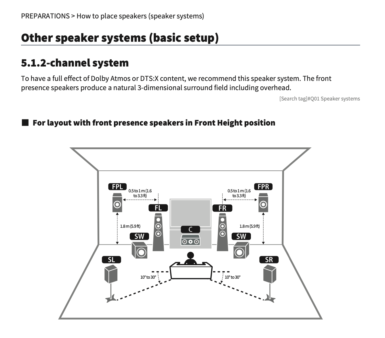

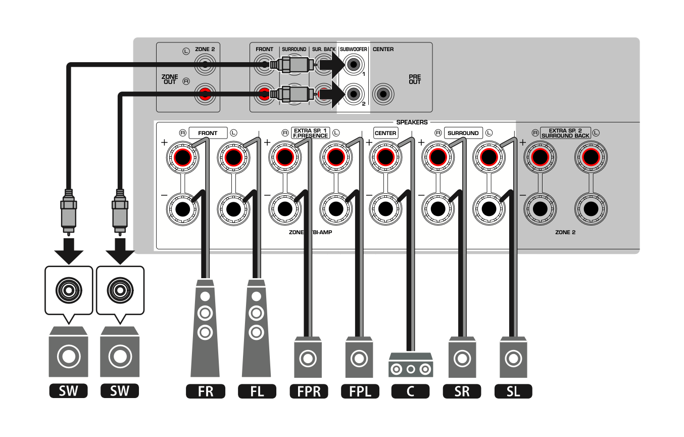

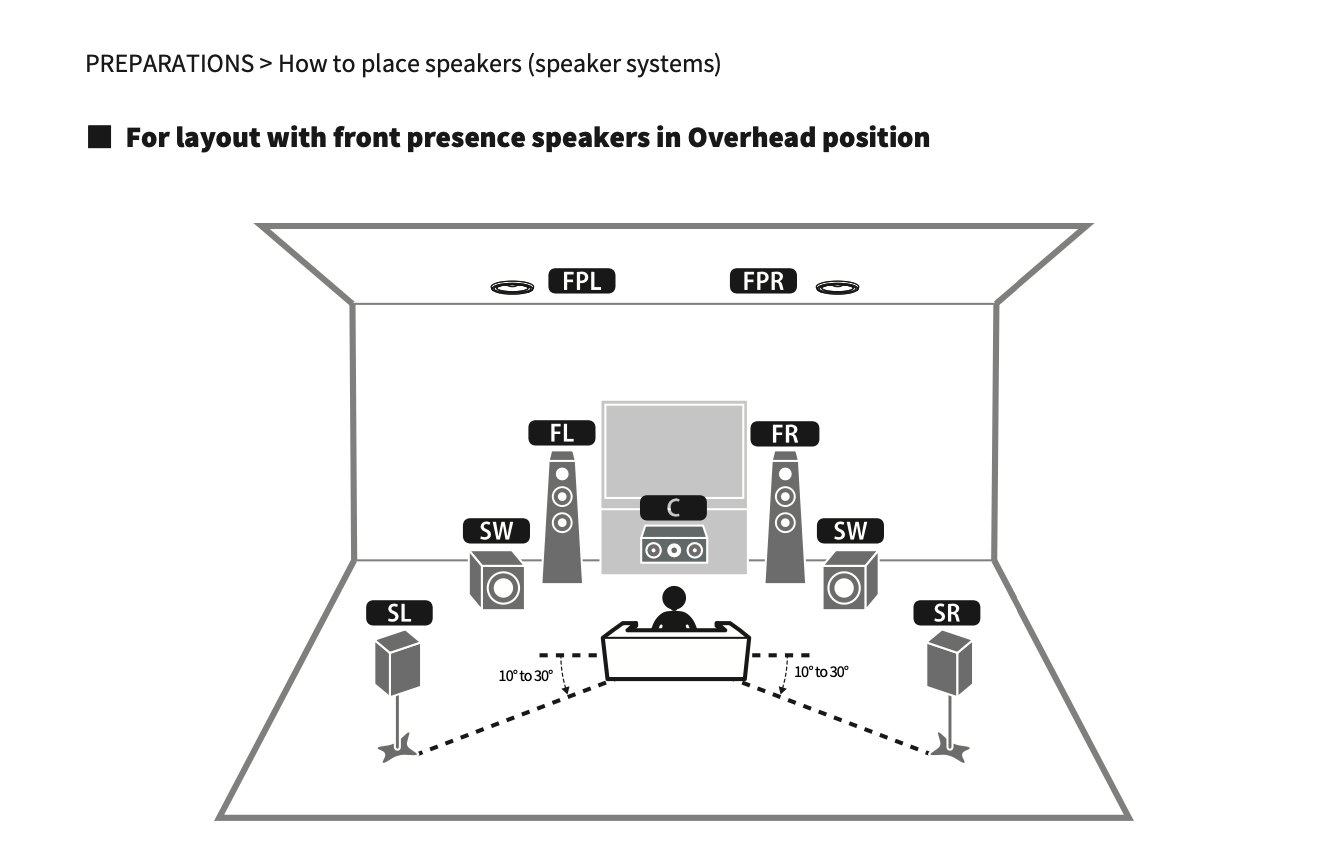

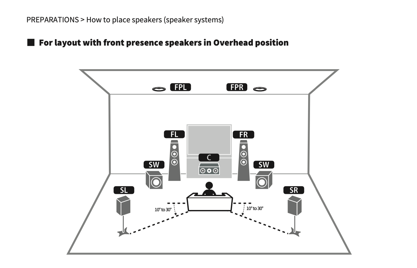

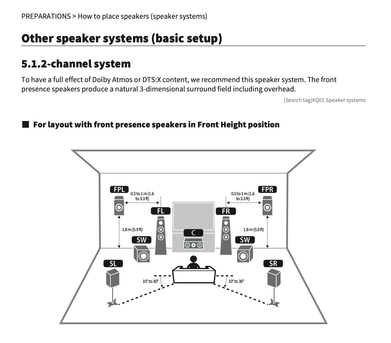

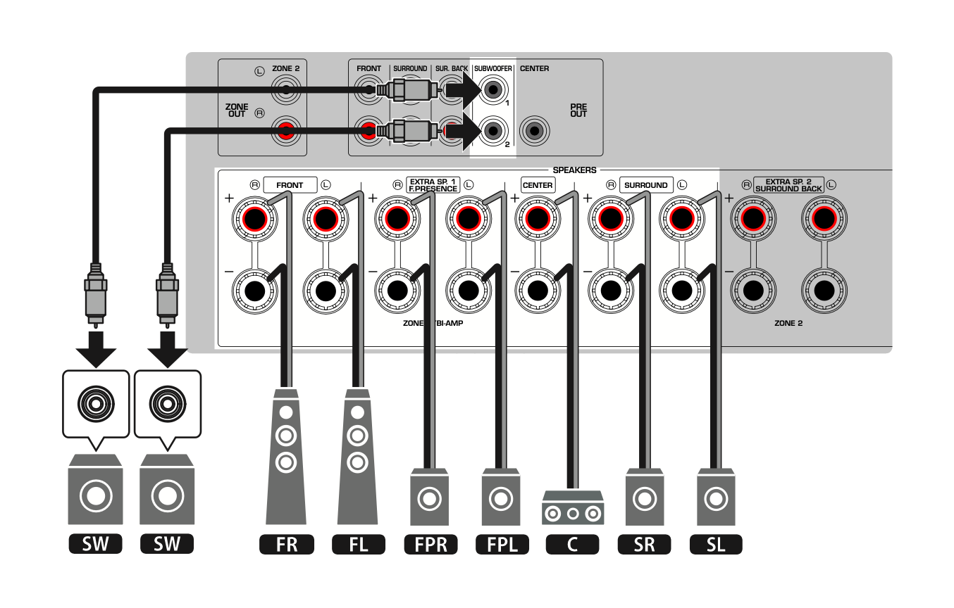

The A4A can power seven speakers for a 7.1 or a 5.1.2 speaker configuration. Some wire up nine speakers and the A4A will switch between the Front Presence Speakers and Surround Back Speakers according to the input signal and selected DSP mode. If wanting height effects using Front Presence Speakers, they can be mounted on the front wall(Front Height), in the ceiling(Overhead) or placed on top of the Front Speakers using up firing modules(Dolby Enabled SP).

So, when looking at the drawings of the manual, Prresence can be aligned with the mains in the ceiling or just in front of the listening position. Which one is ideal?

So, when looking at the drawings of the manual, Presence can be aligned with the mains in the ceiling or just in front of the listening position. Which one is ideal?
It's actually both. From left to right, the spacing typically lines up with the front speakers. From front to back, the positioning is just in front of the seating area. We're assuming that your surrounds are at ear level and that you are planning 5.1.2. If you're only surround speakers get mounted in the ceiling behind the seating area, then in-ceiling ATMOS / Presence is not recommended. Then you are better to stick with 5.1 or mount the presence speakers as Front Height above the mains. Angled speakers like SVS Prime Elevation are good for that purpose.

Both pics of the ceiling speakers are meant to show them just ahead and above the listening position. Getting very near the optimal placement will fine as many have to make do with different ceiling and furniture layouts.
There are those with eleven channel systems that contain seven speakers at ear level and four height speakers for a 7.1.4 speaker configuration. The A4A processes and powers just seven channels. So, for Dolby Atmos or DTS:X and mixing signals using Dolby Surround or DTS:X, the optimal speaker configuration is 5.1.2 with the Front Presence Speakers mounted on the ceiling just ahead of the listening position.
Information meant for the Surround Back Speakers in some multichannel signals will be sent to the Surround speakers when using a 5.1.2 speaker configuration. Additionally, Yamaha receivers feature VSBS. When turned ON, the receiver will attempt to place Surround Back channel information accordingly using Virtual Surround Back Speakers when actual Surround Back Speakers are not present.
