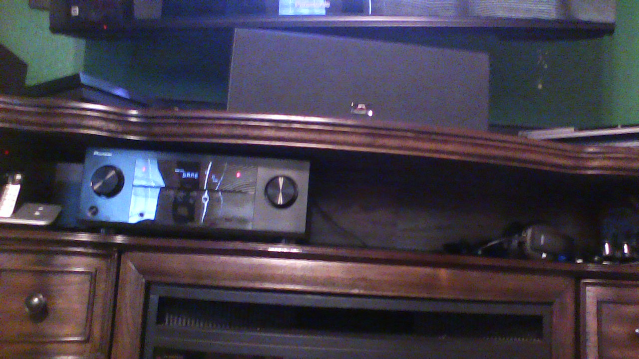

One slight word of caution. You state that height is a problem. I'm assuming it's because the receiver will be stuck in a shelf.
That could potentially be a problem. They generate heat and dissipate it using convection which requires a bit of space above the receiver in order to allow nature to do it's thing.
Try to keep as much space as possible above the receiver. If you jam it in there, you're asking for trouble.
Completely agree with you Mark. I have one of those electric fire place's in my game room. Here is what it looks like:
The opening is 7 1/4 inches but its actually 8 3/4 inches inside. I figure if I get an AVR about 7 inches, I'd still have about 1 3/4 inches clearance above the AVR inside the cabinet. Does that make sense? Plus, there is a removable panel on the back of the cabinet which I leave off for more ventilation. Its actually pretty roomy in there and stays well ventilated to my knowledge.
So what do you think Mark? Do you have a preference on one of the AVR's I listed, or perhaps one I've not listed?
I think you're cutting it pretty close to the bone but you SHOULD be fine. Personally, I'fd feel ore comfortable with at least twice that much. If you feel the top of the receiver getting hot, well, you lost the gamble.
As for receivers, any should satisfy your needs but I have a soft spot for Denon. The fact that the Denon 2802 I bought in 2003 is still going strong might cloud my judgment, though.
"Twice that much"......okay. Thanks for telling me that. Perhaps I should consider setting the AVR on top of the fireplace then. The reason I've not done that is because I've experienced overheating in the past with my ps3, so when I got this fireplace I put the ps3 on top and its not overheated since. When I got my ps4, I did the same thing (set it on top). So, with my center speaker (which is quite large), the ps3, and the ps4 all on top of the fireplace, it doesn't leave room for anything else. If I put the AVR on top I'm going to be forced to put the ps3 in the cabinet opening. But hey, I guess if I'm going to take a chance at overheating something I'd rather it be a $200 ps3 rather than a $700 AVR right? :)

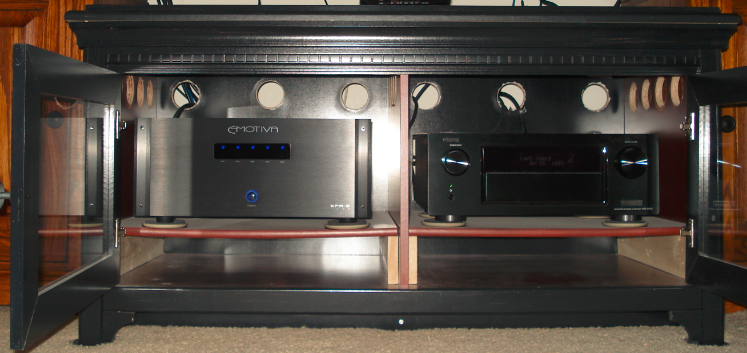

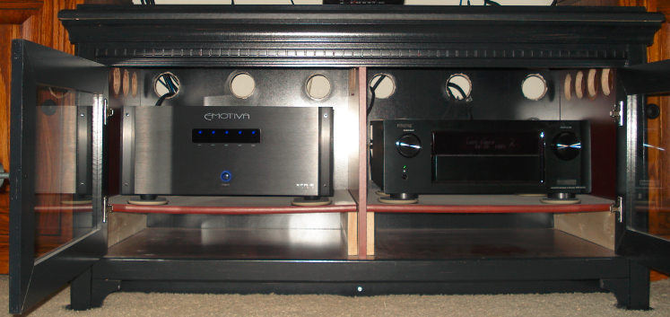

I'd still have about 1 3/4 inches clearance...there is a removable panel on the back of the cabinet which I leave off for more ventilation.
I don't know if you're willing, but perhaps you could cut some additional holes in the side of your cabinet w/ a hole saw. It would give the air a path to flow.
It is what I did with mine. Has worked fine for about a year now. There are many additional holes you cannot see in the picture, but it gives you an idea.
Ty Wayne
Ty Wayne
Thx for the tip herbu. That will likely come in handy at a latter time with a different cabinet. However, for my current setup I don't believe that I could benefit from it. There are two rectangular panels, one on each side, on the back of my cabinet. On the side where I have the AVR, I simply leave that whole back panel off for extra ventilation, as well as for all the wires/cables to go out. So its basically all open directly behind my AVR. There is also plenty of open space to each side of the AVR. The only place its close is directly above the AVR, which only allows about 2 inches or so clearance. It might look closer than 2 inches in the picture, but that's because the opening on the front of my cabinet is narrower than it is inside.
herbu
OK. The front of your cabinet is open. Mine has glass doors that close.
