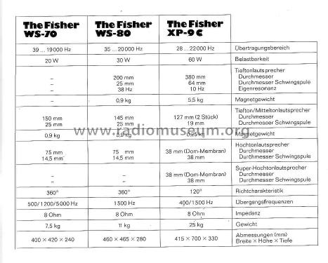

All you really need is to hook em up to an amp, and feed the amp with the sub output(s) of an AVR.
Well that would be cost effective...but I doubt the 28hz is a -3 number.:D
I'm thinking sealed 15" with external amplification. I'd need a driver that will work in this cabinet size or smaller...for cheap!;)o_O:D

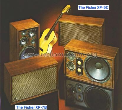

Define cheap :D Also, just how well constructed are the cabs in question, i.e. how likely is it that the baffle will disintegrate if you try to drop in a 30-40 pound subwoofer driver? Would the grills provide adequate clearance for something with a bit more throw than the stock unit?

I'm gonna pull the drivers and do some figurin' this weekend.
They are fairly solid bit without seeing the insides who knows. I'm sure the baffle will need support even if it is fairly beefy for the day.
If it isn't easy I'll leave them alone. Just an idea to look into for fun.

Well as it is, by my reckoning you've got a little over 2 cubic feet worth of internal volume per cabinet. This could work fairly well, achieving a Qtc of 0.707 in a bit under 2 cubic feet, leaving some room for additional bracing. If I were inclined to get my hands dirty, I'd gut the cabinet, brace as needed, and install a new double-thick baffle, which would allow you to recess the driver a bit to achieve adequate clearance with the grill. With some signal shaping, it could turn out reasonably well.

Unfortunately, that's probably not worth the effort either. Even with an XO upgrade, the design itself has some fundamental flaws. As far as I can ascertain by images on the web, the center to center spacing on those tweeters is about 4 inches, which equates to 1 wavelength at ~3250Hz. This pretty much ensures acoustical interference through their passband. The extended edges of the enclosure would also contribute significantly to diffraction, muddying things up further. I don't think it's overstating anything to say that even with upgrades, Dennis' $190 upgraded Daytons would represent a more accurate loudspeaker.

That's why he'd be in an asylum! these things are a hot mess and why I'd consider moding them into subs if it was quick and easy. If not they can sit in the elephant speaker graveyard (room over my garage). I believe there are only six pairs of vintage speakers up there...and one center channel...oh and some outdoor speakers...
