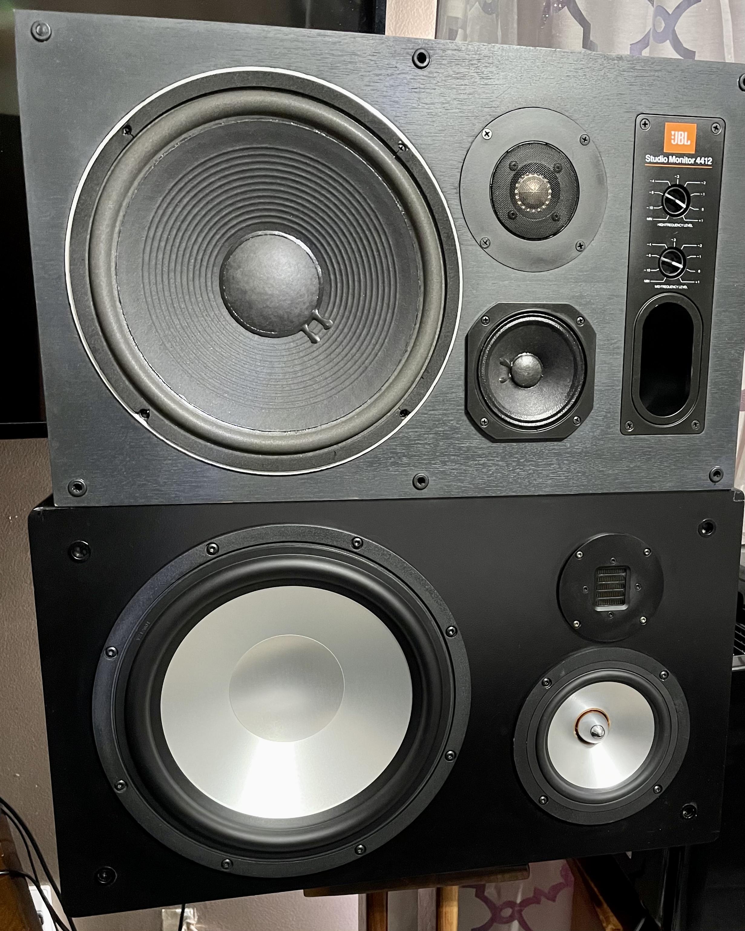

I’ve done weeks long comparisons between the gold standard of studio Monitors, a JBL 4412 (ported) against the RBH’s professional monitor (sealed). Rotel amps/preamp used. Hands down, no comparison. The RBH sent the JBL to storage. It’s extremely flat response (mic tested) clarity, dynamic punch. This is a gorgeous sounding speaker. I’ve paired them with a 1010-SEN/Reference sub (SA-400 amp)The new batman car chase scene scared the living hell out of

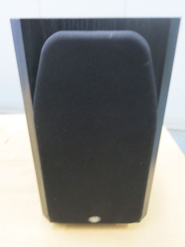

What about the bookshelf that I linked? Also, you can call RBH if you ever have a question, their customer service is great.
What AVR do you have and do you use a sub?

It may very well be fine, that's true. And it isn't a large room, no. The receiver is a Yamaha TSR-700, not that high-end maybe but it works great for me. Maybe I will reach out to RBH to ask if they can validate the authenticity of that speaker in the listing.
That seemed fine, but I just want to avoid getting one and not being able to find the matching second.
Do you a specific budget limit for the center?
Under $700 would be great but I could stretch if needed. I got the towers for $2k and am very happy with what that got me. In general for centers, I have trouble hearing dialogue in movies a lot of the time but at the same time bright speakers really wear on me quickly.

Okay I'll do some digging also contact RBH and see if they have suggestions for a matching center the guys at RBH are AWESOME with there customer service
smozi
RBH confirmed that center speaker listing on eBay is legit :) so that's one problem solved! Thanks all.
... and then they reached out again to say they have a B-stock rosewood cabinet they could build up for me! Will have to weigh the cost but their customer service is indeed excellent.
