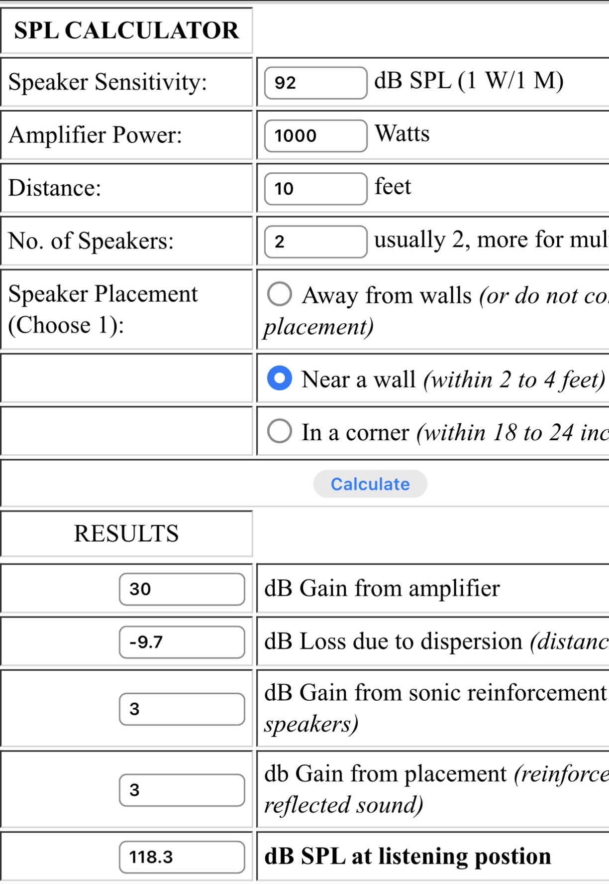

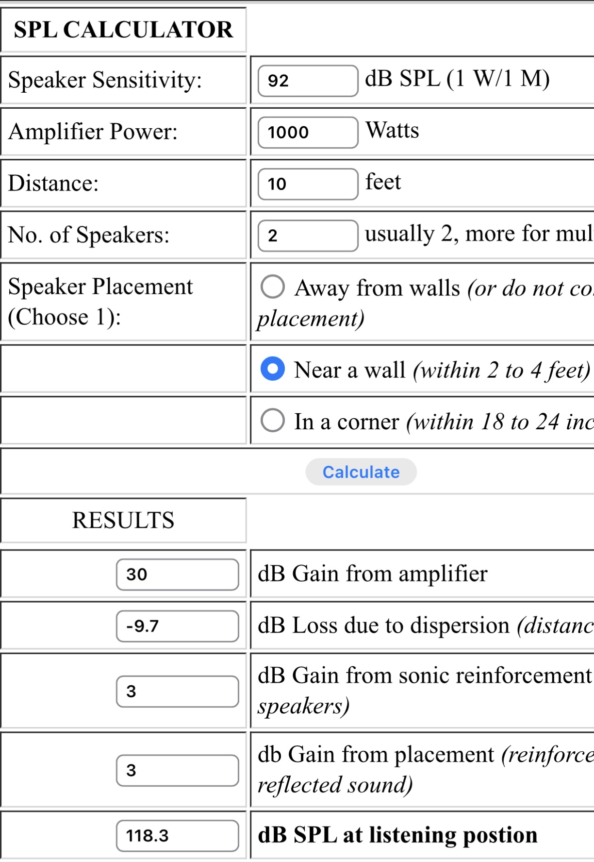

It doesn’t matter if your room opens up to the rest of the world. It only matter how far you sit from them, which is ONLY 10 FT.
OK, do this one simple TRICK. On your TRIMS (speaker channel levels), manually increase all of them by 6dB. So if your Front Left is at 0.0dB, increase it to +6., etc. Then tell us if you FEEL the power is better.
Like I said before I have tried every adjustment and nothing seems to get it where I want. It also DOES matter that it opens up to the rest of the house because when I am playing music I am not just sitting there on my couch 10 feet away.
Oh, it’s a different story if you are sitting 25FT away and want the same volume as from 10FT away.
