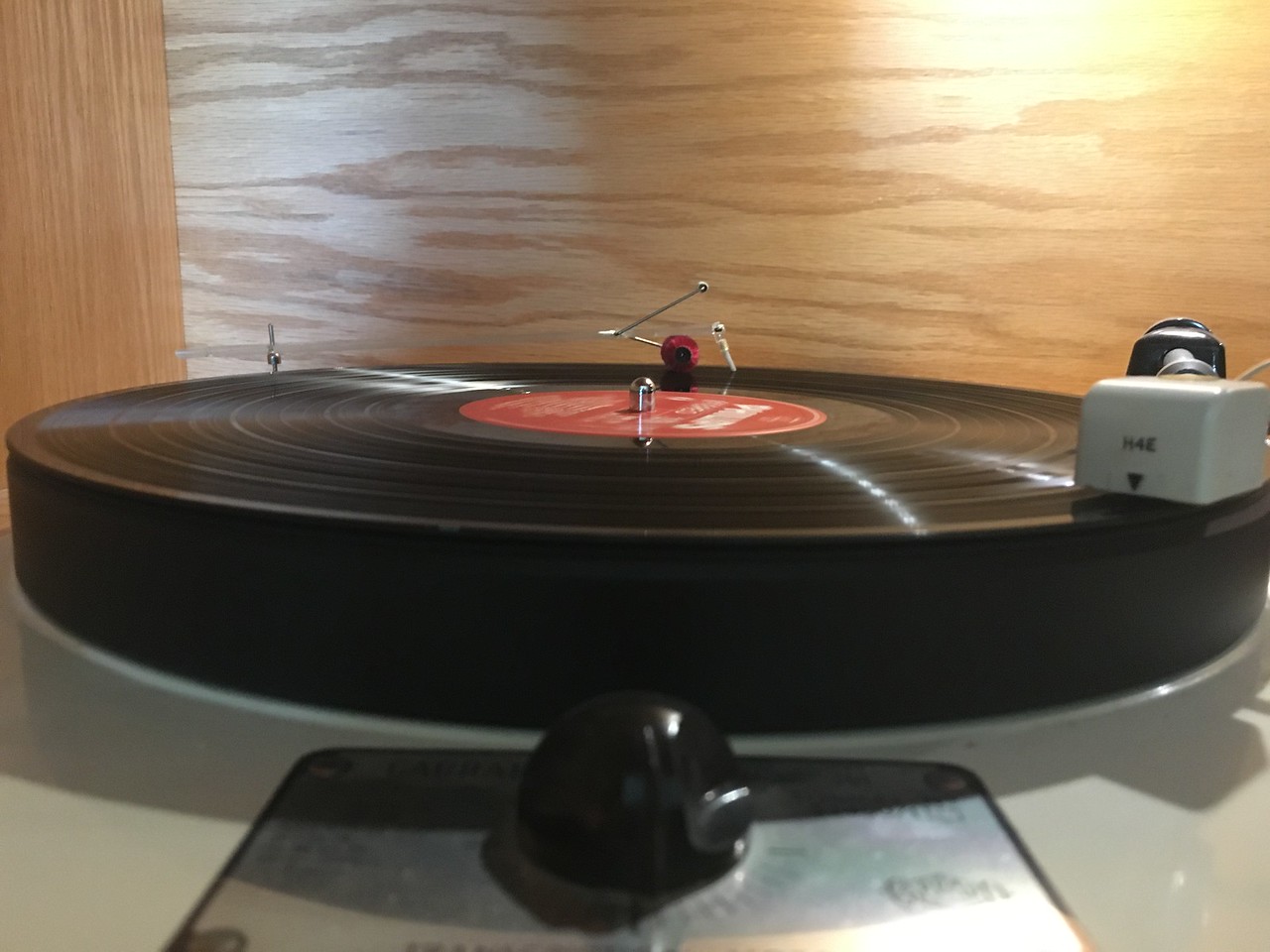

I just got back into the wax after a few decades away. This go around I have much better to play with than I did before.
Something that strikes me hard is the fact that no matter how I clean the record there is always a persistent campfire in the background. Of course, records can have a range of quality but some of the very best I have are like honey to the ears but in the silent spots and in between tracks there's that damn crackling.
I can't imagine people with 100k tied up in audio gear still deal with that.
I've tried the cleaning kit provided by Fluance which is dry and also a wet kit with velvet brush found here: Big Fudge
Is there a problem with my cartridge? Is this normal? I thought vinyl had the ability to be silent. I can't believe you need to use an $800 cleaning machine before listening to anything.
