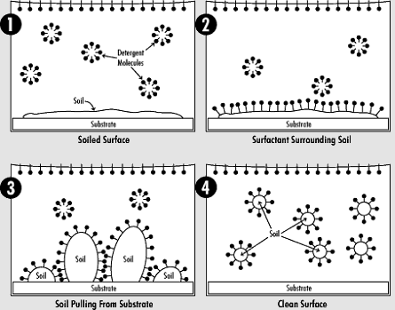

The crud (dust mixed with fingerprint oils) does get suspended in detergent solutions. The action of detergent is well known to lab scientists but is not well understood by most others. I tried to find a simple internet description of how detergents work that doesn't get deep into oil/water partition and detergent micelles. I didn't find anything I thought was very good, but did find this simplified cartoon of detergent action. See below.
Technically, dilute solutions of detergent in water allow formation of microscopic bubble-like structures called micelles. In panel 1 of the diagram below, these micelles are labeled as 'Detergent Molecules'. Soil or crud tends to be oily or greasy, and doesn't dissolve in water alone. Instead, it tends to deposit on surfaces, as shown in panel 1. With detergent present in the form of micelles, the crud gets coated with individual detergent molecules (the 'lollipops' in panels 2-4), lifts from the surface, and is suspended in water in the form of mixed micelles of detergent and crud, as shown in panels 2-4. I hope this helps you understand what goes on.
The real trick is to use just enough detergent to form micelles. If you use too much detergent, rinsing all the detergent away becomes a problem. A few drops of liquid dish detergent does the job. The water should not be sudsy.
Micelles are the key.
In fact, the real key is the Critical Micelle Concentration (CMC). I'm sure I'm not educating you here, just info for the other members.
If you have excess conc of detergent above the CMC, then you are really just wasting $, and it is more difficult to rinse off than it should be.

When you're going to do a sensitive chemical assay, such as trace metal analysis or amino acid analysis, you have to use ultrapure grades of solvents and detergents. If you're going to play the record afterwards, you can get away with much lower purity. Fragrance and color additives may offend the audiophile :rolleyes:, but you cannot hear them after rinsing and drying the record.
Yes, you're correct. I was trying to avoid using esoteric terms like hydrophillic, hydrophobic, amphipathic, or critical micelle concentration.
