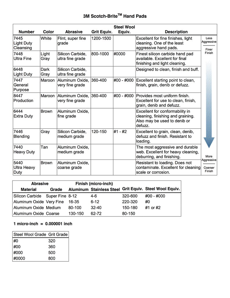

I gave up on steel wool a long time ago- sheds too much metal and it can discolor. I use ScotchBrite-

Handy chart. I printed that for future reference, thanks.

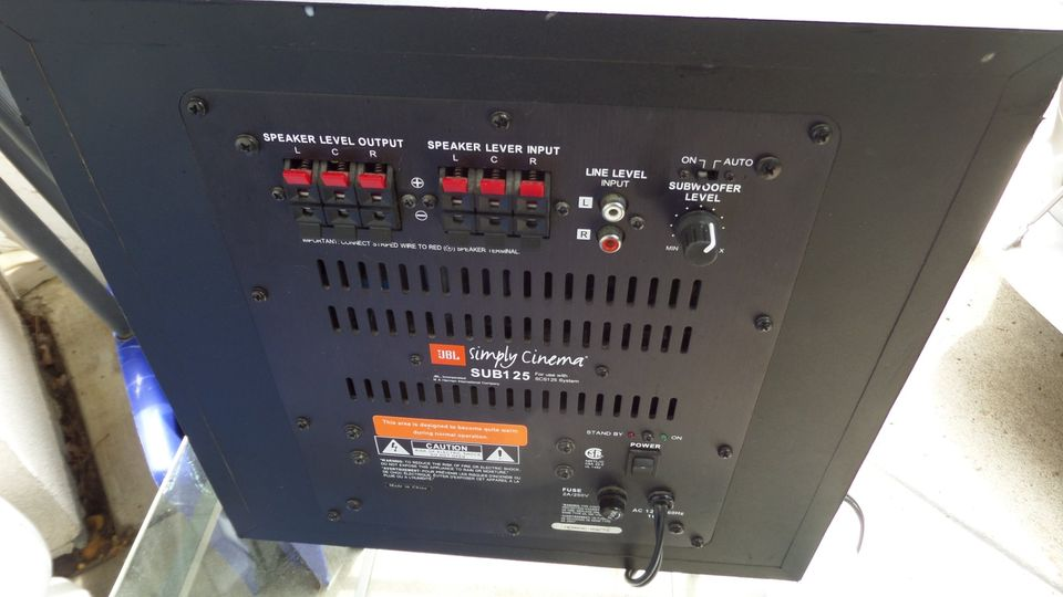

Anyone ever seen this confifuration before? With a center connection? I just bought this on Marketplace. On my way to snare it now. I obviously will not use the center connection.
Anyone ever seen this confifuration before? With a center connection? I just bought this on Marketplace. On my way to snare it now. I obviously will not use the center connection. View attachment 65914
Never saw that connection. How do you know those subs are any good? I found it. That is an absolute POS. It is an 8" sub from a small surround speaker in a box. Absolute junk and not even worth the gas to go and get it. Always avoid junk, it is costly.

Thx for the ifo TLS Guy! I am cancelling going to get it!

I did not bother to look it up! In his description he said it was a 10. No photos of the driver, which would have helped. I just told him what he is selling is an 8.

My computer has an old floor firing Klipsch 10. It has speaker-level connections. I will trade the 8 that's in that room! That's a fine resolution. So glad TLS Guy set me straight!
