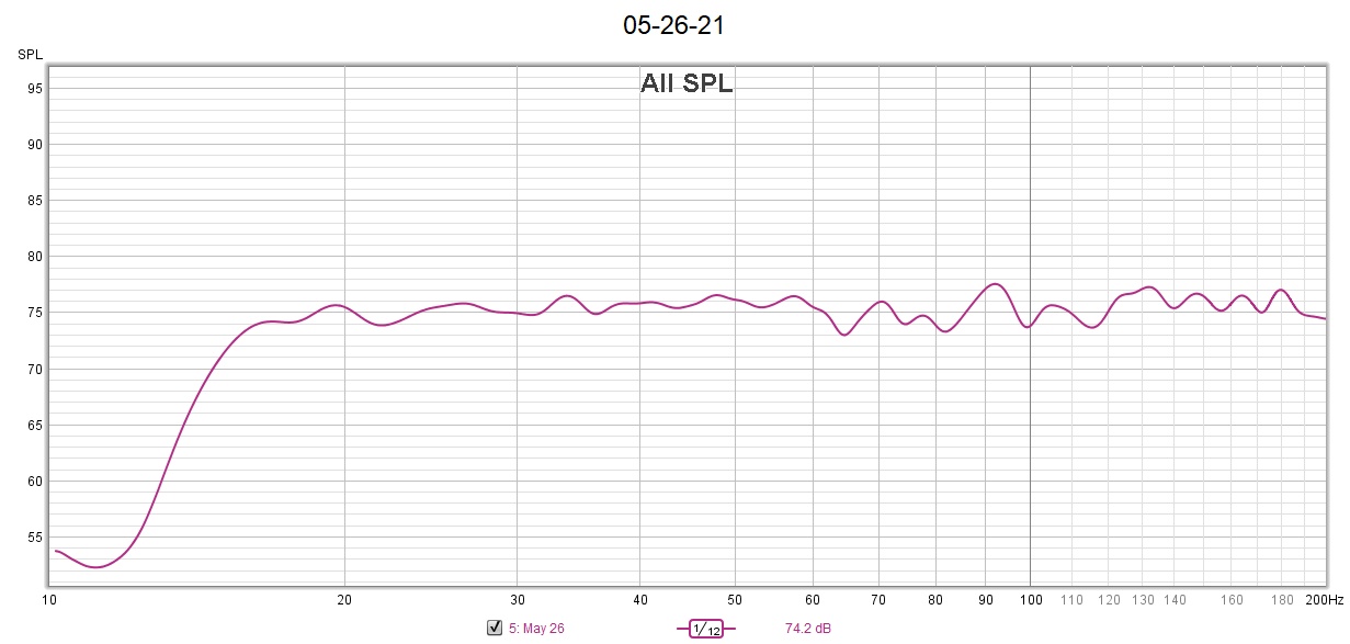

Yes that looks nice. I've only used REW and MiniDSP for below 90 and largely just to integrate my famous mismatching subs :) What you have done there is well done.

The greatroom as well as the basement now as of a week ago have multiple subs being controlled thru a minidsp. That being said and before even using the minidsp, I set the AVR gain to 0 with the range going from -10 to +10 db on the AVR, and I set the gain on the subs to the 50% mark. I took measurements at the same location to ensure the outputs were equal in SPL. Now that the minidsp controls the sub, I use the AVR gain to increase bass SPL.
