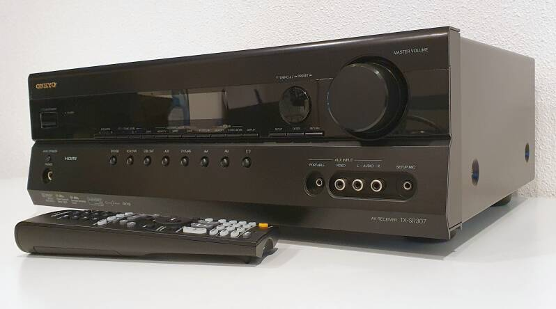

I looked around for a little bit, and found a site with cheap second-hand AVR's.

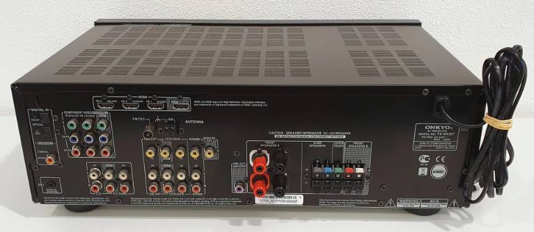

For example I can buy an "Reciever Onkyo TX-SR307 5.1 (100W)" for 80 euro's, is that something that would work for me?

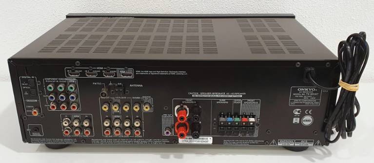

Only thing is, the inputs for the speakers look a bit different, so I'm not sure if they can connect with my speakers.

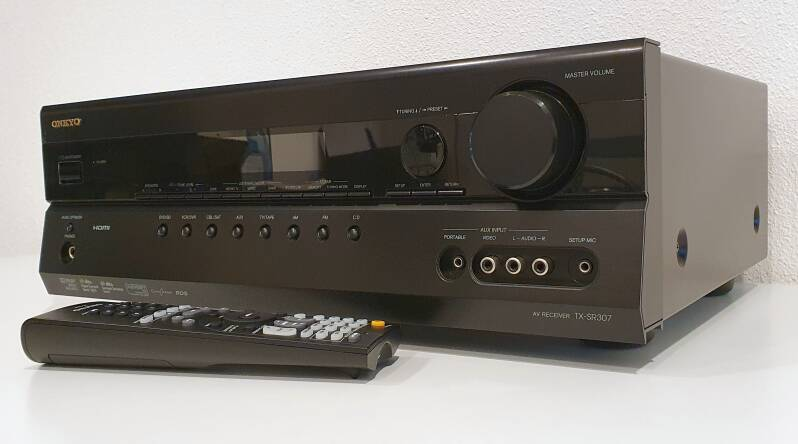

View attachment 58570View attachment 58571
Just different types of speaker connections, bare speaker wire ends will work fine with the spring clips as well as the other terminals.

Generally avrs will have amps ranging from 50 to 150 watts per channel (wpc). Usually the 8 ohm spec is compared at full bandwidth (20 Hz to 20kHz) with a THD spec (usually a low one, typically under 1% or less) with 2ch driven....but some use 6 ohm or 4 ohm ratings to make the wattage number look bigger. Your Onkyo 307 avr's manual specifies 65 wpc into 8 ohm from 20 Hz to 20 kHz at .7% THD (90 wpc into 6 ohm at 1kHz at .9% THD). Most likely this amp will do fine with your speakers, but without knowing impedance and sensitivity specs for your speakers, hard to calculate particulars. This is a nice tool to help estimate amp needs http://myhometheater.homestead.com/splcalculator.html

The unit you pictured has connectors that take bare wire into spring loaded clips. You can twist the wire or tin it with solder or even solder on connectors to the wire that fit the connectors on the AVR. Higher end AVR's have binding posts which still use the bare wire but are more secure because they are tighted with a screw rather than bing held by a spring clip. My persona preference, by the way, is to strip the speaker wire properly and tin the ends with solder. In other words the stuff has you covered. Nothing to worry about.
