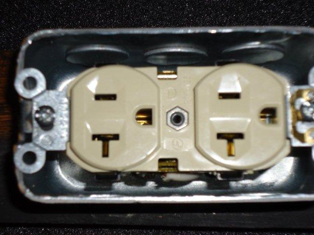

Assuming this is correct, please forgive my ignorance, a dedicated 110 volt 20 amp circiut would be appropriate, correct?

Yes the amp is designed to work on 120V though I didn't see an image of the power receptacle or cord to see if its IEC compliant with a true 20A outlet. You may need a converter cable to use it on a 20A line but I would also verify with the manufacturer.

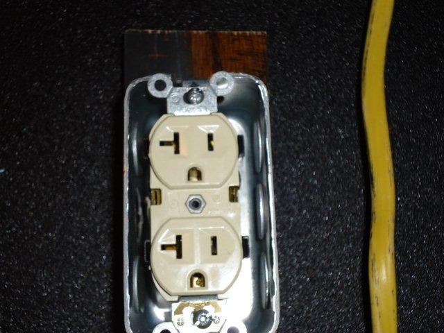

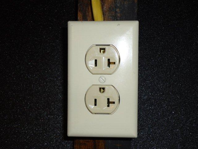

Not dedicated outlet
I posted a few pics of my supposed dedicated 20 amp outlet, I quess I answered my own question, I don't think it is dedicated, I don't know what plug is on the Triax as well.
It says on the receptacle 125 volt 20 amp UL listed:confused:

That appears to be a true dedicated 20A line.
Thanks, I ran the 12/3 wire myself and installed the 20 breakers in the box, I did this with two circuits in my HT room, so yes I quess I have two dedicated 20 amp circuits in my room with nothing else on them, no lights, freezers etc. :) So I guess I'm good to go with the Triax?
