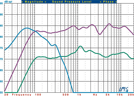

HT Labs Measures: SVS SBS-01 Speaker System
image: http://www.soundandvision.com/images/archivesart/108SVS.3.jpg
• Satellite Sensitivity: 84 dB from 500 Hz to 2 kHz
• Center Sensitivity: 88 dB from 500 Hz to 2 kHz
This graph shows the quasi-anechoic (employing close-miking of all woofers) frequency response of the SBS-01 satellite (purple trace), PB10-NSD subwoofer (blue trace), and SCS-01 center channel (green trace). All passive loudspeakers were measured with grilles at a distance of 1 meter with a 2.83-volt input and scaled for display purposes.
The SBS-01's listening-window response (a five-point average of axial and +/–15-degree horizontal and vertical responses) measures +1.82/–2.98 decibels from 200 hertz to 10 kilohertz. The –3-dB point is at 84 Hz, and the –6-dB point is at 68 Hz. Impedance reaches a minimum of 7.48 ohms at 166 Hz and a phase angle of –49.67 degrees at 91 Hz.
The SCS-01's listening-window response measures +2.75/–2.78 dB from 200 Hz to 10 kHz. An average of axial and +/–15-degree horizontal responses measures +2.88/–2.57 dB from 200 Hz to 10 kHz. The –3-dB point is at 101 Hz, and the –6dB point is at 80 Hz. Impedance reaches a minimum of 9.00 ohms at 174 Hz and a phase angle of –50.22 degrees at 98 Hz.
The PB10-NSD's close-miked response, normalized to the level at 80 Hz, indicates that the lower –3-dB point is at 39 Hz and the –6-dB point is at 30 Hz. The upper –3-dB point is at 138 Hz using the only input.-MJP
Read more at http://www.soundandvision.com/content/svs-sbs-01-speaker-system-and-pioneer-vsx-1017txv-k-av-receiver-ht-labs-measures-svs#eU3b42ocPGBvEaEw.99

I'm sorry I forgot your request to link that graph. However this thread is long enough to make the head spin.
This is where i got the graph.
That graph correlates very well with the impedance data. That solitary bass region tuning peak is spot on for that 70 to 100 Hz peak. There is also a null in the crossover region. So there is a phase issue.

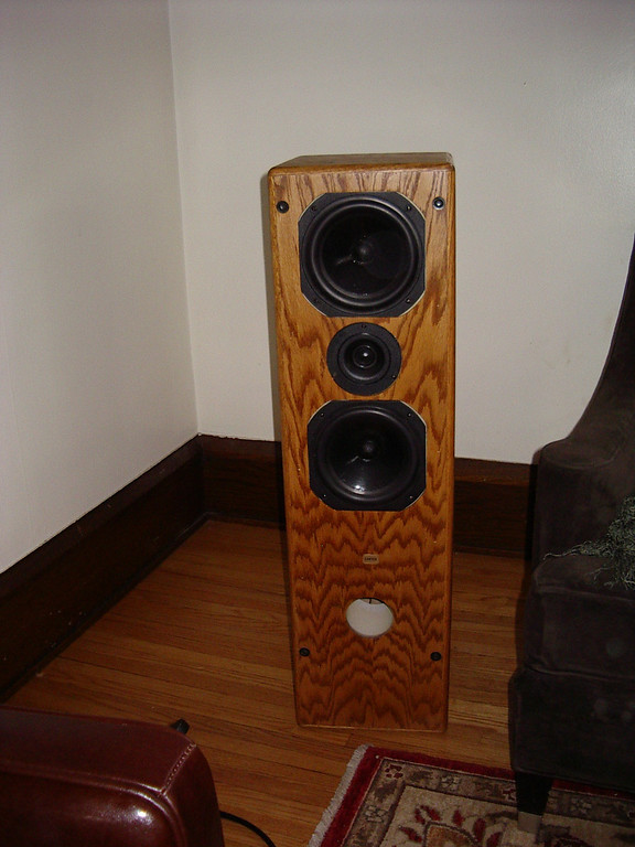

That is why I build my own and have done for over 60 years now. I don't want somebody else's rubbish.

I only sold speakers once.
These speakers won the national audiophile sound off.
I arranged production of them and sent them out to dealers. Before the next production run, the manufacturer had stopped production of the woofers. After that I lost interest and continued to just design and make speakers for myself family and a few close friends. I think that is the way it will stay.
Halon451
Halon451
Beautiful cabinet TLS Guy. It's probably better that you keep it more as an enjoyable hobby instead of having to deal with production demands, customer service, etc.
