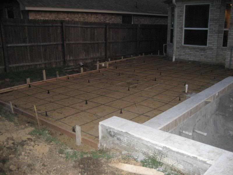

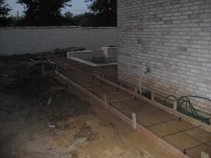

That looks like it's coming along nicely Greg.
Just a thought::) This may be a good time to pipe your gutter downspouts underground.
(if you don't already have that planed)
We were just talking about what we should do with the gutters. The decking will go all the way to the house so I was planning on moving the downspouts.
Would you leave them where they are and do them underground with decking around them or move them?

Move them. Don't put them under the slab. Avoid future problems.
Murphy's law--"Anything that can go wrong, will go wrong."
Good pont. I will just move them to the corner of the house.
I assume you can just get some type of plug for the downpour and cut a new section?

You may have to leave them where they are and go with underground drains.
The reason being, that the gutters are pitched slightly toward the downspout side.
So if you move the leader location and plug the old hole, you'll end up with water sitting in the low end of the gutter.
If the underground pipe job is done correctly you wont have any problems. That, and put catch screens inside the gutter, right over the downspout, if you get a lot of leaves.
Guess all the worry was for nothing on the gutters. The pool builder was just out for the deck design and spray painted circles under each downspout. I asked what he does with those and he said he builds them into underground drains.

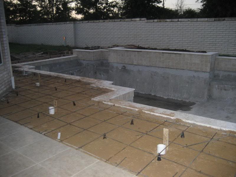

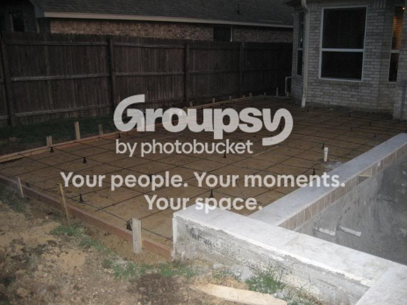

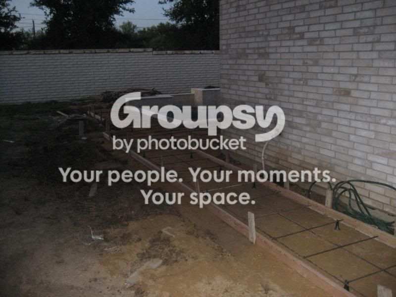

We have been in rain delays and lost most of last week. They are forming out the decking today(well they are supposed to be, so far it just seems like a bunch of people came over to stand around and talk to each other with shovels in hand), pouring deck tomorrow and plaster will be either Saturday or Monday. After all that, I get to work. Installing new fence, landscape and lighting, new sod and some other stuff I can't remember right now.
Ok, everyone on here keep their fingers crossed that the rain stays away for the next several days. Schedule is confirmed for decking tomorrow, fencing on Saturday, Pebble Tec on Monday, acid wash and fill on Tuesday, sprinkler on Wednesday and sod on Thursday.
Man, I think I am about 12k over budget but I am too afraid to add it all up and see!

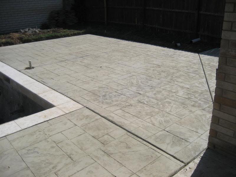

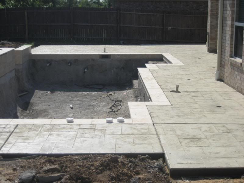

Greg..... looks fantastic - I love stamped concrete.... you picked the right stamp also IMO...
I want to do something like that for my back patio when I get to that point.

That looks great... Its cool to see this project taking shape.
Thanks Warp.
Yes, we love the pattern. It is called Grand Ashlar and the color is bone.
