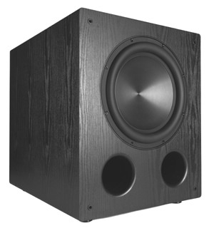

A contender from the last thread and another I think might work:
Rythmik FVX12
Airmotiv RS13
Any others I should consider?

I like the look of the sub (this is important to me) and I from what I gather in this thread it looks like it is derived from the Outlaw X-13 which was a great performer (as you are aware, I'm sure).
ryanosaur
ryanosaur
Gotcha - food for thought.
Unless it could be confirmed that they had Claridy (The company behind the X-13 and the Monolth Subs) do their design work, I wouldn't trust it. Likewise, without seeing measurements?... Ad copy can claim everything they want you to believe..
End of the day, buyer beware. And Emo has done a lot to cause such wariness.
shadyJ
Speaker of the House
Staff member
Same basic design team as Claridy.
shadyJ
Staff member
Any chance one is going to find its way through your hands? ;)
Unlikely. However, I wouldn't expect it to perform radically differently than the Outlaw X13, except with a bit less deep bass headroom.
