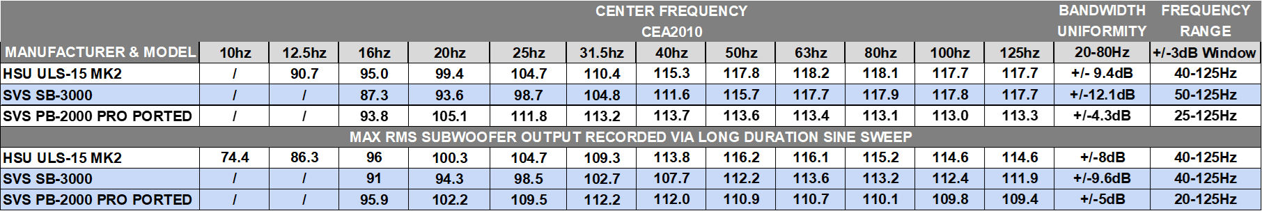

Building off this thread.
I ended up with dual SB3000s (and added a sealed DIY 12" that I had laying around). While I like them (and have had EXCELLENT support with SVS) I feel that I am missing some of the deep lows when in my sitting position and could use a bit more 'fill' for the room. With that in mind I have set out to 'upgrade'. Due to aesthetics, I really do not want a sub more than 23" deep. The 3 subs in the poll I think are my best options (though I'm open to suggestions). Obviously I can stick with the SB3000s...I can take advantage of SVSs 'upgrade' policy for the PB2000 Pros or I can sell what I have and buy the HSU.
Looking at the compilation (edited for easy reading) it seems obvious....
All opinions are welcome!
PS - yes, I received and ignored very good advice in my original thread.
Yes, I screwed up option #3 of my poll....
It reads:
  • Dual HSU ULS-12 mk2 (+ DIY 12")
It should read:
  • Dual HSU ULS-15 mk2 (+ DIY 12")
Can a mod help me out?

...If you were starting at zero I would probably recommend HSU since imo you get more for your money....

I'm surprised that the HSU wouldn't be better - it looks to be 'on paper'; no?

Yes. The HSU is better on paper, but in my memory it’s bigger than you wanted. Trying to multitask so can’t really dig for specs at the moment. Plus the upgrade path through svs makes it much easier.
