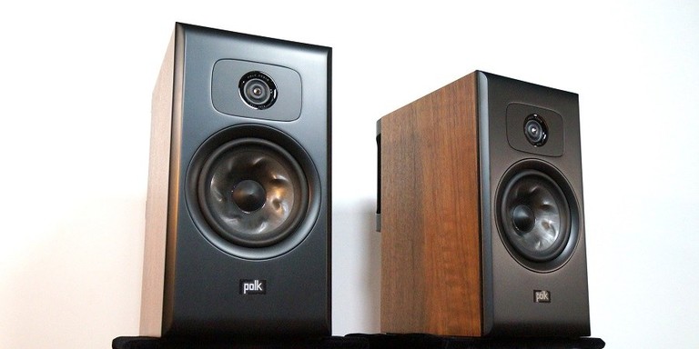

The grill off appearance isn't appealing....that woofer cone material just bothers me but then I usually leave grills on as I don't find drivers all that much for appearances....

I wonder how these new Polk bookshelf speakers would fare against their previous LSiM series in controlled listening tests.
The new ones appear to have a more expensive tweeter. But the speaker is now a two-way instead of a three-way (the new one's more expensive tweeter probably allows a lower crossover point which then allows removal of the midrange driver).
The cabinet is now more rectangular, which *may* mean it's less expensive to build.
The new woofer appears to have a stamped steel basket instead of a cast aluminum basket, which *may* mean that it too is less expensive to build.
And finally, with it being a two-way instead of a three-way, it might be that the crossover is now less expensive too.
So what we *might* be looking at is a speaker that lists $300 more than its predecessor but costs less to build. Admittedly, this is based on A LOT of conjecture on my part and may or may not be at all accurate.

I like the looks of the walnut cabinets, but the power ports on these look awkwardly big and bulky.
The center channel appears to be a very solid performer, albeit a bit pricey (ok, very pricey for my frugal standards).

These new speakers do not have the ridiculous impedance load of the LSiM speakers. The LSiM speakers needed an amp that was very comfortable with low impedance loads. For these Legend speakers, you don't want to run them on a super cheap amp, but they should be fine with anything better than entry level amps. The LSIM speakers were good speakers (aside from the electrical load), but these Legend speakers can do in a two-way what it took the LSiMs to do in a three-way. The Legend speakers are better speakers.
