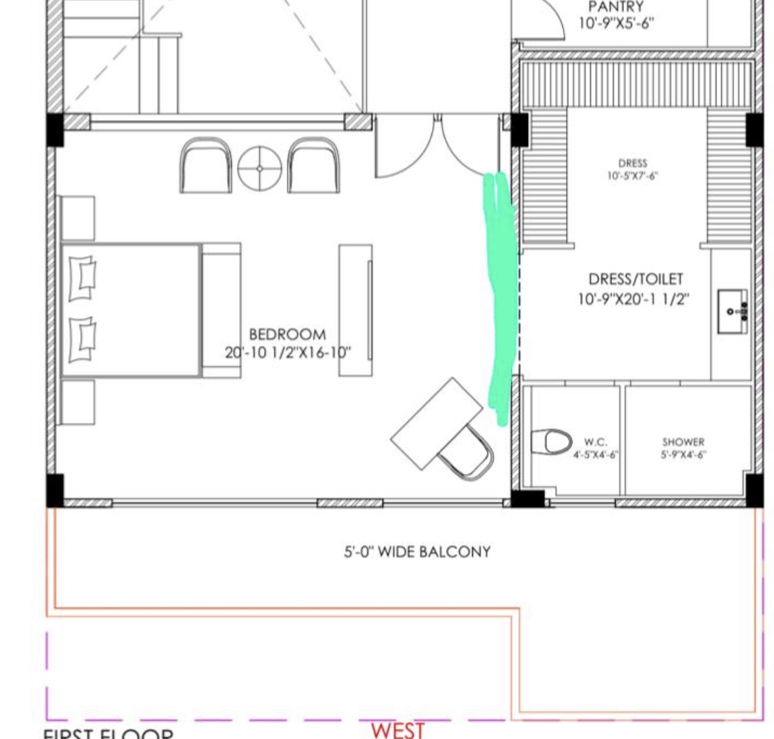

I am attaching the drawing for the master bedroom. Need 5.1/7.1 setup in this. I would be going for a Projector Screen on the front wall (Bathroom Door), marked it in the attachment. I have no space left for the center speaker which is the most important one in a surround setup.
What would be an innovative way to place my LCRs? In wall left right would be good, for center should I go for ceiling? Or is it better to go for ceiling LCRs with angled speakers? Or any other innovative solution?
Do help out!

7.x is ambitious for a bedroom FWIW, I'd do 5.x.2 personally. Can you do above/ behind the screen angled down? In ceiling wouldn't be optional. If not, LR speakers with a good off axis response used as a phantom center would be the next best option.

yes 5.1 or 5.1.2 would be better. But I have 2 walls for right and left speakers ( can do in wall with an acoustically transparent screen ) and a center in the ceiling. Or all 3 LCR in ceiling with angled baffles.
There is no wall for the center speaker. I am attaching another picture for your clarification.
do help out! Also suggest the brand options for the same!

see the walls with a center door to the washroom in the picture. Rest the layout of the drawing is different as in the picture (already attached the drawing in the main thread).

Yes you can do an inwall behind the screen, just might take some thinking to achieve the angle. You can do all inceiling and if you are laying most of the time it might be manageable. Are you located in the states?

After seeing the picture, I'd run a phantom center and either really good in wall or in room left and rights. You would want speakers that measure well off axis to create a strong center image.
Not sure about your inceiling installation options if it's a condo (not that it cant be done).

You can do option 2 and always turn the ceiling speaker off if it sounds bad.
