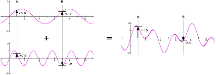

A speaker doesn't truly play a specific frequency at any one time. It simply moves in and out based on the interaction between the magnetic field created by an alternating current running through the voice coil, and the permanent magnet. When asked to play a specific song an amplifier send along a current form of the waveform.
Something like this. You can think of the X-axis as time, and the Y-axis as direction of cone excursion.
Detail is achieved simply by moving the cone in such a way as to create as close to the original waveform as possible. This is much harder than it sounds. Electromagnetism likes to give us problems. Problems like eddy currents, inductance, back EMF (back voltage; back potential difference) etc. Physics likes to give us problems such as cone breakup (resonance modes), driver resonance, etc.
With the Pioneer drivers, I'd imagine the suspension isn't very advanced/linear. I'd guess the suspension is much more stiff on one side. I'd also imagine the motor isn't very advanced/linear, resulting in high inductance, low Bl as VC leaves gap, etc. All things you see on cheaper drivers (and some expensive drivers :eek:)

In laymen terms, the Pioneers will move a bit wonky when asked to produce large amounts of excursion limiting detail, while the Illuminator will move in a very linear fashion.
*Do note there are other considerations when thinking about detail and timbre/neutrality. Usable range, harmonic distortion, on and off-axis FR, cone breakup all have factors in detail and linearity. This explanation was really focusing on linearity vs excursion as that is the major factor when asking a driver to play low vs mid frequencies.
