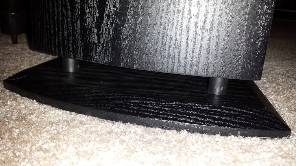

j_garcia
j_garcia
Not that I felt they needed more height, but it was so simple and only a few bucks to do. I have a few other ideas also, but this literally took minutes.
zieglj01
zieglj01

hyghwayman
hyghwayman
Looks cool, would you happen to have a part # and supplier name for the parts used?
j_garcia
j_garcia
Got the screws from Lowes, but any M6x1.00 will work. I used 50mm to fit mine, but you can vary the length of the screws based on the length of the spacers used. I already had the spacers; these are about .75" long. I don't have a part number for those and checked Lowes and they didn't have anything quite like them except some white nylon ones. I checked McMaster and found something similar that is 1" tall pn: 92825A205
